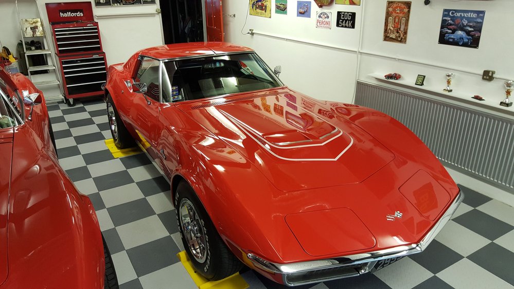

Well here's a '71 to tide you over until you hopefully get it...
