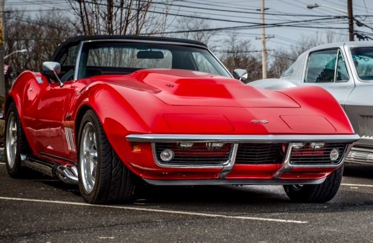

As an owner of a 69 restomod I can tell you it gets attention where ever it goes and sometimes unwanted. Although mine does not have flares or a LS motor it gets up and goes. Good luck with your search.

I've seen this one on the net, might have been an old for sale ad, before you got it. I tried to email whoever owned it to see if it was for sale but got no reply. Sure is nice!

I have owned it for almost 5 years and changed many things - coil over front suspension, dual mont rear suspension, QA1 shocks, custom Chris Straub cam, tilt steering, wheels, C6 seats. etc. The car is not perfect but alot of fun. PM me if ypu want more info, pix and video

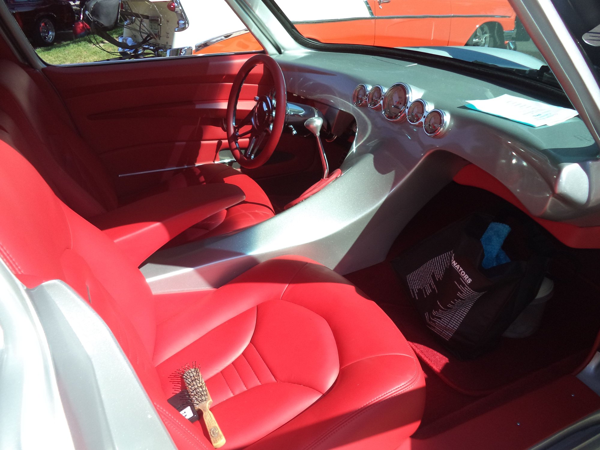

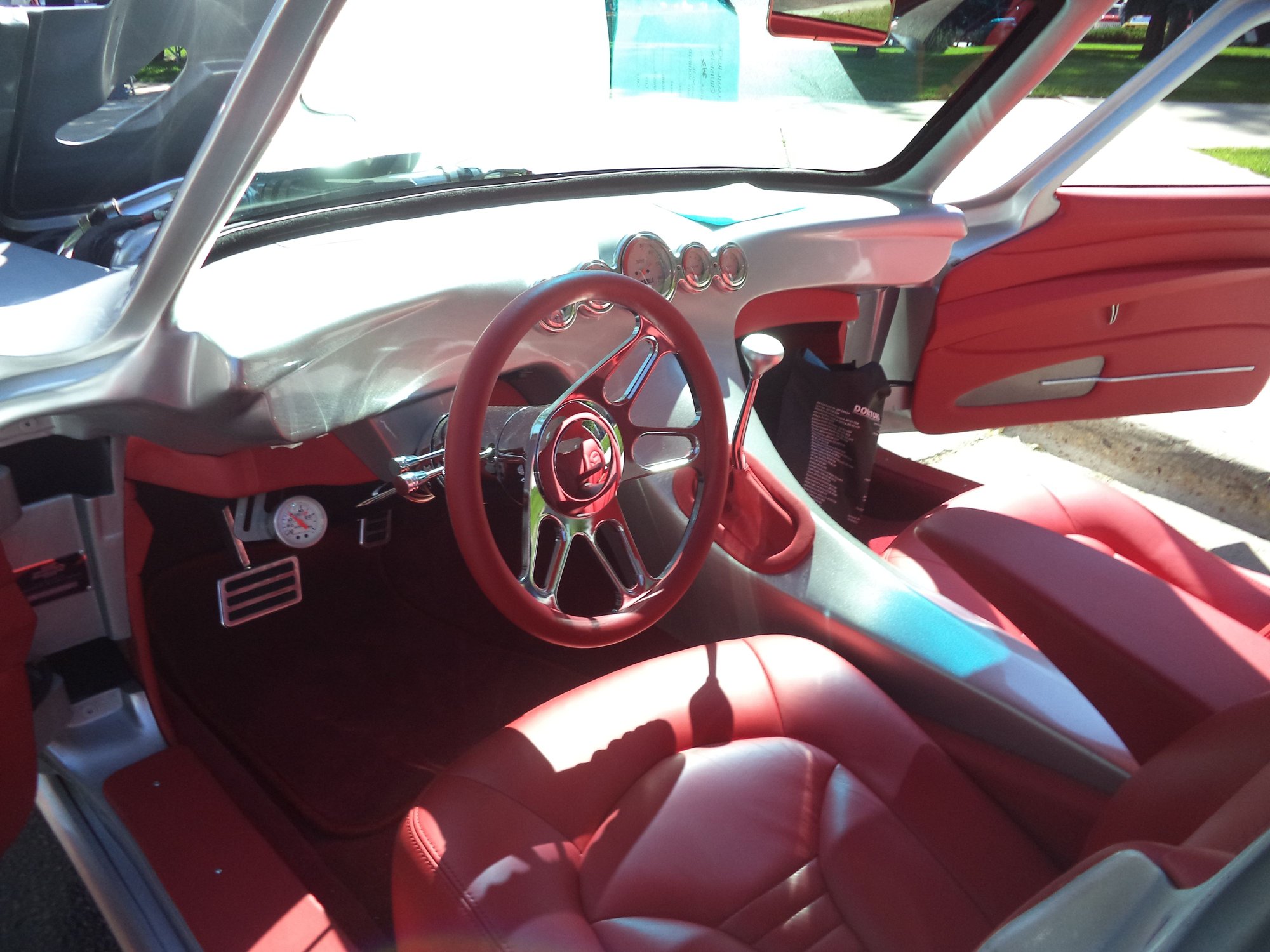

That's what got my attention....custom dash/interior. Totally different and nobody else has one. The interior on my old 67 restomod was 10k to build, just for the leather, not the dash. My opinion, he has double that in this car. I like cars that nobody else has...hence my 67 GT500 restomod with a super charged 5.4 engine.

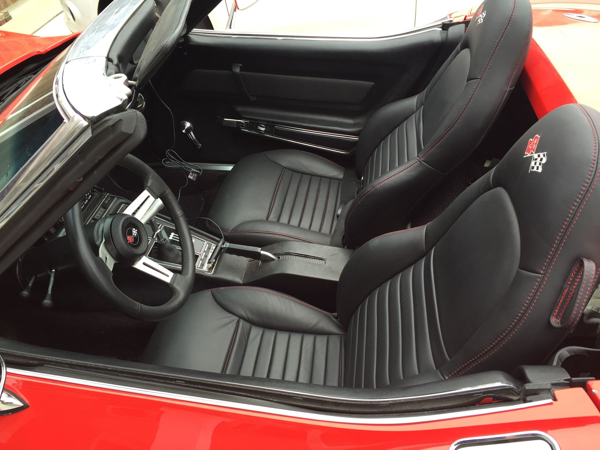

Nice ride, can you post pictures of interior, I'd like to see the C6 seats. Hows the headroom (I'm 5"11), I'd like to upgrade my 68 seats.

I could not use the c3 tracks, it sat too high. Made my own
Brackets. No slide adjustment, you should
Have have pleanty of head room at 5'11. It does
move you closer to the wheel as it is
more padded on the seat back.
