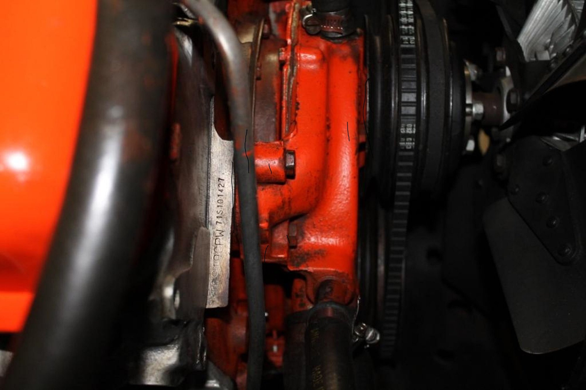

Attached is a photo of the engine stamping that appears to have been re-stamped after the block was decked.
Below are the numbers that Bobbie listed in his notes:
Block 3963512
Heads 3946074
Intake 3963569
Transmission 3978764
Tag on Trans 931710wy
Bell Housing 3899621
Rear End CAX2770
Carburetor 3986195
Distributer 1112076
Alternator 1100543
Paint Code 973
Trim Code 400
Starter 1180400
Alternator 1100543
The car still has the electronic ignition box under the left front of the car.
Restamped. How will this affect value or authenticity?
Thanks,
VG
Old Aug 1, 2017 | 01:12 PM
Hammerhead Fred's Avatar
Hammerhead Fred
Joined: Mar 2005
Posts: 2,095
Likes: 299
From: Midlothian VA
That restamp won't fool anyone due to the VERY early production of that VIN. That car came off the line sometime in Sept 1970.
No LS6 cars were produced that early in the 71 production run.
Old Aug 1, 2017 | 01:31 PM
Alan 71's Avatar
Alan 71
Joined: Sep 2006
Posts: 31,274
Likes: 4,366
From: Westminster Maryland
Hi,
The pad appears to have an assembly stamp of 0919 (September 19, 1970). That date agrees nicely with the vin sequence of 1427… the first week in October 1970.
QUITE an early LS-6 as HF points out!!!!
The swirl marks on the pad's surface indicate a grind out at some point or a block that's been decked since it left St.Louis?
Not really surprising that there's NO documentation with the car.
The parts on the engine might prove to be interesting $… (the carb for example), but do they actually affect what the car is or was at this point?

Whatever it used to be, or is claimed to be now...all the previous owners valued it so little that they chose to throw away all the documentation and deck the block and restamp it CPW. Does that make any sense to you? Why is it that only the supposedly super rare and valuable cars have such wild and hard to believe stories? If you buy a car with only a story...do you honestly think that you will be able to add more credibility to that story? How? As Alan said...value it as a '71 NOM BB coupe because that is exactly what it is. If that is what you want, then pay for the condition and nothing else.

The earliest documented LS6 is number 10931. For whatever reason, GM did not start building them until March 1, 1971. Anything before that is either a clone or bogus, whichever term you prefer. I forgot: also a "Tribute car". ��
