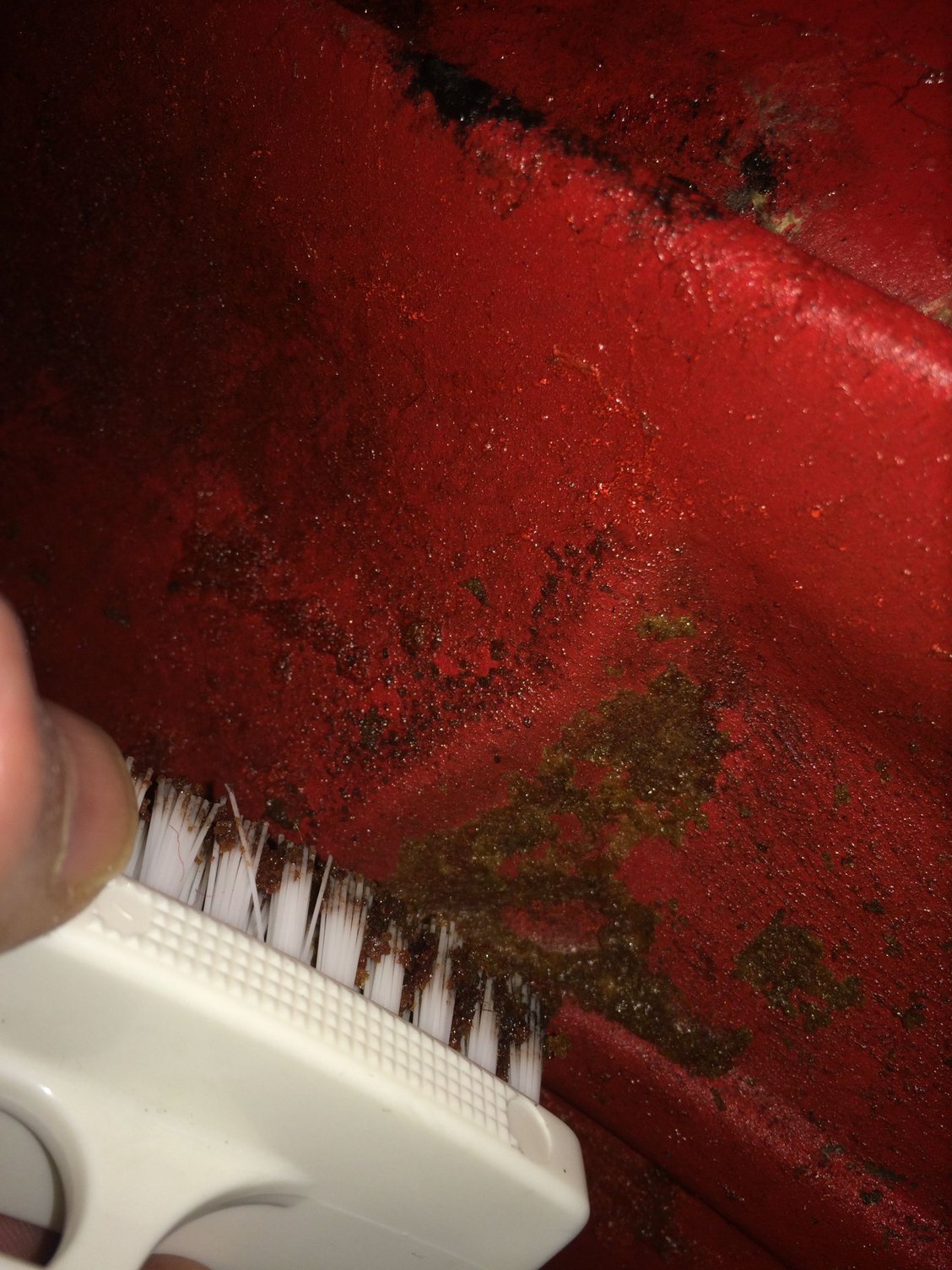

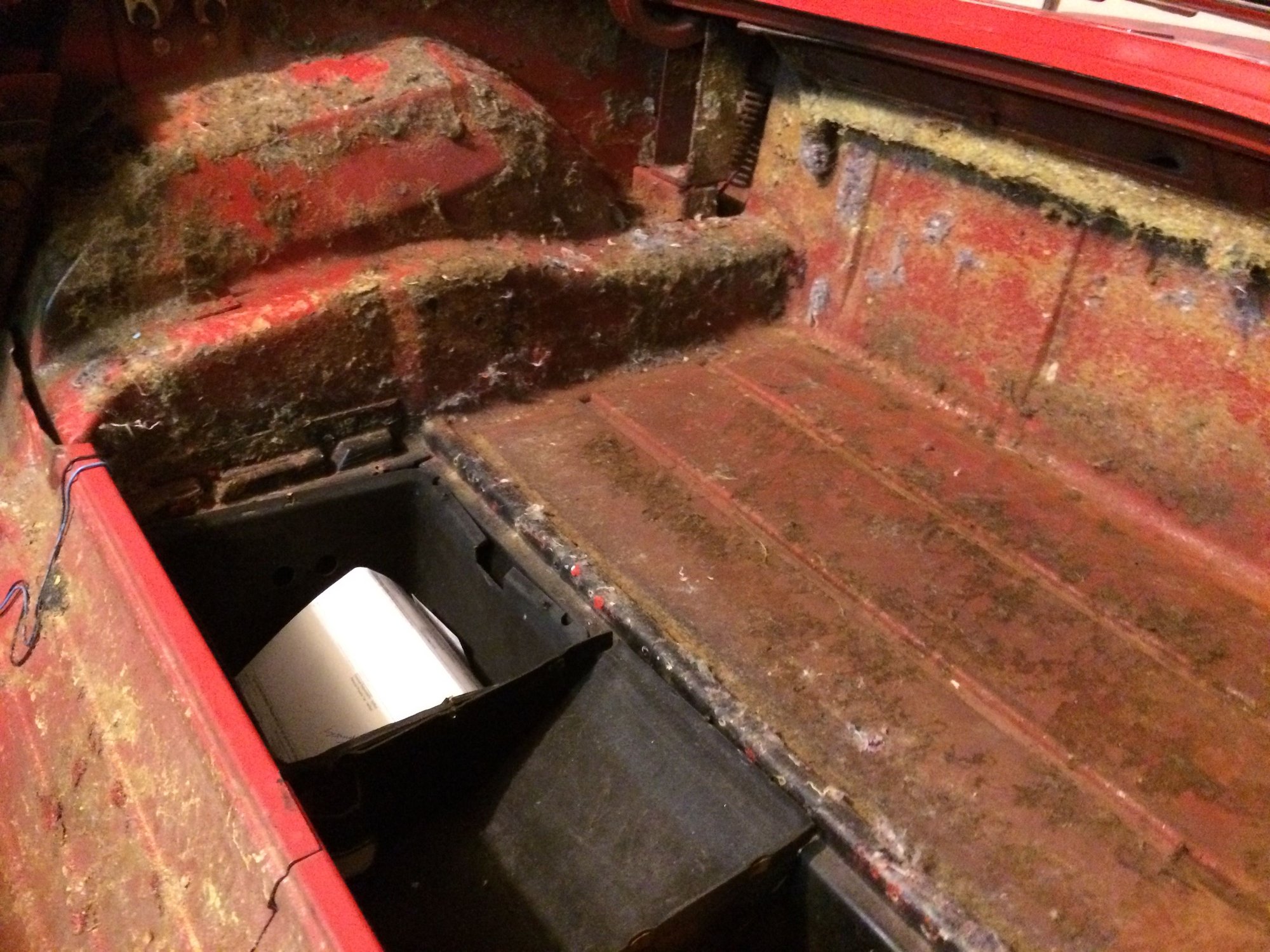

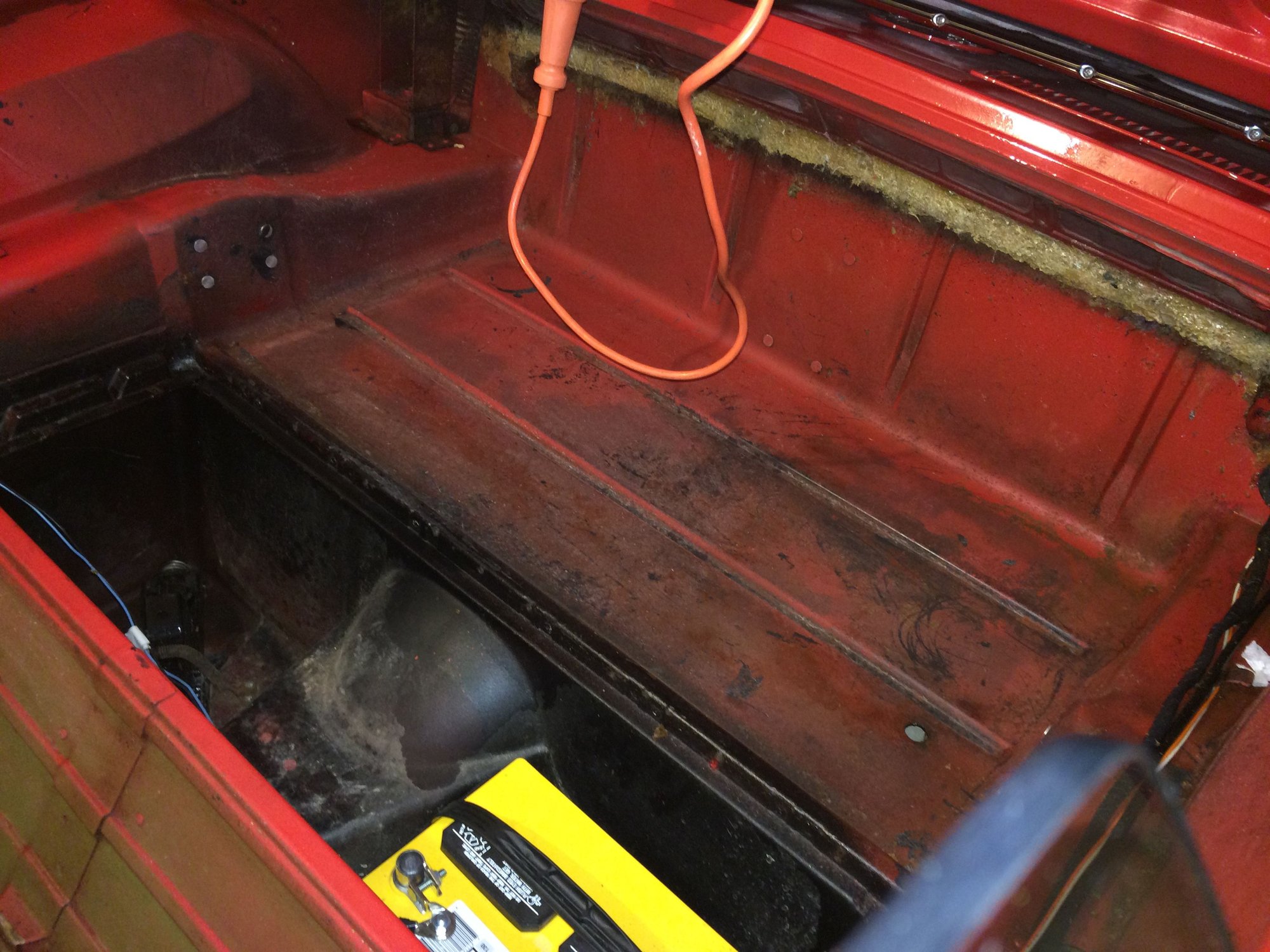

A few pics:
Mastic before removal
After removal. I eventually just HAD to get the stuff off the Astroventilation band at the back, too.
In this pic you can see how the mastic turns into a glutinous gel. I used a vacuum to remove the 'gel' after scrapping loose and piling it up.
