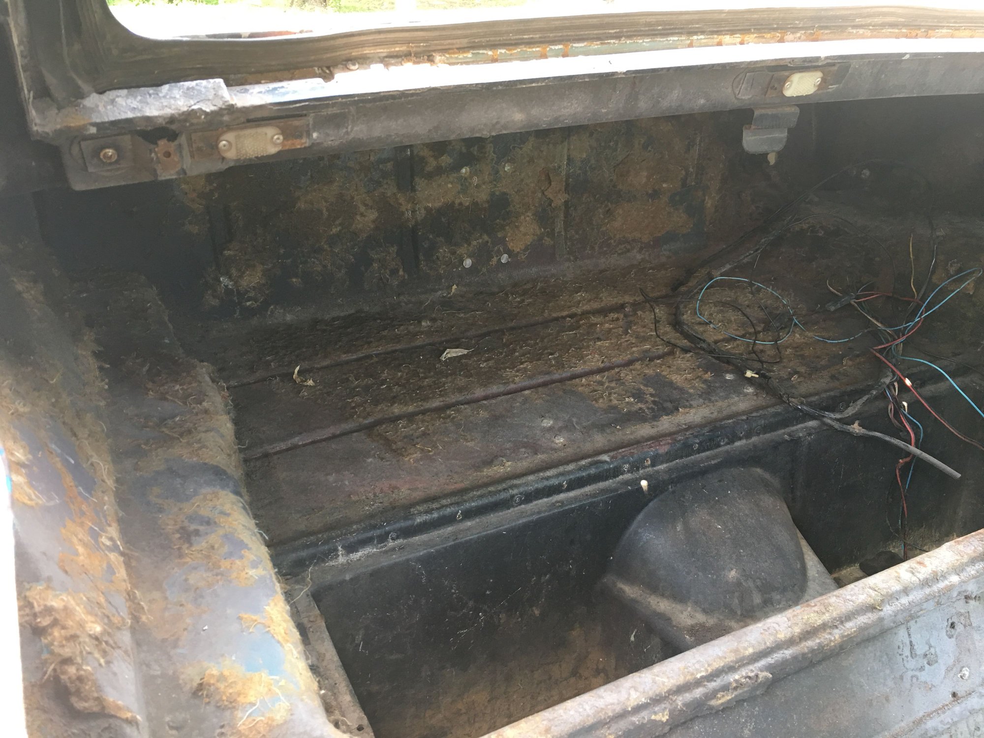

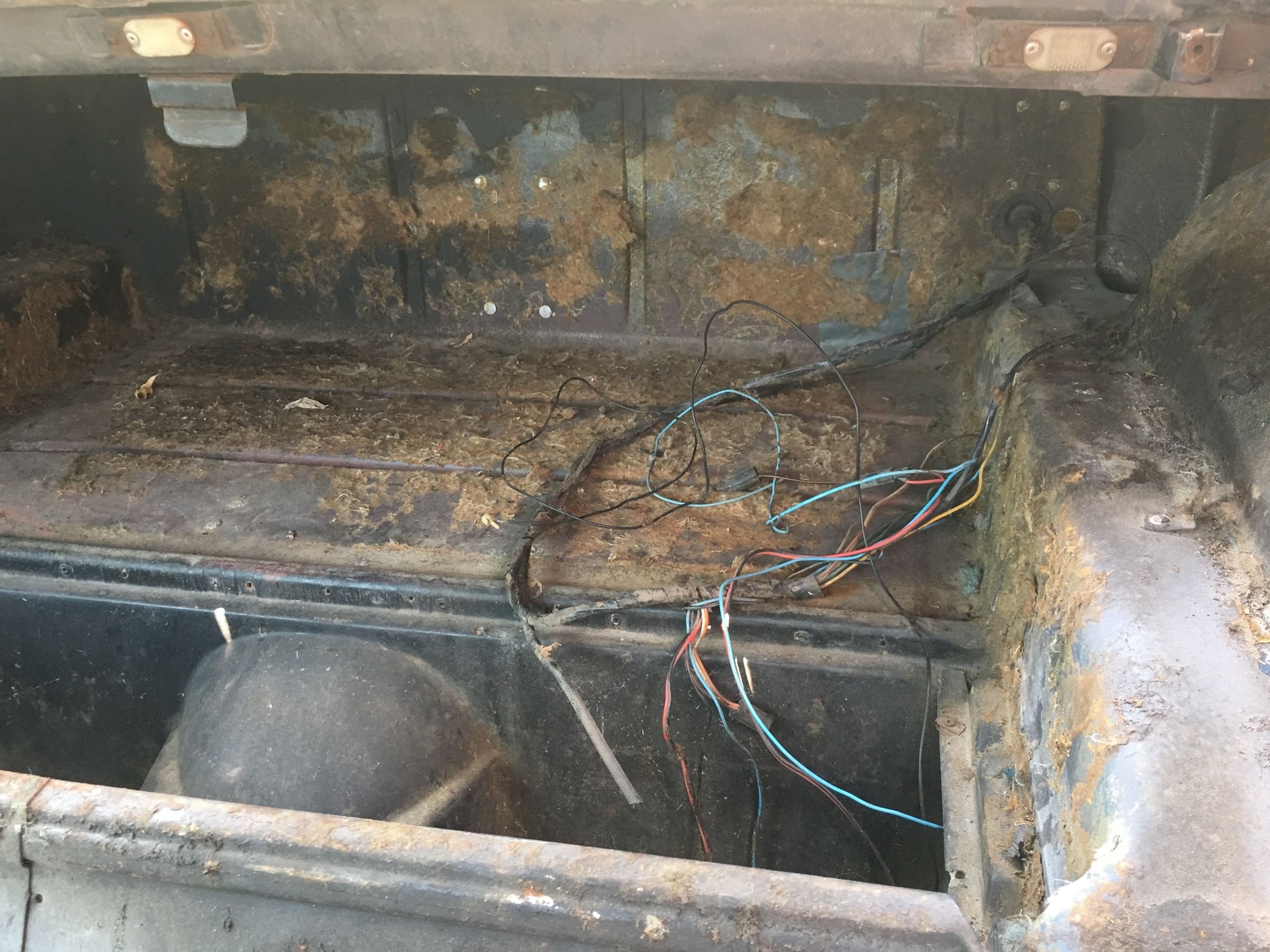

what is the best way to remove all this gunk and leftover carpeting without damaging anything?

I would use a sharp scraper to lop off as much of the excess as possible. Then, I would lay whatever new stuff I had on top of the leftovers. A bit of spray adhesive is all you need to keep the new stuff from slipping.....except on the vertical panels (firewall, rear of storage compartment). There you need to use the rubber plugs or other mechanical means of retaining the carpeting (et al). Glue/adhesive will NOT hold up on those panels for very long.

Hi C,
I used lacquer thinner.
I was working inside so 'enjoyed' it very much.

Lacquer thinner and a scraper. Wet with the lacquer thinner first and let it soak. I also used 3M green scrub pads. The maroon and gray ones are a coarser and were only used lightly on the toughest spots. I removed the second carpet set and the glue that was used looks much nastier than what you have.

I used a very safe citrus-based remover to remove all of the mastic from my car. I increased the mechanical effect using a small party knife followed by a brass scrub brush. No harmful odors. Light residue can't be removed with with any household cleaner. If you want me to find the brand name and post it here, please let me know.
