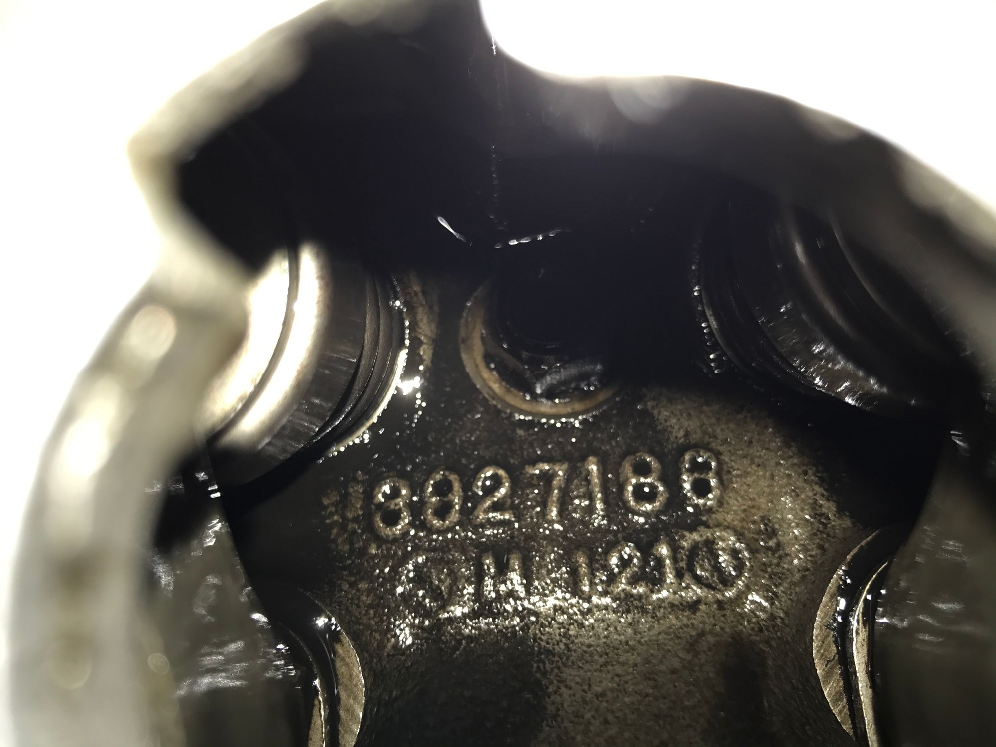

A little bored today and thought I'd throw this one out there.
I can pop the oil fill on the passenger side and see a casting # through it.Thought it was supposed to be in the center but see for yourself.
Hard to tell from the oil but it the # really is 3927186 and have seen websites that describe this as "69-70...302/350.Camel hump,64cc chambers,accessory holes"
I am wondering about the H121 date code. Looks like an M but that doesn't make sense. I think that means August 12 1971. Any site I've found 3927186 on says '69-70 - not 1971.
Any ideas? Not earth shattering just curious.

Since the engine is stamped CE, perhaps the heads are "over the counter" too, explaining the 71 date.
FYI - your oil fill should be on the drivers side.

Good catch on the valve covers - I never noticed. Thanks.
Every other casting # on this car is correct for '69. The casting # on these heads should be from '69-70. The '71 date is confusing. I found this link that has some interesting info on them:
https://www.jalopyjournal.com/forum/...asting.313262/
When I pull the covers to swap them maybe I'll get a bit more info.
Again, just curious. They're all part of the story.

It's my understanding that the letter "I" was usually not used for parts with the typical GM alpha-numeric date coding because it's too easy to confuse with the numeric "1". That would make "M" December.

That's not the original engine for that car. It's a CE engine. Those heads could be original to that engine, but not the car.

My question is: did they make 3927186 heads in 1971? From the date code the answer pretty clearly is yes but nothing I've found online agrees with that - any site that decodes that casting # says 69-70.

first result when i google says that was used thru 72
http://www.73-87.com/chevy_ids/sbheads.htm

Your casting displays an "M" code...not an "H" code.

One of my resource books says the 186 heads were used on '69-'76 trucks (light duty) with large valves.
