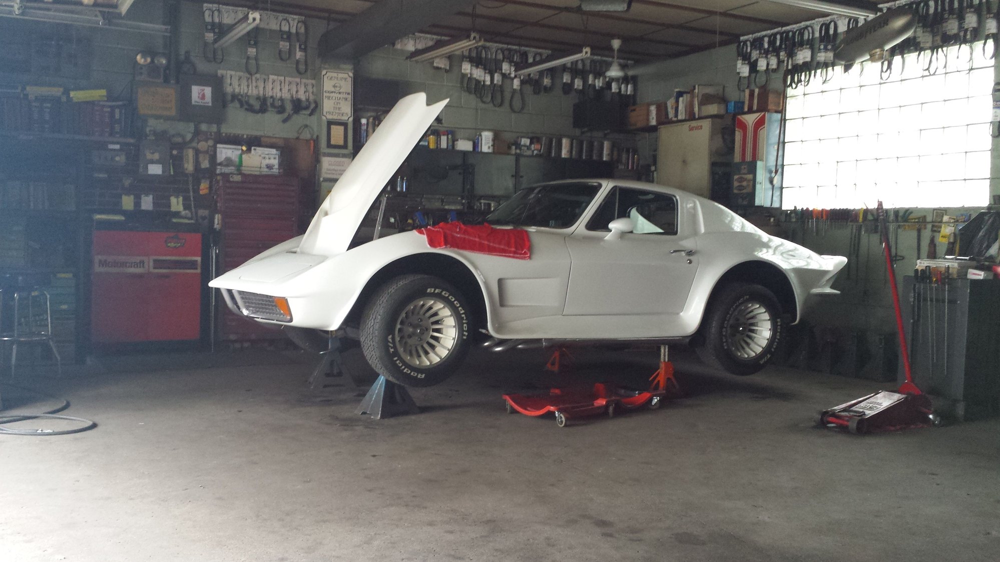

I know it is a C2 but my buddy puts mine up all the time and we work on it just like in this pic. were in and out of it all the time hasn't fell off yet.

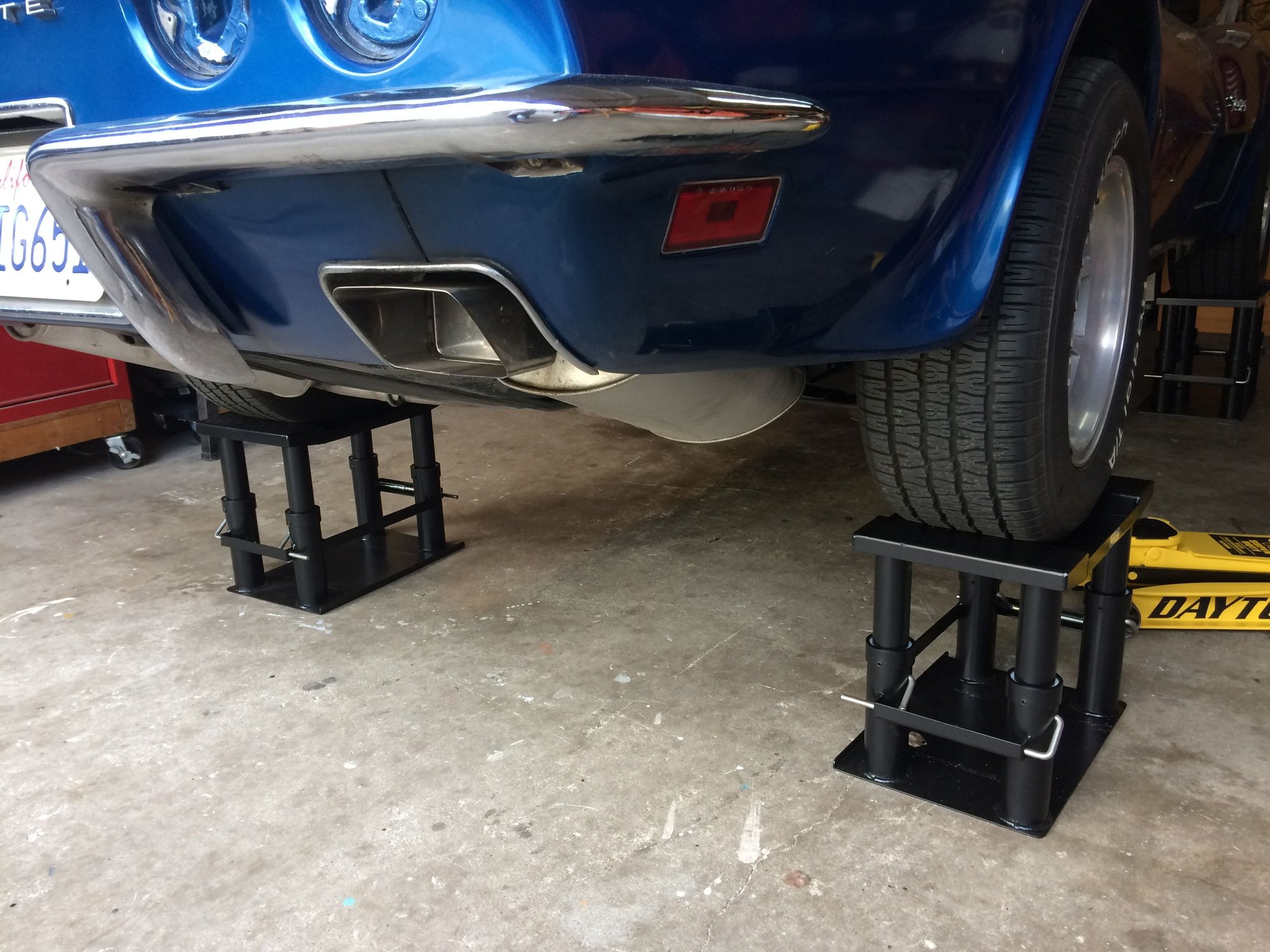

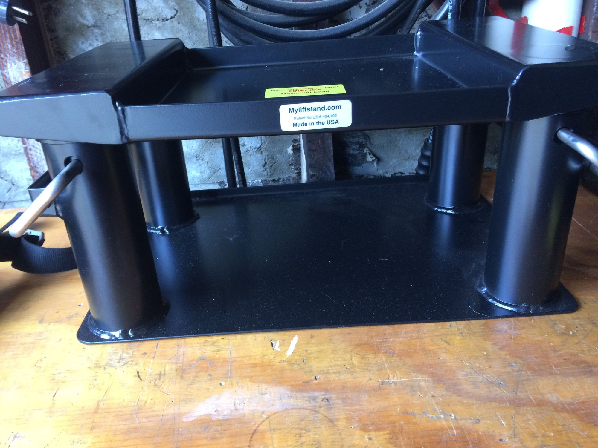

I felt extremely safe in or under my 70' as I proceeded to work on my rebuild and having been in construction most my life, you can never be to safe. Highly recommend these: Myliftstand.com/and you can use them in conjunction with jack stands also.

Caskiguy.......thanks for the info on the Myliftstands. Those look good. I'm running on a budget, and my tires are old and cracking, so I'm not sure that would work at this time, but they look great and still might be worth springing for! Thanks for the info.
