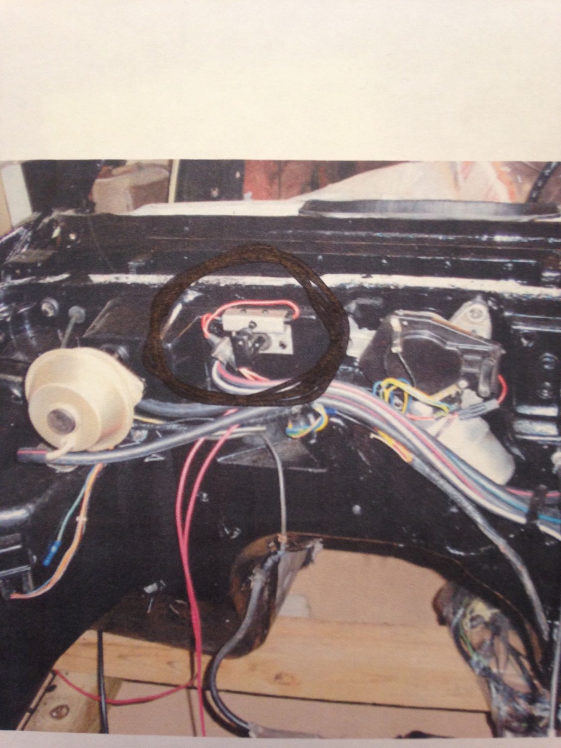

Hey guys, I have a place for this part on my 70, but it didn't come with the car when I got it. If anyone knows what it is, and where I can find it please let me know, thanks.

Wiper switch. The plunger pushes on the switch button as the wiper door opens. Wipers turn on when the button is pushed. The AIM shows the set up. If you are missing the hardware, you'll need it.

Wiper Door Limit Switch. Bracket, plunger, grommet, bolts.
The switch the photo you included happens to be installed upside down.
I'm not sure how much difference it makes… but it might in some strange way.
