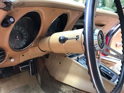

You can see the different shades in this pic. I originally purchased the dark saddle sun-visors and when they came in they did not match the originals. The seats have been re-done so I have no idea what they originally looked like. As you can see, the dash pad has a gouge in it so I'm not sure if it was replaced already but you can see the difference in shades between it and the rest of the dash as well as how dark the carpet is. Even the steering wheel and shift console appear to be a lighter shade then the dash components.

Hi SO,
You're right about there being an assortment of shades!
Before you go through the work of re-dying things I think you need to assess the various pieces condition:
Obviously the upper dash pad is quite damaged.
It appears that on the lower dash pads at least some of the mounting screws have pulled through the vinyl damaging it.
The console extension seems to be installed in an odd way. If the car is a convertible it looks like the piece that screws to the extension is missing.
It might be wise to be realistic about what you can repair and what might need to be replaced.

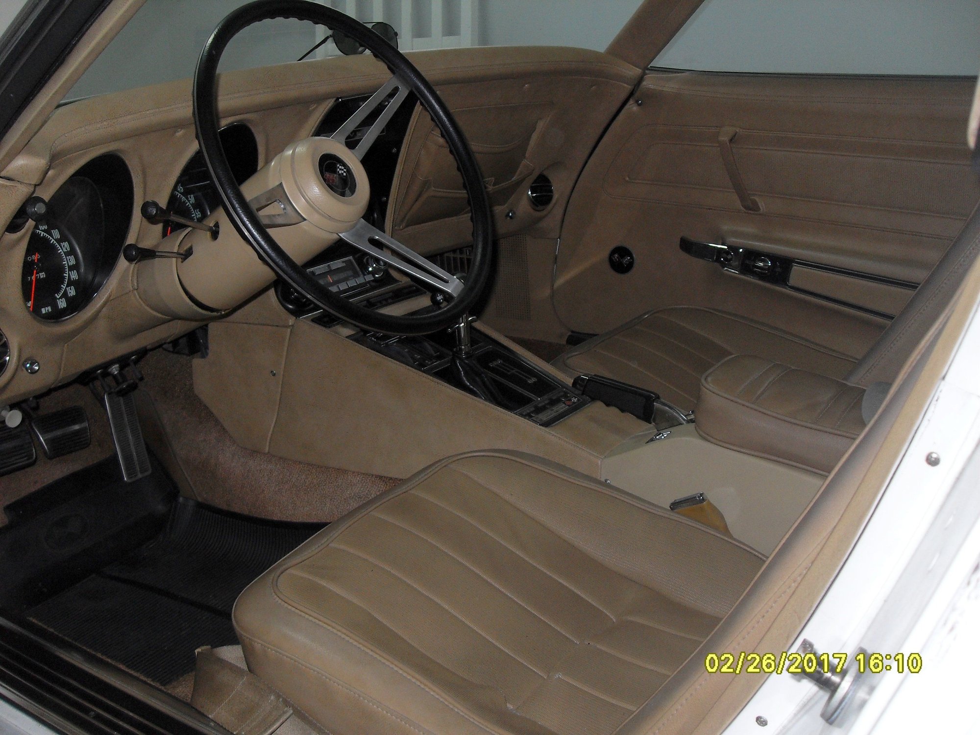

Here is a picture of my interior. It's all original except for the rear console that was repaired and painted. Difficult to find matching paint.
I don't have any of the shade differences that you are finding with yours.

Hard to really tell, but it looks to me like it your car has a 68/69 upper dash pad.

Saddle interior on both C2 & C3 is one of the hardest colors to match when you start mixing old with new and dying vice cleaning.
Case in point I have owned two Saddle interior 65's and the only way I got the interior to match was to replace both door and dash panels ($$$$) than use interior dye on all the plastic.
Looking at the picture in post #3 I would say you need to approach this as a complete interior restoration if you want a uniform color throughout. What panels do you feel need to be replaced due to damage?
On the subject of dye I have found Corvette America to be as good as any for product, BUT, have found the aerosol cans to be junk in that they spit out little globs of paint so I only use the Qt. and use a spray gun. Interesting also that the color tint was much more correct using a spray gun vice aerosol can.

Hi,
Barry's photo illustrates the 'marbled' appearance I tried to describe.

I wish it were like Barry's. Then I wouldn't be making any changes.

Mine sure does look a lot different than yours. It would appear that a few of my pieces have been replaced incorrectly.

I believe you have a cobbled-together interior, based on wide-disparate colors, incorrect fasteners, mid-year horn button, etc.

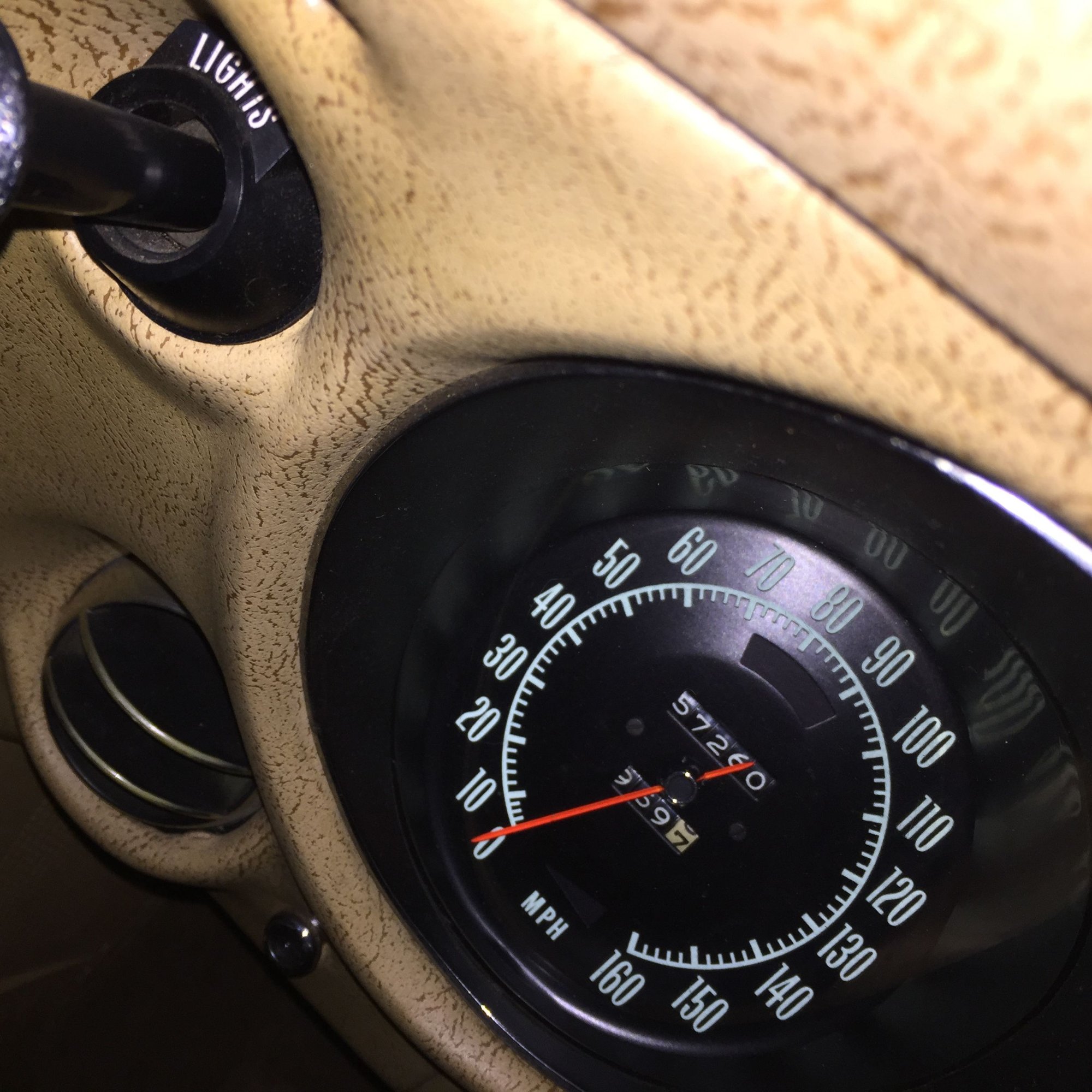

Be aware that 1970 was special. My interior is original, and is different than the reproduction ones.
This finish is on the dash pad, shift console, side pieces that cover radio, gauge and map area, but not on A-pillar, door panel, seats, parking brake cover, roof and window trim. No one is making it, and initially thought it was dirty. After attempting to clean it, it was as delivered new. There was some discussion on NCRS message board as well with one of the judging manual contributors at Bloomington Gold last year.

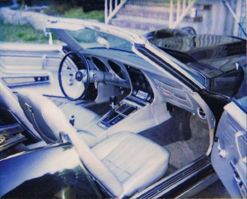

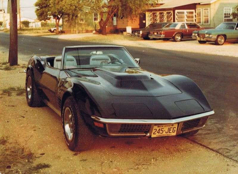

My favorite combo. Changed it back in 78 to black /silver Think those cars across the street are new
Went back to saddle in 04 The driver door panel is original unpainted. The rest was painted with dupont interior color, which is what GM use for touch up and such.. Once the different colored pieces were depleted, the parts were supplied for SERVICE in black, with instructions to "paint to match"
Had a pint for the upper dash and a quart for the rest made.
Dont think The dupont is available anymore, But venders carry elastomeric paint. SEM comes to mind. My silver was R&M.
