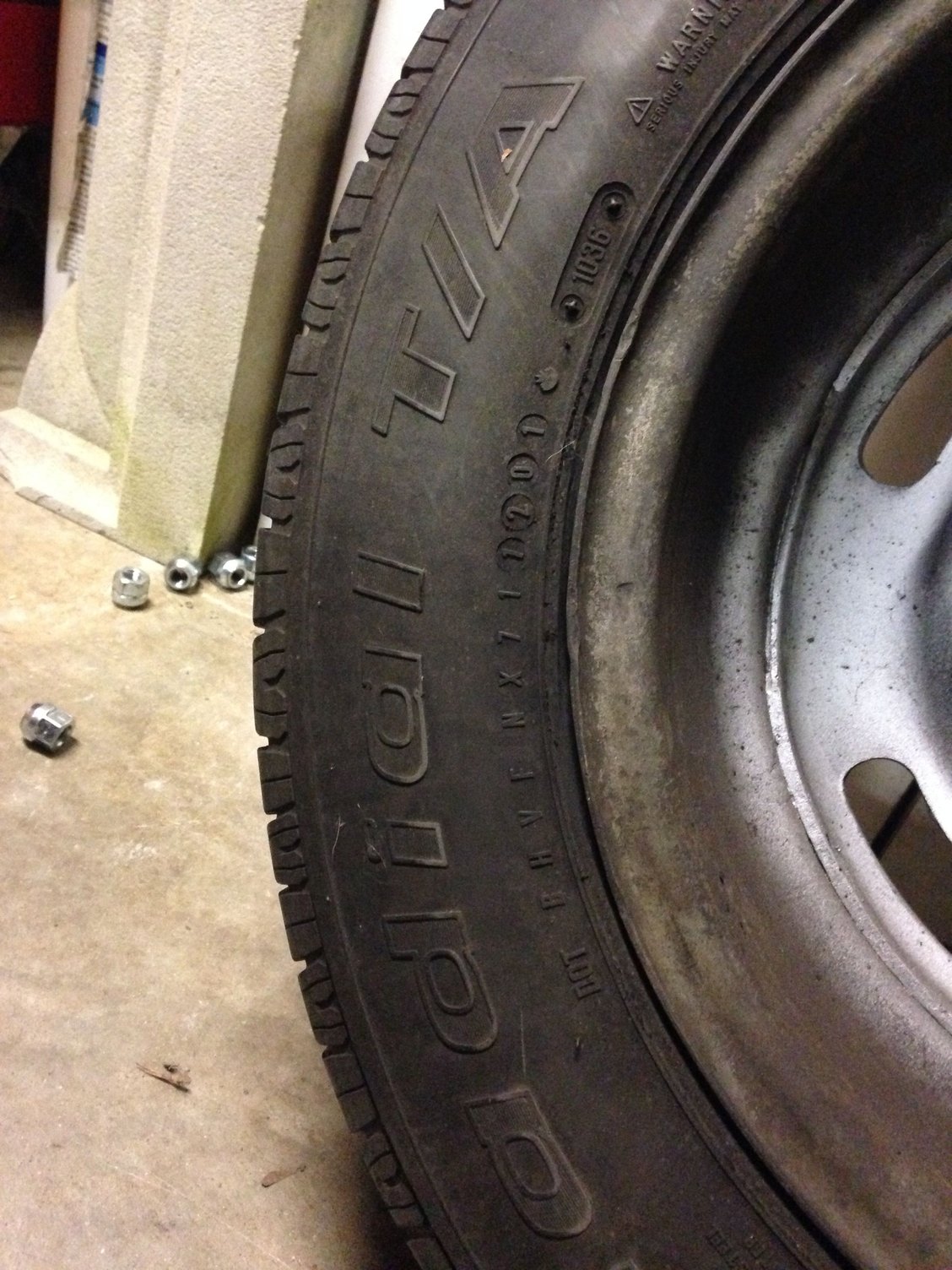

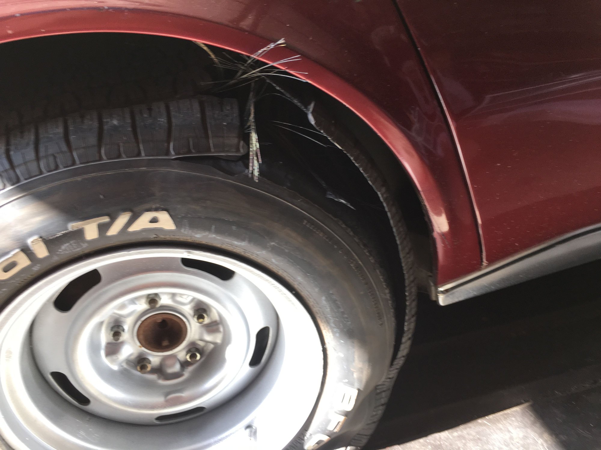

Went to a car show Saturday that was only 5 miles or so from the house....I noticed a wobble when slowing for red lights and stop signs and somewhat of a vibration as well....Trailing arms were just rebuilt so I thought something might have came loose or maybe a tire going flat....I pulled over to check and everything looked fine so we continued on to the show.....I put it back up on jackstands Sunday and didn't see anything so I pulled the tires off.....Here is what I found.
We were lucky to even make it back without having a blowout....Yes the tires are really old but up till now they looked fine and had plenty of tread left.....Just a reminder to those running older tires.

Internal belt separation. Time to replace those tires. How old are they?

ive heard old tires can blow out while just sitting on your car. When they do, the damage the car. You may want to remove all 4 and deflate them a bit till you get new tires .

I have already deflated all (4) tires.... I'll post pics of the date codes tonight.

Looks like the 12th week of 2001 was the date they were bought....

That would be about TWICE the useful life for an average tire. This really is an issue for car buffs who drive their car sparingly. Tires NEED to be exercised to keep them in good stead.
