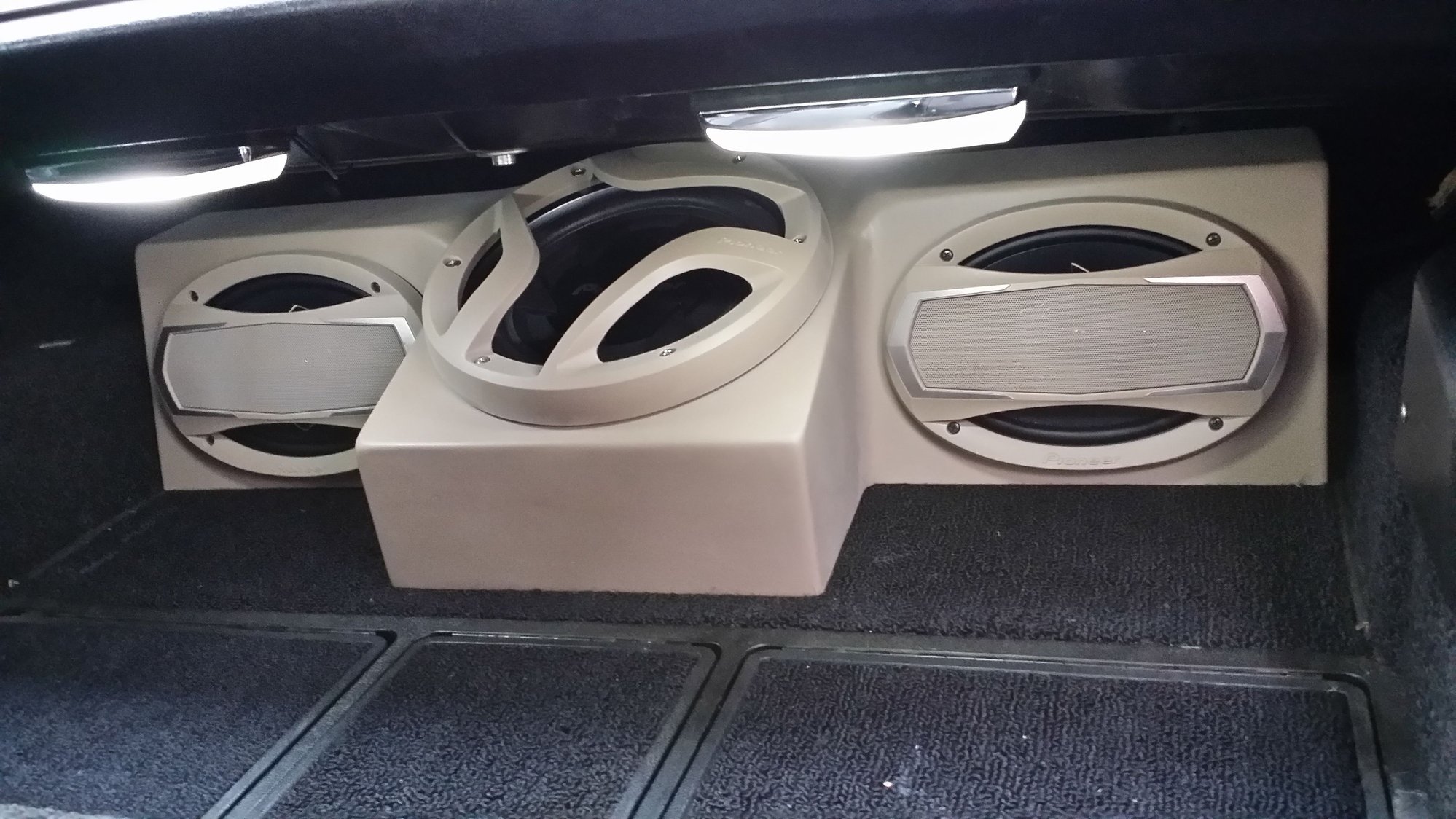

here is a pic of my speaker box in the cargo area.

That looks awesome! I'm not really looking to have a system that can be heard three blocks away, just a setup with a clean sound. I might do 6 X 9's in the rear, rather than the 6.5's. Do you recommend separate amps for the front and rear components, or do you think I'll be better off running the front speakers straight out of the head unit, and the rear speakers/sub through an amp connected to the RCA ports?

My fronts (6 1/2 and 4x6) are on one amp, the 6x9's and sub are on a second. That way the filters can be set (don't need low frequencies going to the front, or high going to the back)

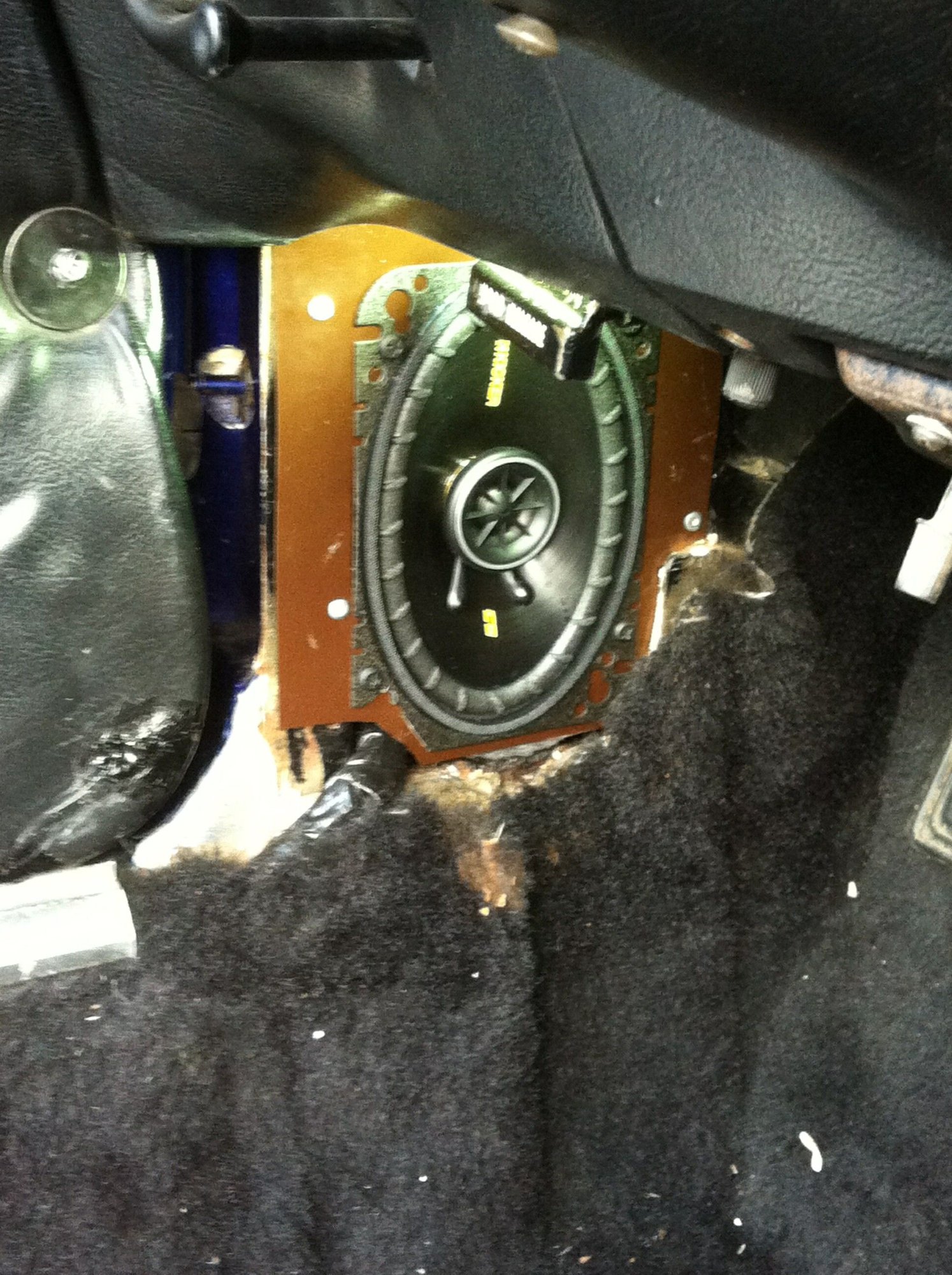

Here are some pics of my install. For the most part you can see NOTHING while standing beside the car.
Front kick plates, before putting the plate back on:
