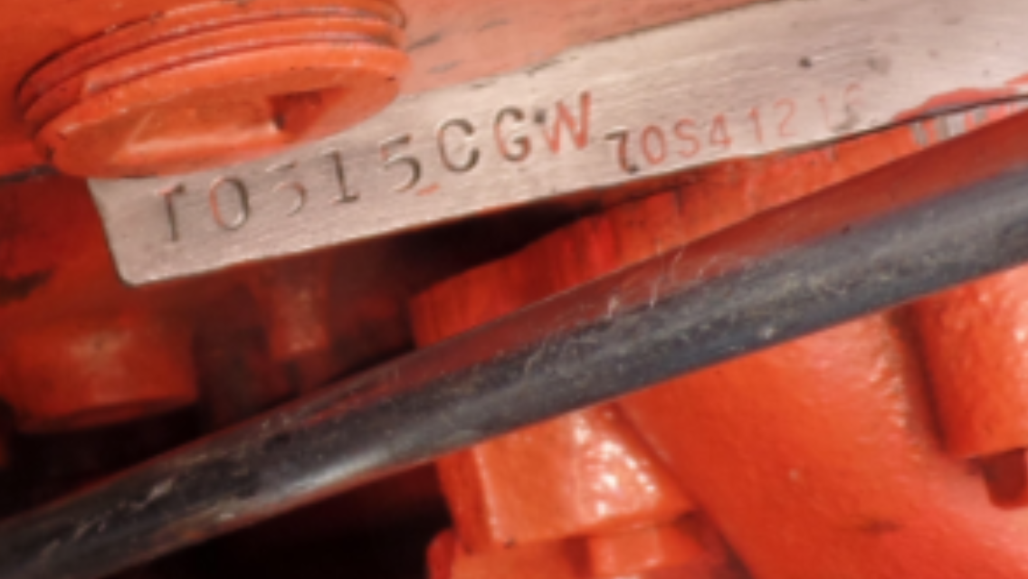

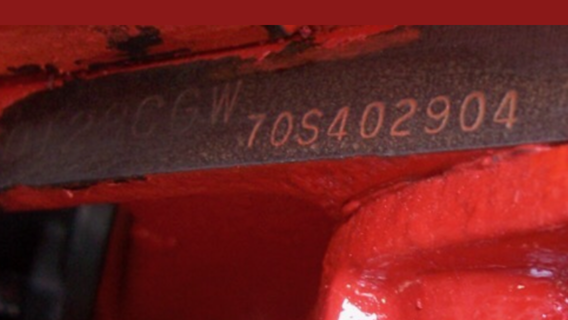

I'm no expert, but it looks like a re-stamp compared to Alan's pictures.
Old Aug 30, 2017 | 09:23 PM
7T1vette's Avatar
7T1vette
Posts: 37,637
Likes: 3,118
From: Crossville TN
These impressions were made with a "gang" stamp...all of the individual digits clamped in a holder and set/hammered with one blow.
The same gang stamp was used on the transmission and on the frame to tie all components together. You can look at the other stamps on your car to see if they look the same or somewhat different.
It is very possible that the original engine was rebuilt and then re-stamped with the correct information. It is also possible that a different block was reconditioned and the info pad re-stamped with the numbers that came on the other engine. The circular (mill) marks that Alan71 mentioned would lead us to believe that the engine was re-stamped: but we can't determine if the block you now have is the one that originally came with the car or not.
If the trans / frame stamps with car S/N look identical to the stamping on the engine, that would certainly raise a question as to whether the block was re-stamped. If you can also get a pic of either of those stamps and post it, that would be very 'telling'.
P.S. The reason for the stamping being 'deep' on one end and 'shallow' on the other is that the person doing that job did not have the gang stamp letters all in contact with the metal surface when the gang was struck. It was a bit cocked before being struck.

The engine suffix stamp looks very deep.

thelal1, is this a 70 LS5 you own or looking to buy? Any other pics you can post would help.

The engine date/build code looks strange to my eye, a bit like the characters were stamped individually. With the speculation on the last digit of the VIN, uncertainty, I'd say this will raise a lot of flags with future buyers. IMO it will hurt the value, not likely to get full credit for being original. It may fetch more than an acknowledged NOM.

I agree. I have a lot of LS5 engine stamp pics on my iPad that I save as I come across them and this one falls into the restamp pics I have.

That looks fake to me ...those 5 s are funky and the W ....and its not very uniform depth and spacing either . Im giving it the big " GONG " ��
the iron has lost the broach lines .
i was looking a t 454 blocks far back as 1978 trying to find original cars . They are few and far between , most had counter replacements warrenty or 402 / 396 engines replacing the 454 originals . i look at a chit load back then .....kinda like 302 Z28 s .....alot
missing the born with engines.

it is still a stamp pad with an excuse, and will not get all possible points in a judging.
therefor you will take a hit at selling time when compared to a no excuses stamp.
the no excuses cars with the correct stamps , date casting codes, part numbers, doc, provenance, are the ones that go for the bigger bucks.
as stated by several, check other parts for stampings, and determine the casting date of the block by looking back behind the distributor. the tranny stamp comparison and the block casting date are very important in validating your stamp. publish those pics if you can for the experts on this site to see.
It was documented by the shop that did a complete overhaul of the block, that they did deck the block. When they were done with all the machine work they put the Engine code on the sheet, then they put the vin code but left off the last digit. This was done in 1994.
Car also has a tank sticker with car. One of the things that concerns me also, is the mileage at 99,000.
Transmission has the id tag on it.

Looking to buy. The engine rebuild sheets from 1994, 4 pages, show that they did deck the block, When they were finished they put the engine code and then the Vin # but the last digit was gone, on the work order.
Another thing is the mileage. Nice looking car, Asking $24,500.
In 1994 the engine was completely remachined and in the 4 pages on the work order, they decked the block. could that be why on the left side the letters are shallow?
All those numbers, the heads,intake,block all fall into buid date on car.

The current surface of the pad is not the result of the block being decked during rebuilding. Decking leaves a uniform, but not typical of production, surface.
The current surface of the pad is the result of a GRINDER being used to remove pad material in the area of the original engine assembly stamp.
What this has done to the value of the car is for the buyer to decide.

Originally Posted by jr9170
Here one for u to compare
Do you think that having machine work done to engine, decking, or sanding could have done that. The owner said he has checked block, intake and haed numbers that match build date assembly.

It looks like a nice car IN THE PHOTOS.
It's really a shame what was done to the pad when the engine was rebuilt.
Perhaps the asking price is a reflection of what the car actually is.

new suspension, rebuilt engine, nice paint.. easily a 24K car if no rust...
rare to see a 70 big block that low a asking price. it would be sold by now if not other issues?
99K miles equates to 2100 miles a year. don't let that scare you away.
if you can't authenticate originality, then base your price that you will pay on the condition. of the car.
if your requirements are based on originality, then do your homework before you commit to playing that game.
many a rookie gets burned when playing the matching numbers game.
