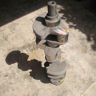

So just a couple of updates
Engine came apart last week unfortunately it appears the motor had previously spun a rod and the crank was swapped out to a cast truck unit.
I just picked this up to replace it.

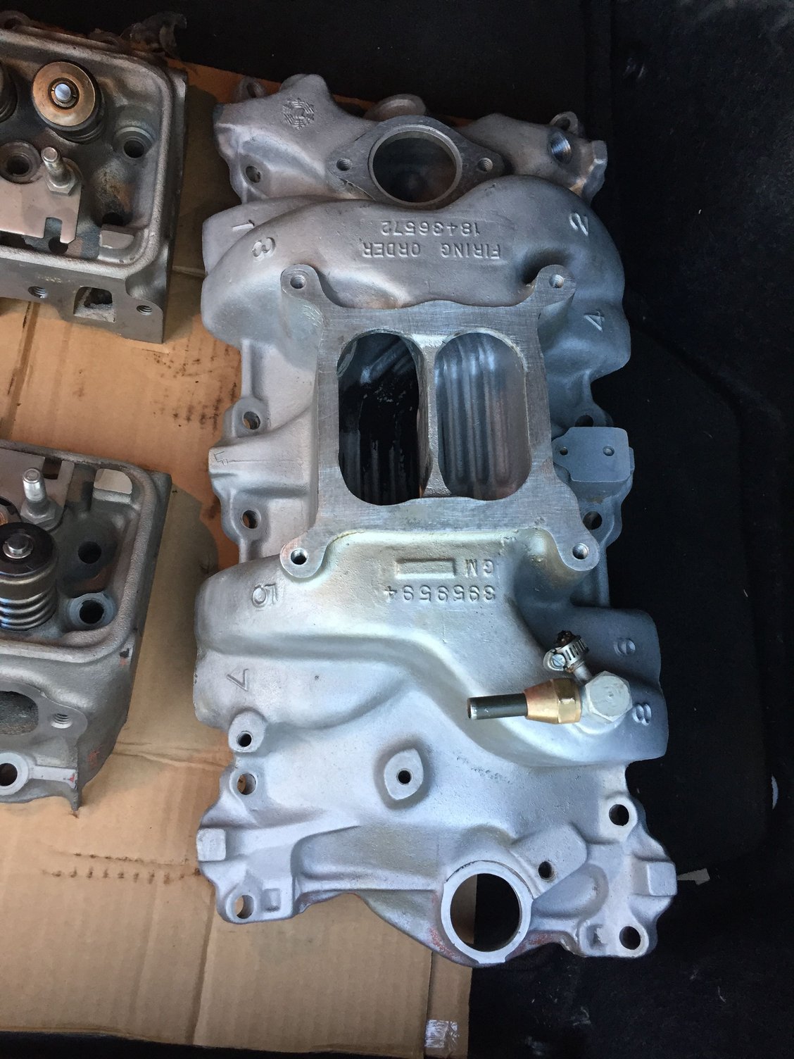

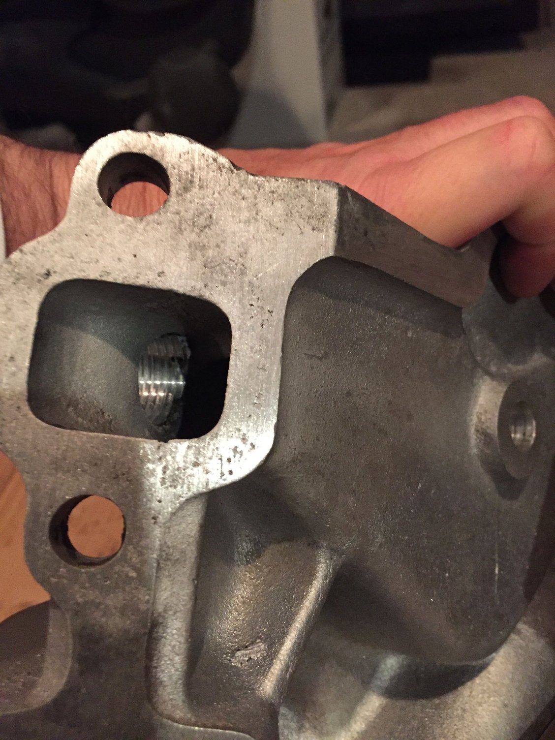

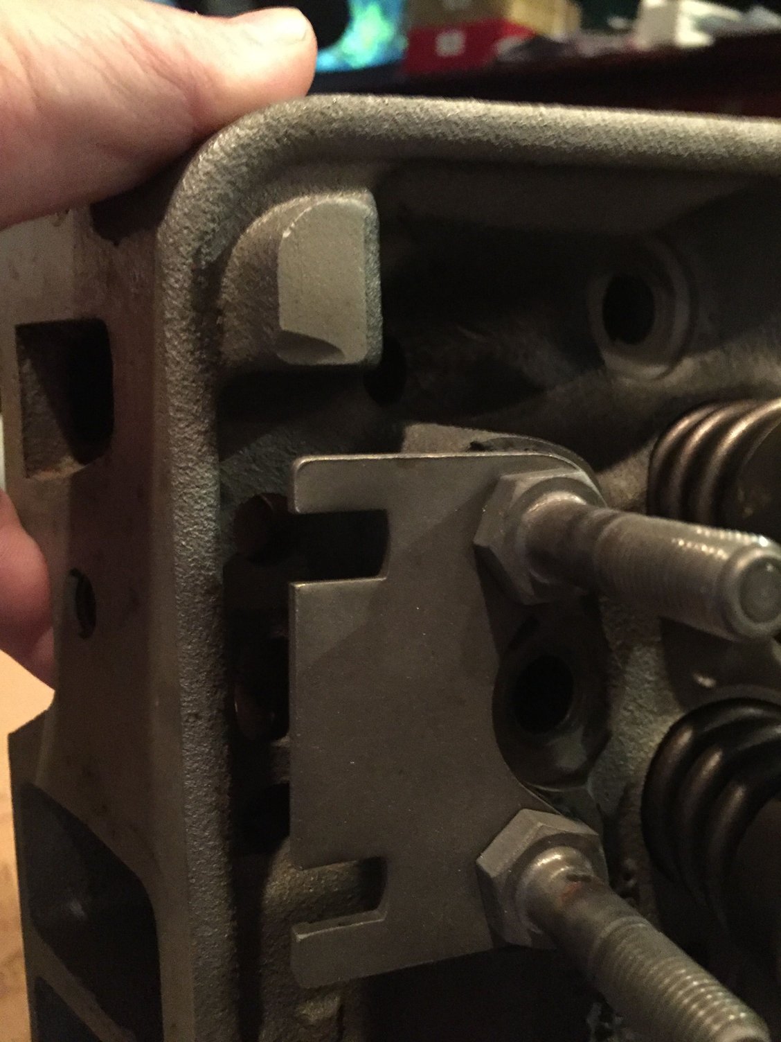

I picked up the heads and intake that needed repair. The water jacket where the heater hose was broken, welded improperly then jb welded to attempt sealing. I was really concerned it would not look right but Lorenzo's fast flow did a fantastic job on the repair and the heads look great.
Here are some photos

Here is the intake repair Lorenzo's did
