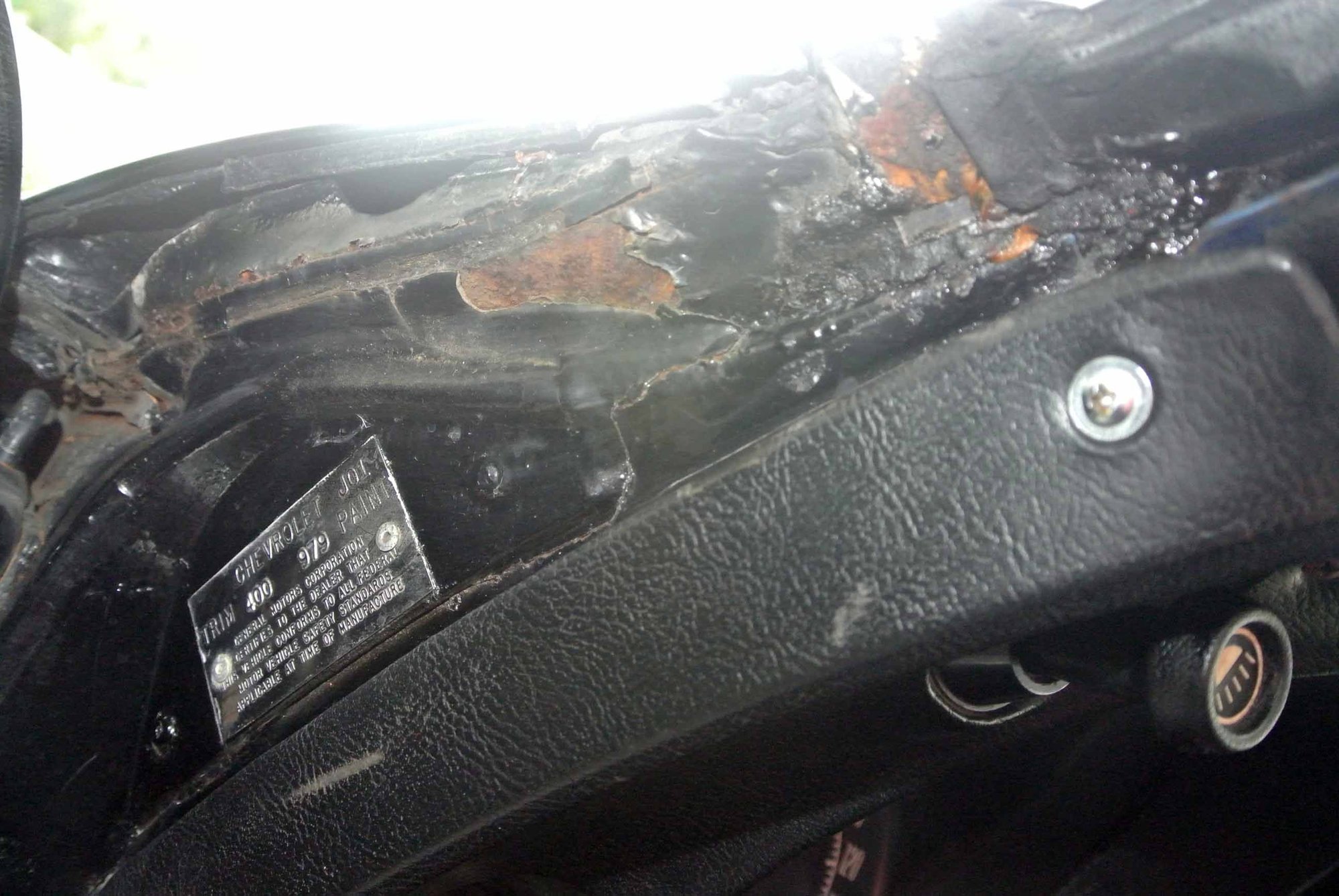

When to walk away from a purchase?

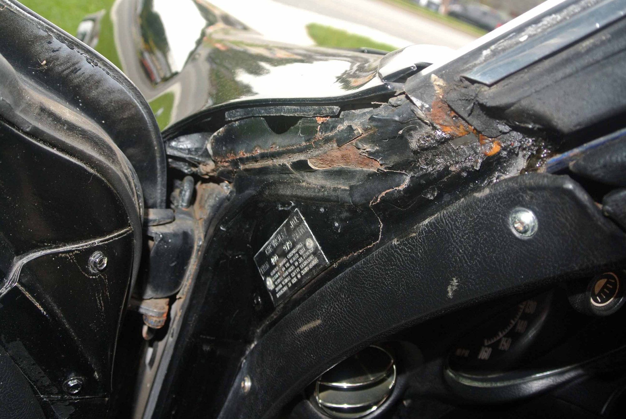

I'm looking at a vette that apparently has some rust on the drivers side, which you see when you open the door, and right above the plate with paint codes.

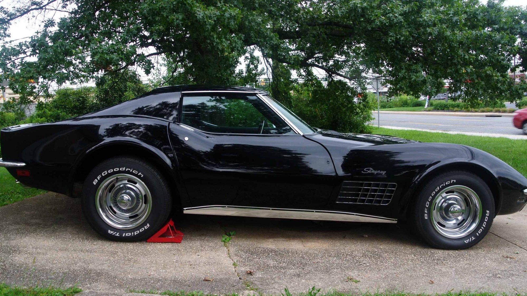

2nd issue, is that on passenger door does not align nicely. Far from it.

Does this indicate serious bird cage rust...
Should I stay or should I go

When you zoom in, the misalignment is very clear. But even on this pic it is noticeable. Can it be fixed easily....
Then there is the misalignment of the passenger door...

Wonder if this is damage is from a previous accident? I would walk myself.

looks like it has been in salt water. I would run not walk !!!!!

If the body mounts are rusted, or they wont let you remove the kick panels I'd walk away.

When considering buying a 68-72 car the concern about rust in the birdcage (especially in the windshield frame, hinge pillar, and lock pillar) and in the frame (especially in the area of the frame 'kick-up' just forward of the rear wheels, and in the main frame rails forward of the kick-up), should be a PRIMARY concern.
There is enough rust showing in the hinge pillar/windshield post photos you posted that I would be concerned about rust in other areas of the car. Before even beginning to consider buying this car I'd want to see the condition of the lower hinge pillars with the interior kick panels off, and the condition of the lower lock pillars by looking through the small access panels in the forward area of the rear wheel wells.
The variation in the gaps of the right side door to the fender and rear quarter could be caused by serious body problems or just by a poor job of mounting the door… it's impossible to know from just one photo.
I'd want to know how much experience with 68-72 cars the person doing the inspection has before deciding how much faith I'd have in the details of the report.
There is no reason to knowingly get involved in a rusty 68-72 car.
A badly rusted 68-72 can quickly break your spirit and empty your wallet.
Even a 'somewhat' rusty 68-72 should be avoided.

This one looks rough from what we can see. My guess would be the door issue is due to rotted body mounts. Is the OP willing to tell us the asking price.?

Thanks for the feed back. I walked away.
Instead I bought a 1972 with a solid frame and birdcage instead.
To my believe the seller was not aware of significant importance of this type of rust.
As per one comment, there is also a price for rusty corvette's; yes, for the right buyer, who can do the work.
Asking price was 15k. Inspection valued it at up to 13k.
To me rust to the birdcage is not an option.
