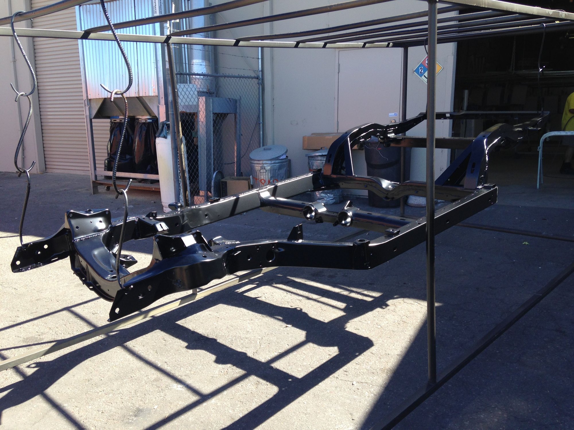

A frame that was stripped by hand, powder coated, sanded, and painted.

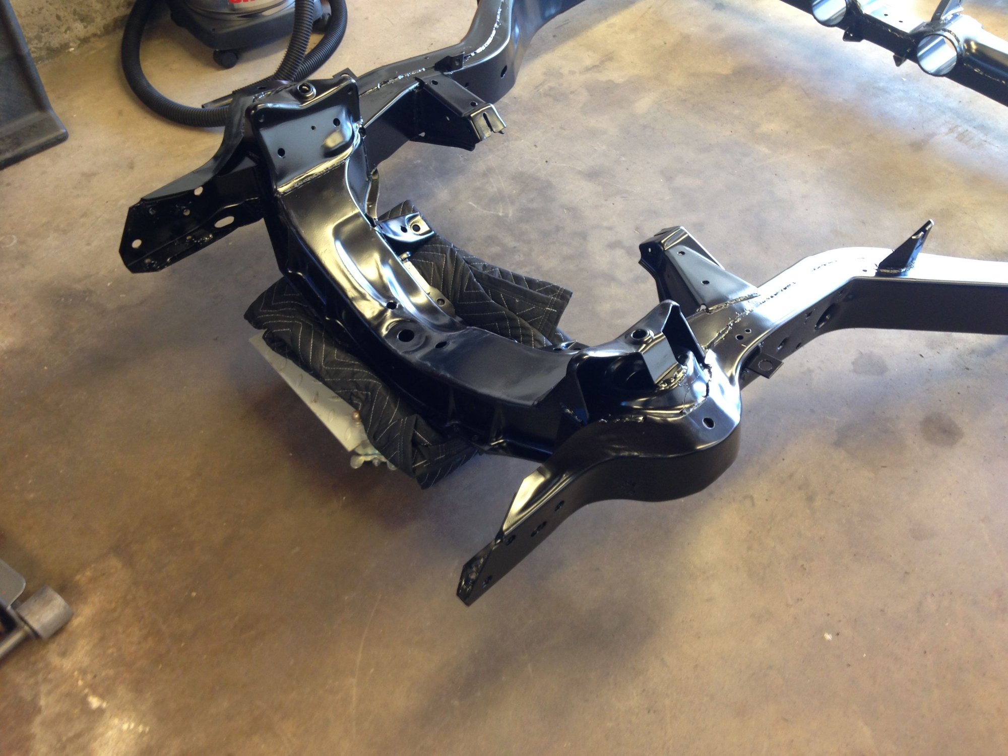

This is the 69 frame I recently restored. Sorry for the dust on the frame.
Name:  IMG_20170731_141040071 (1024x576).jpg
As a manual frame it had a fixed cross member for the transmission. This modification makes it removable making installation and removal of the transmission much easier at a later date.
Name:  IMG_20170731_141104021 (576x1024).jpg
Front view of the same frame. Sorry for the dust on the frame.
Name:  IMG_20170731_141131889 (1024x576).jpg
Reinforcements added forward of the kick-up area. Welding reinforcements and stiffening.
Name:  IMG_20170802_125908182 (1024x576).jpg
Front extensions replaced to remove pitted areas. Much nicer now.
Name:  IMG_20170802_121426797 (1024x576).jpg
Front cross member repair section (removable) to reinforce the area where many jack up the car. This eliminates the denting up there and it is removable if you want to repair it. Area under it was also powder coated.
Name:  IMG_20170802_121418147_HDR (576x1024).jpg
The powder coating won't cover pitting in the frame but I am not an advocate for filling frame pitting anyway, like trying to cover up the pitting to hide something. Yes, looks better, but not really representative of the frame integrity.
Name:  IMG_20170802_130014378_HDR (1024x576).jpg
