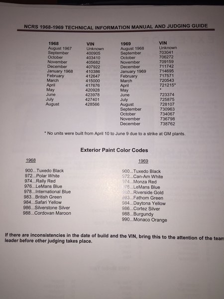

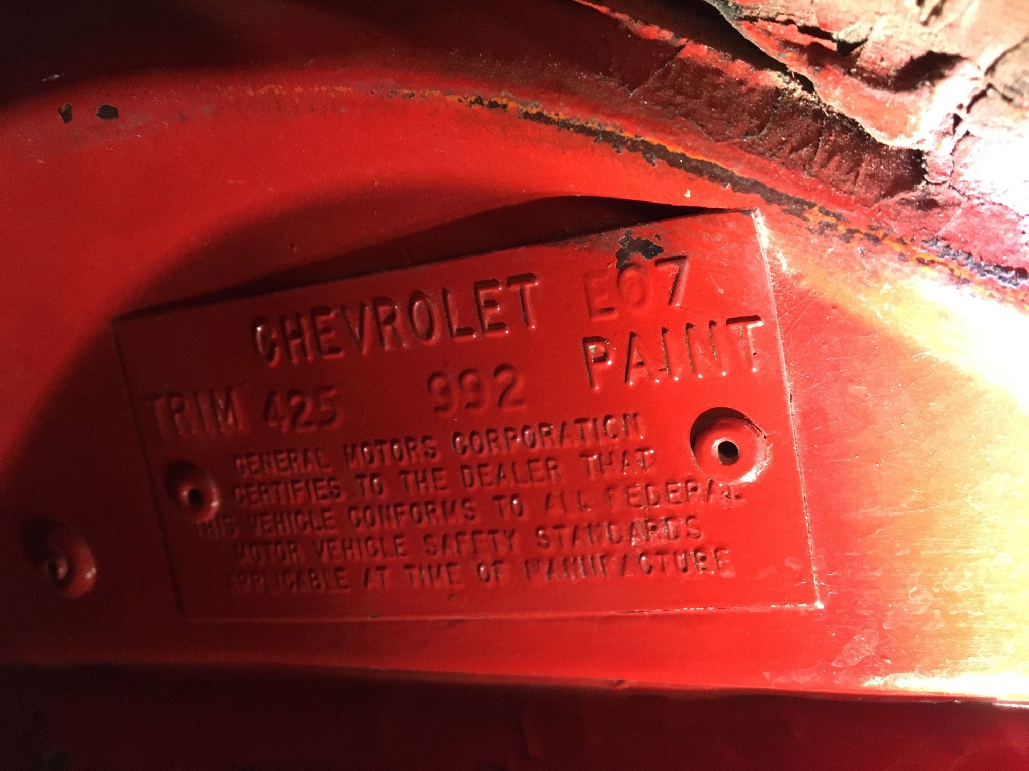

What do you guys make of this (other than the car has been painted)?
Trim tag shows December 7th, but the VIN shows early-mid October. http://corvettec3.ca/numbers.htm
The car's a mutt so I'm not sure why I care, but I wanted to take a snort of the $300 scotch on it's 50th birthday.

Your info lines up with what is in the NCRS Technical Information, the vin and tag don't match. Have you checked for a tank sticker? That can give you the trim info as well.
NCRS Technical Information doesn't list a 992 paint code, but some other checking shows it as Corvette Bronze, and the Trim code is for Dark Orange Vinyl. This was a Chevrolet listed combination, so the tag is feasible to be accurate to something, but not to that VIN.

S403673 should be an early Nov. build, VIN S403410 was the last car in October.
992 is Corvette Bronze in 1968 and Laguna Gray in 1970.
425 is Dark Orange Vinyl in 1968 and Dark Red Vinyl in 1973/74.
With the above information the 425/992 combination could only be a 1968 trim tag.
What is the VIN stamped on the frame?

First off, I find that VIN 03673 was built approximately November 3rd, not "early-mid October". Of course, 11/3/67 doesn't work with the trim tag body build date of 12/7 either.
I'm not sure why you called the car a "mutt", but if it really is, then the tag may have come from another car, but why would someone bother? The car's obviously not painted Corvette Copper, at least currently, so why go to the trouble of hanging a Corvette Copper trim tag on it? The rivets on the VIN tag, appear top be correct, and I don't see any indication that someone has played with the VIN tag.
68 production was a mess, especially at the beginning. It is possible that the trim tag was incorrectly stamped. There are documented known examples of 63-67's, with mistakes on the trim tag. It's certainly possible that it was a mistake on the tag, though I'm not aware of any other 68-82's, with documented mistakes on trim tags?

I'm not sure what "NCRS Technical Information" you're using, but both 992 and 425 are listed in the NCRS "1968-1982 Corvette Specification Guide".
I didn't even look up the vin beyond verifying it doesn't match a December 7th build date. As far as the color is concerned I know its a valid color combination but I was pointing out that its missing from the current NCRS 1968-1969 Technical information manual and judging guide so I had to use another source.
We know that there are deviations from time to time, but for a trim tag to be off by a month there would need to be documentation beyond this trim tag.

Alan got it right (as usual). The interior was from a 70-75? The frame isn't original because it has the bracing at the kick-ups which I do not believe were on early 68's, NOM, differential from a 65 (according to Tracdogg). It had YJ8 wheels and bubble tail lights (now gone). I'm trying to bring back some of the 68-ness, but overall the bones are solid, even if mismatched.

The color under the current paint is a non-metallic orange. You can see it in the upper right of the second picture where the paint is worn and wherever there is worn or chipped paint on the car, the same orange underlies the red. I haven't looked for the partial VIN on the frame because it has the bracing on the rear kick-ups which were not a feature of the early 68's so I'm assuming the frame was replaced. There was no tank sticker when I dropped the tank a couple of years ago. The VIN is the only thing that matters as far as title and registration so I'll call the birthday 11-3 and move on. Thanks for the correction on the date.
