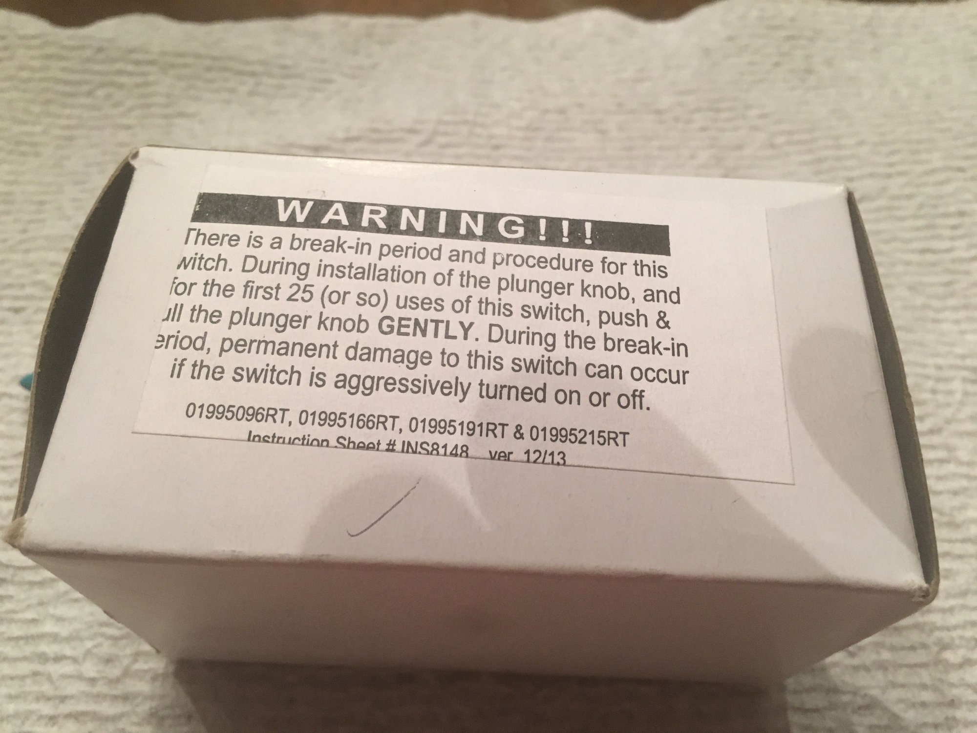

Also - none of the switches I tried do a good job of retaining the pull ****. The little spring/button that releases and retains the end of the shaft, are not very effective. Is there a secret to getting it to lock in properly?
The **** and shaft should be one piece. That shaft/**** assembly is removed by depressing that spring-loaded button on the side of the switch. To reassemble it, you should only have to insert the shaft and push it fully inward to re-engage that detent.

As for the shaft of the switch, the detent on the tip of the shaft doesnt seem to be well retained by the spring button on the switch. Each of the 4 switches fail to retain the shaft after only a few cycles. And I don't see any damage to the tip of the shaft either.

Hope you find what is causing your other problems.
