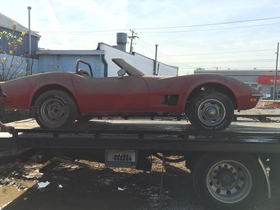

Here's how I picked it up (pictures in reverse order).
Cleaned up and parked. And so it begins.
Almost there! Back right caliper was frozen, got it loosened up.
Half-way through cleaning. It's still red under there. Those headlights got to go!
Wow, she's a mess.
Picking it up from Mr. Thief.

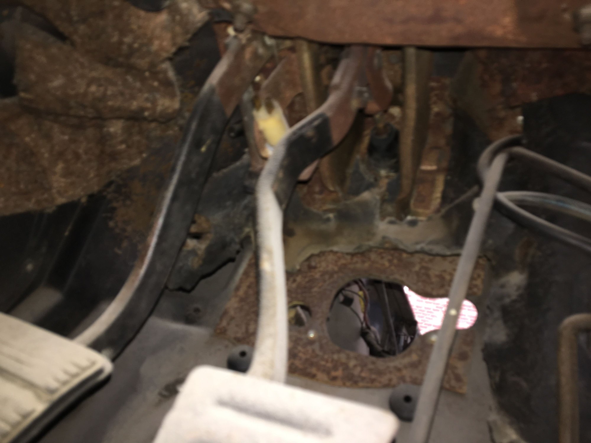

Cleaned and ready for scotch bright pads.

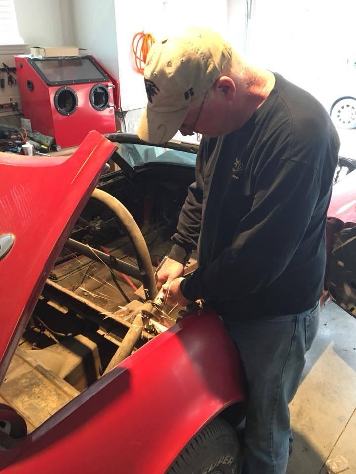

Buh-bye roll bar.
This thing sucks.

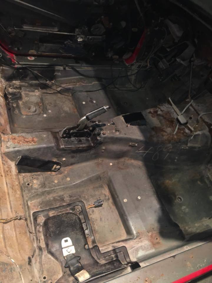

So today we started on interior.
I drove down to a nice gentleman in Alabama who had an original hood, steering wheel, and headlight assembly. I am headed to another gentleman out of state this weekend who has an entire original dash assembly, brake booster, and more headlights to swap for my recessed headlights. I also have an original carpet set here, 2 full sets of brand new seat belts plus the original passenger side that is still in the car, and bought several sections of nomex heat shielding tape-down to put in after it's cleaned up.
Today we started with the roll bar cut out. Took us a while but we got the main part of it out. Now to cut it flush with the car, foam fill it, then fiberglass over to seal. It'll be covered with carpet, so that's good enough. It'll never be stock again, anyway.
I then proceeded to rough scrub the dust and nastiness off the stripped interior, vacuum up all the small bits and dust, then simply wiped down with water. The difference was amazing! Tomorrow I'll scrape the carpet remnants off, use the angle grinder with a scotch bright pad, then use a light grey primer all through the interior so I can see what I'm doing better.
