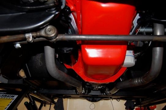

I am installing this N11 off road 2 ½ exhaust system. I am concerned because the front pipes come within less than 1” of the under body floor. My old pipes where much closer together with quite a different shape (see picture below) and maintained a much father clearance to the underside. Should I be concerned or is this proper? According to the exhaust distributor I received all the correct pipe parts so no mistake there. Also do my original pipes look like the Factory original pipes and/or correct shapes?
Thanks Rick

ed427vette: I believe your correct, maybe 68?? But I figure fitment clearance should still be the same.
Alan: My old pipes do look more like your GM replacement pipes.
On mine their are some numbers stamped on the inside area but are much closer to the exhaust manifolds so maybe they are original and the correct shape.
Also, your pipes seem to be approximately 2" away from the bell housing and father away from the under body. Where these N11 pipes are closer to 4" away from the bell housing and within 1" of the under body, again that concerns me regarding heat.
Maybe someone can post a picture of there N11 exhaust for comparison?
Rick

I do personally like the N11 exhaust system better than stock.
Regarding the exhaust sound volume at idle is different but not substantially louder, at cruise it is stock sounding, although when stepping into it it is significantly louder and free-flowing as a result of the size increase. I'll try posting a sound video in the future.
My particular concern after installing was that the driver side front pipe clearance distance to the underside fiberglass body was much less than the original exhaust system, this posed a serious heat issue.
I ordered my system from Corvette Central, exhaust system kit # 323106 (front set # 323539 & 323025 rear set) in the front set are part #’s 323607 driver side and 322532 for the passenger side. The folks at Corvette Central swapped out part # 323607 for 322533 which made a significant increase in clearance to the underbody.
I would recommend this substituted part number for a small block 4 speed set up.
See example pictures below.
Rick
