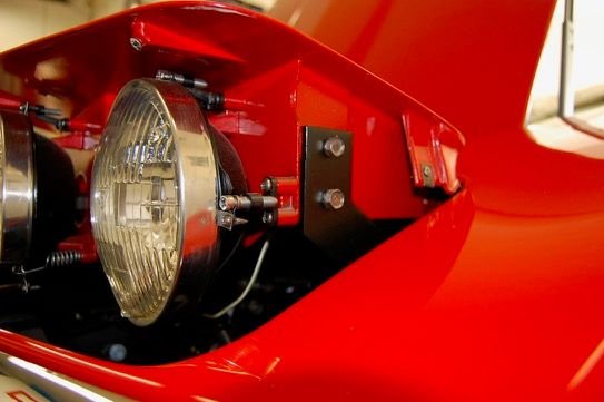

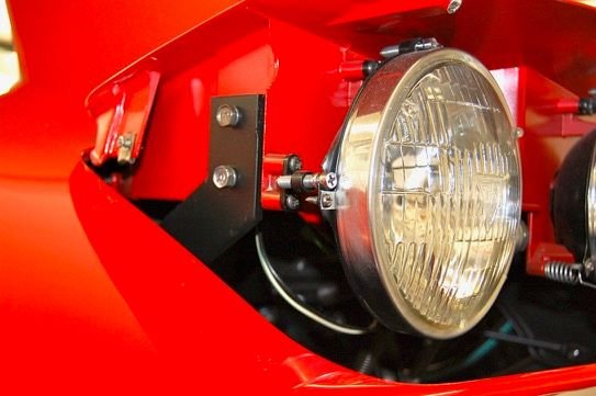

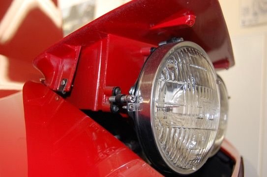

Hi S,
I added some photos.
You can see all cups have the adjustment at their top.
While 2 of the cups have the adjustment at their left, and 2 have it at their right.
That's why it matters where the cups end up.
Regards,
Alan
