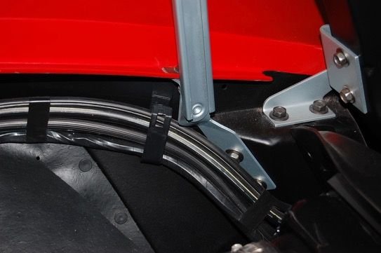

There is a little play in the side bolts for the inner fender to the core support, you might try loosening these bolts and see if you can move the support up or the inner fenders downward... it's not much as you can see from the holes in the inner fender bracket pictured below but it might give you enough.
