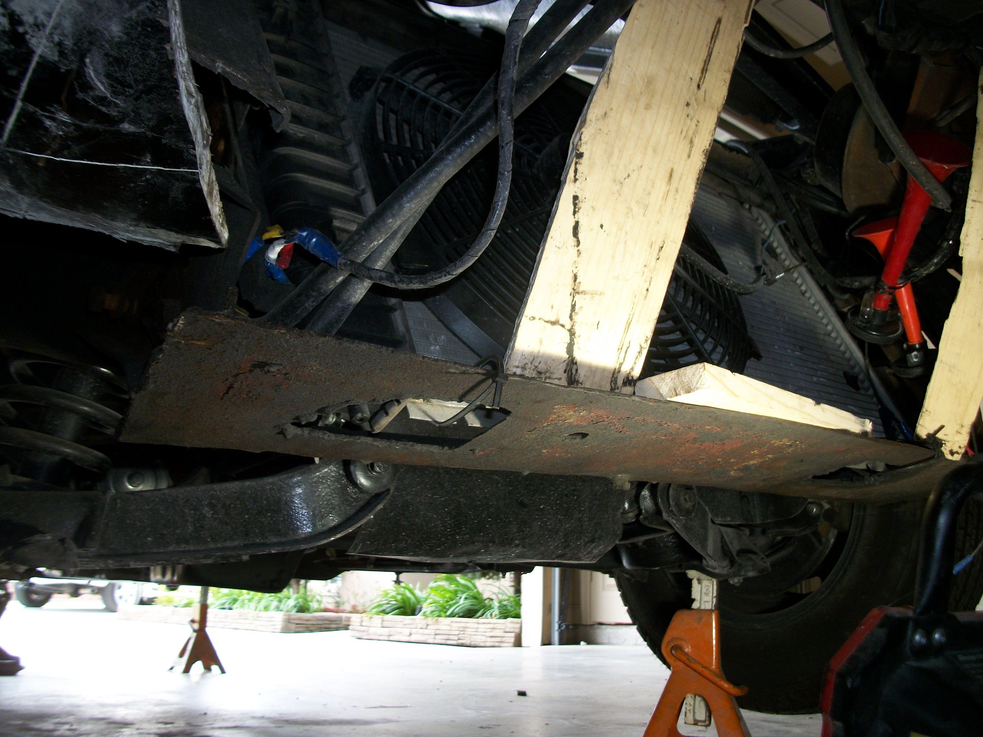

Something tells me that this front crossmember is not just going to buff out :-p

If that's the crossmember, what condition is the frame in?
surprisingly good except for the #3 mounts as far as I can tell with the body still on.
The rad support and front crossmember rotted out, the frame has surface rust only. Go figure.
