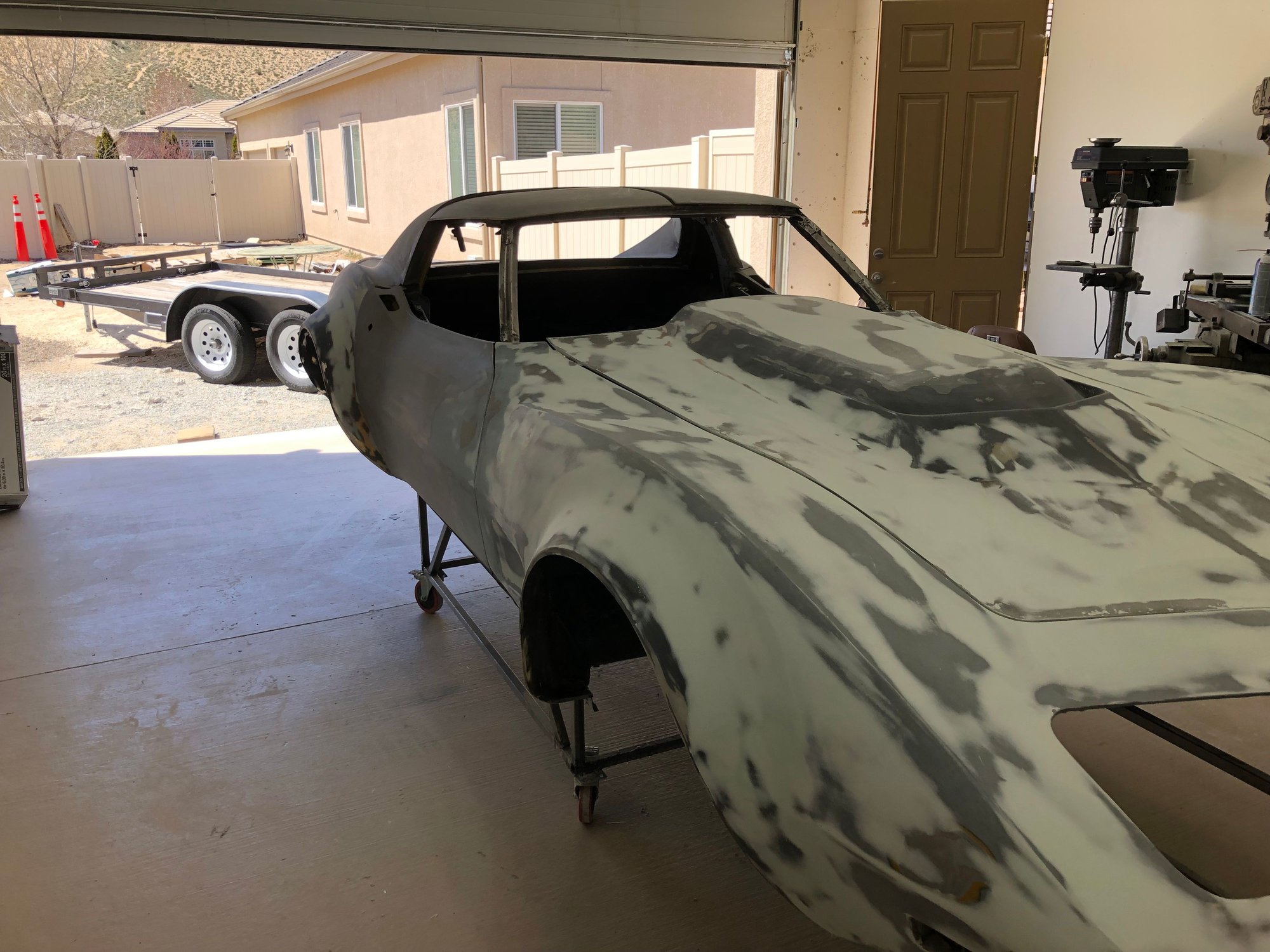

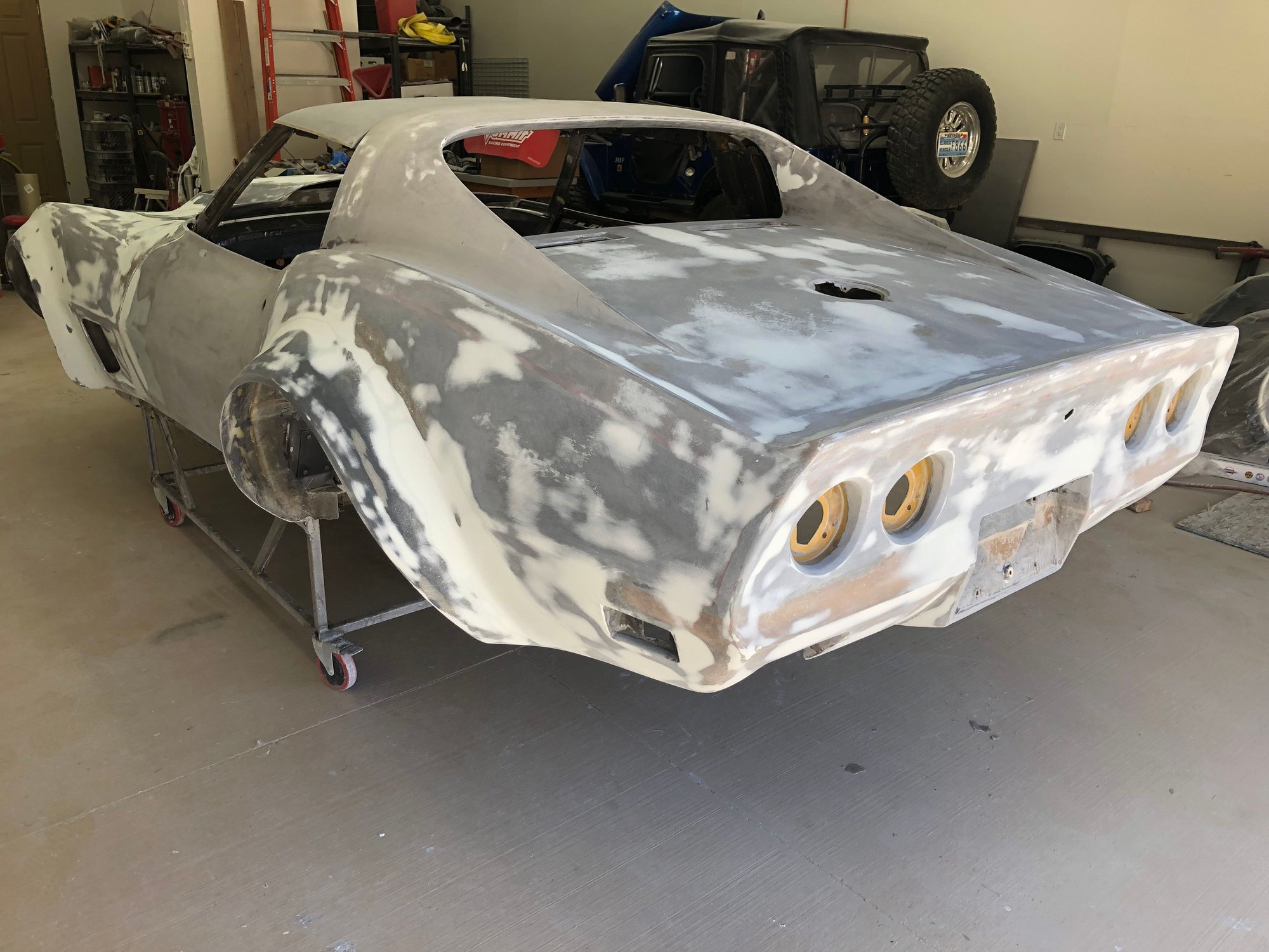

Well almost a year of body work and starting to go through primer, soon to be in paint.
Ready for primer
Ready for Primer

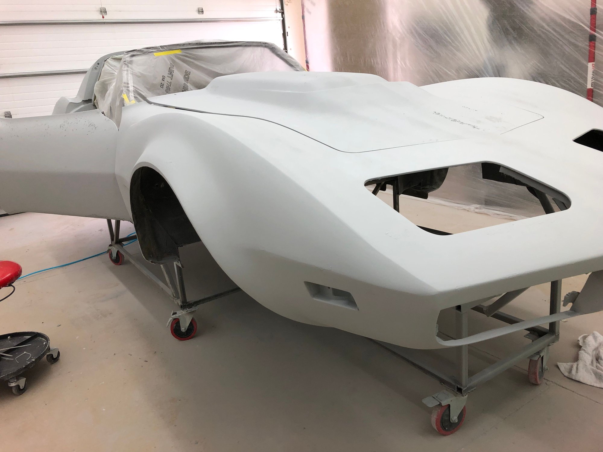

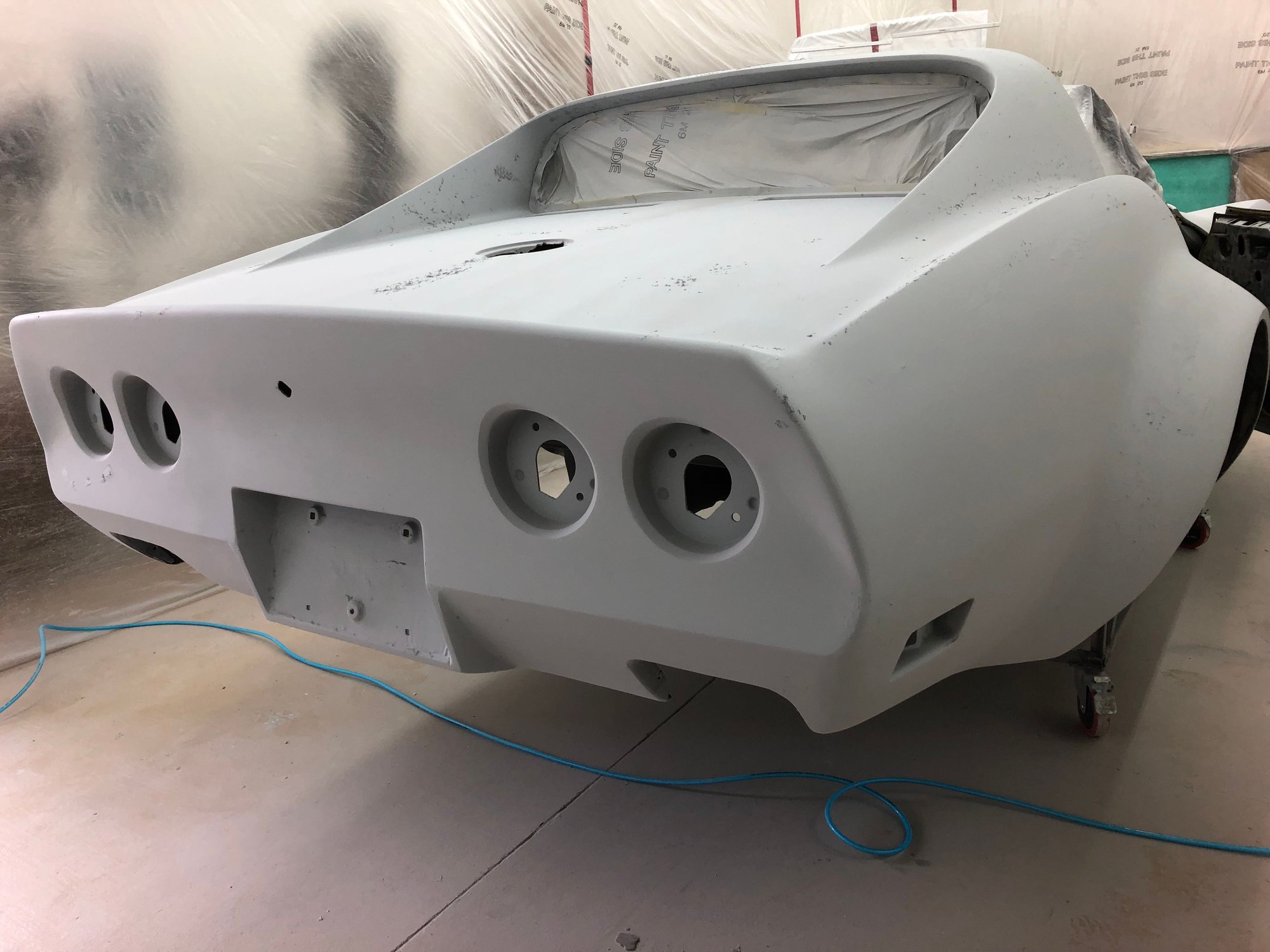

After first coat of primer, still needs lots of sanding.
After first coat of primer, still a ways to go. The trash in the primer is fiber glass strands that need to be sanded out and primered over.
