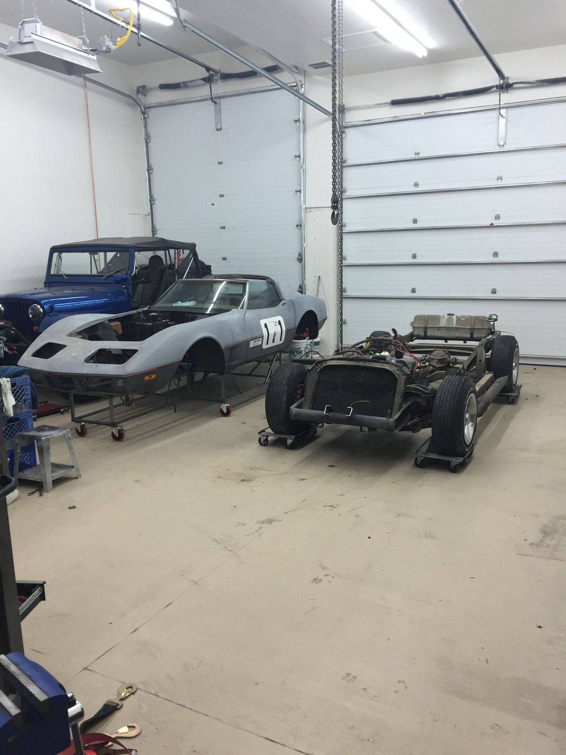

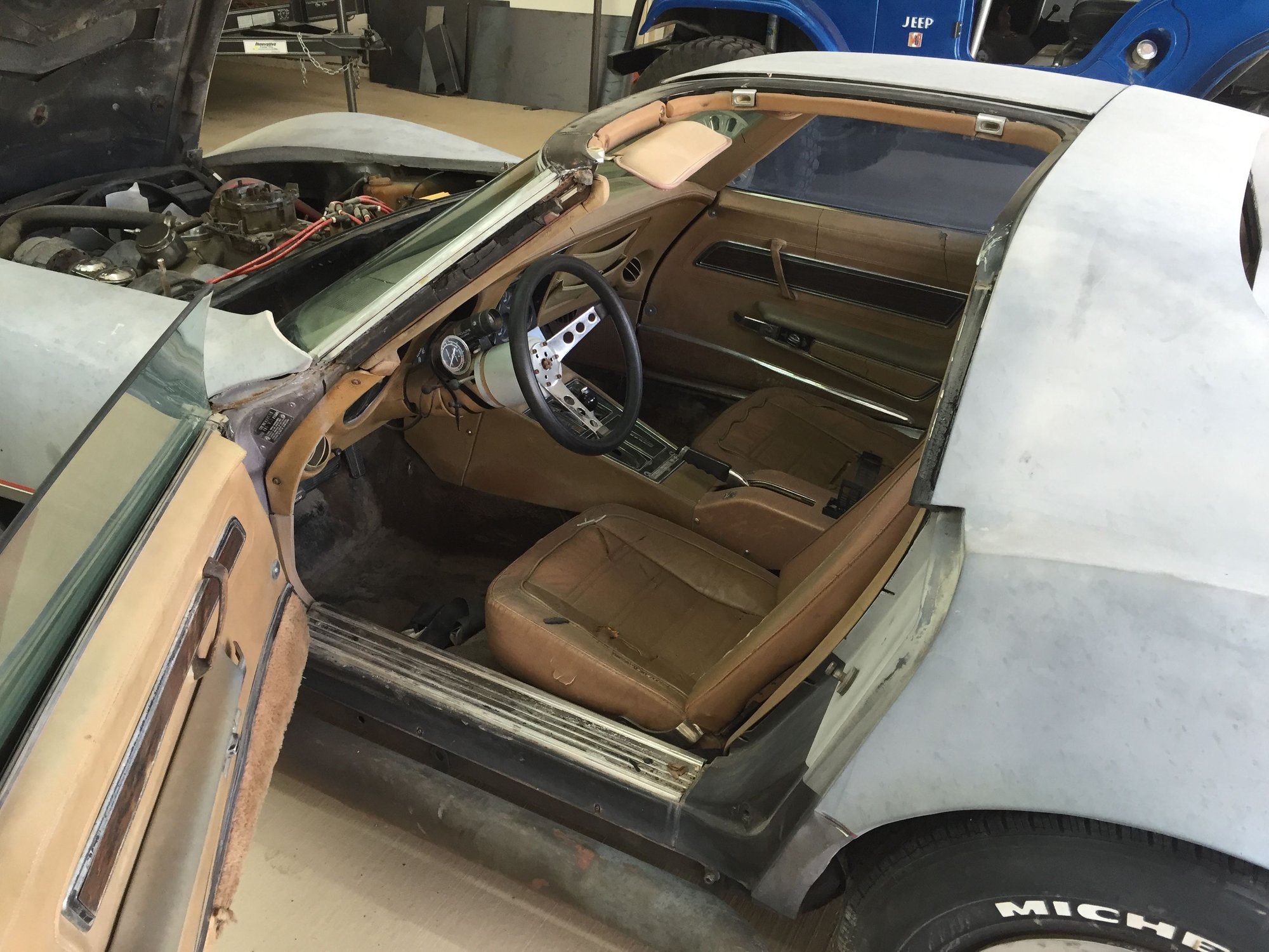

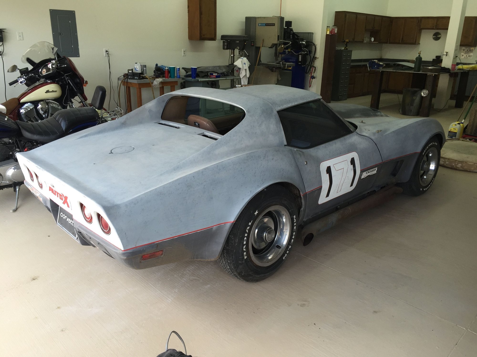

Well I am starting year 3 of my '73 build. Decided to pull together a brief build thread.
Started around December 2015 with this:

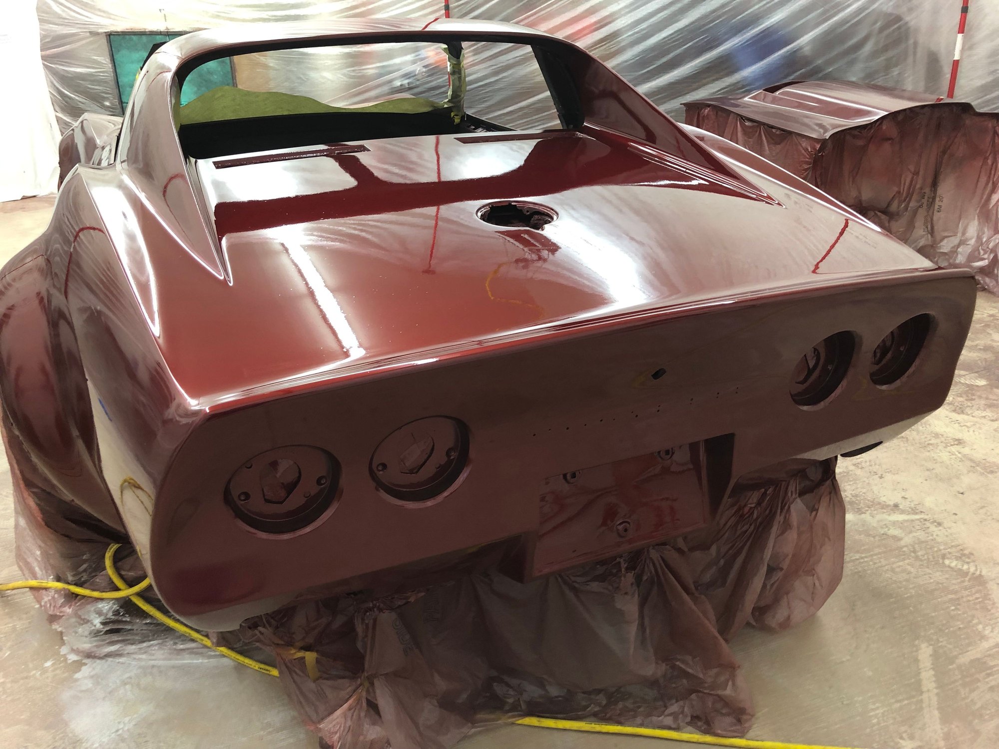

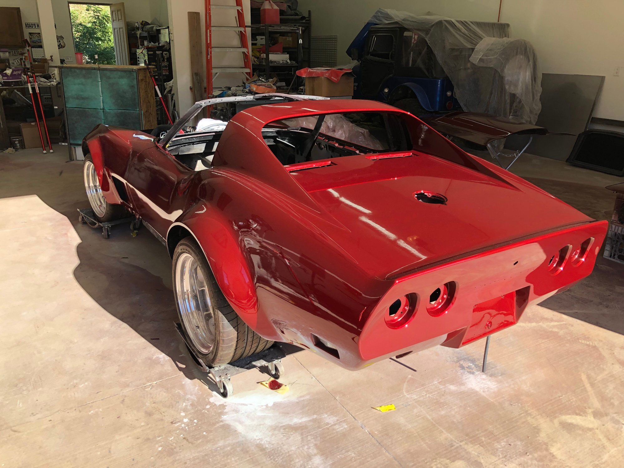

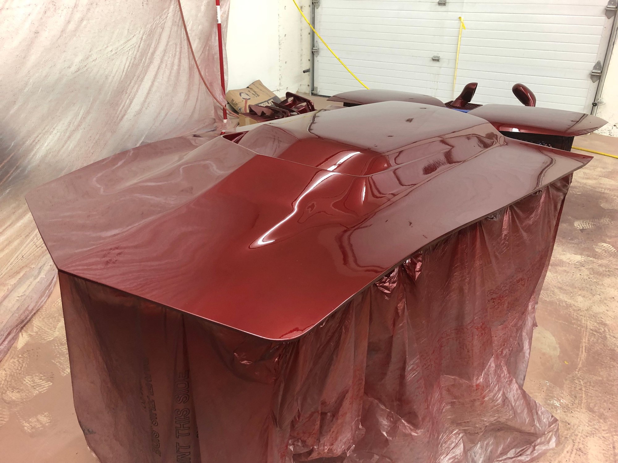

And now it is red... Finally after over a year of body work.

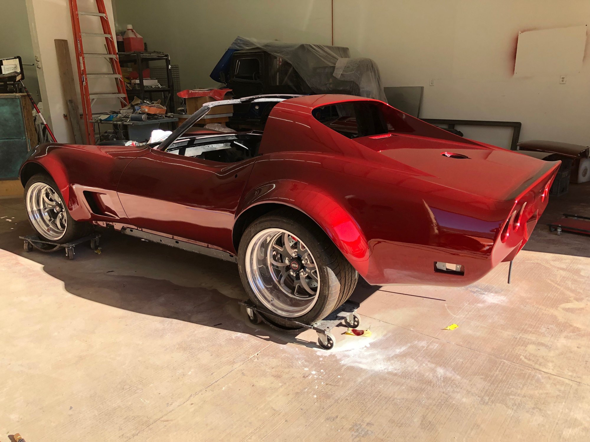

From this point, it somewhat quickly moved on to this:

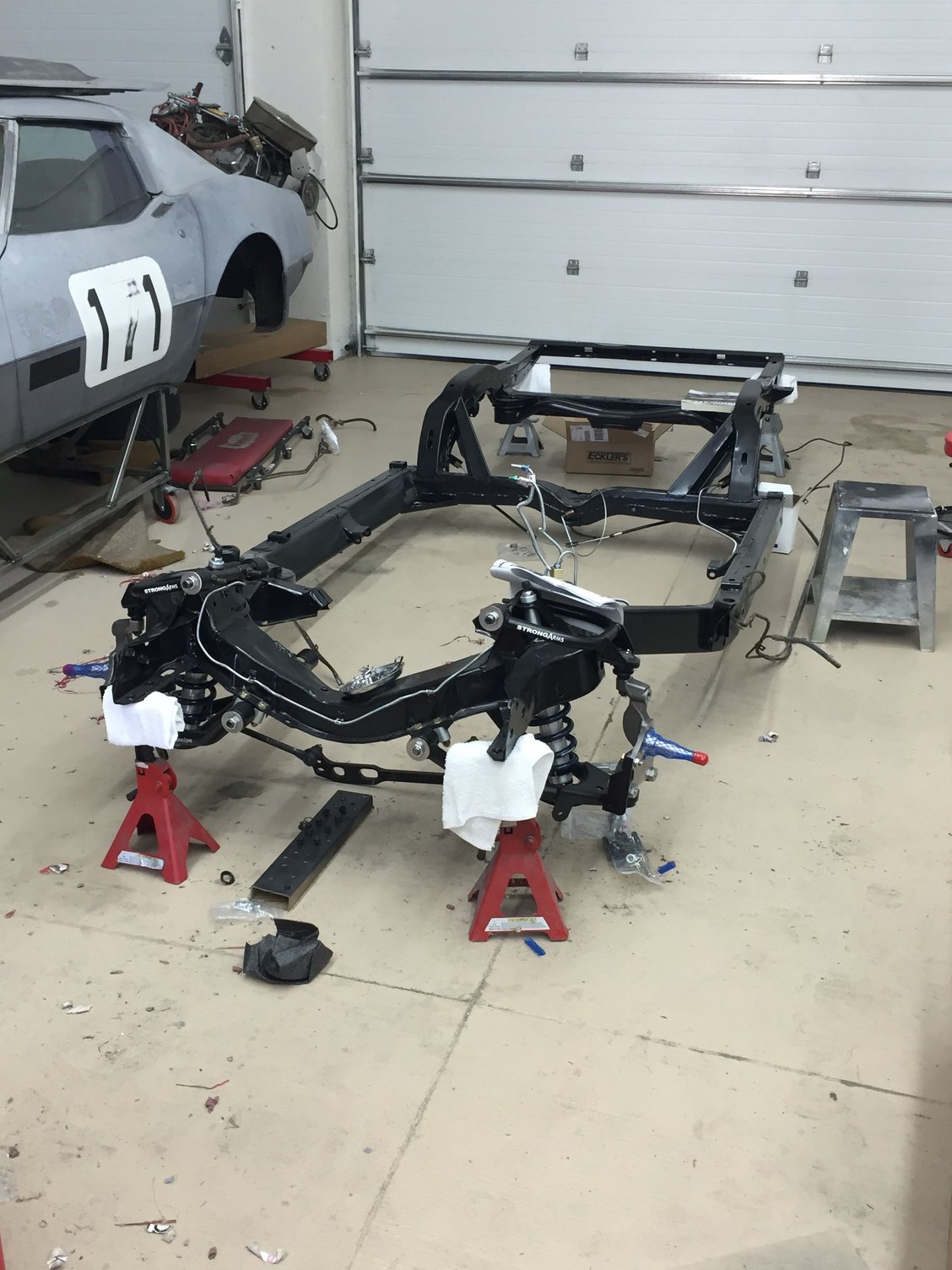

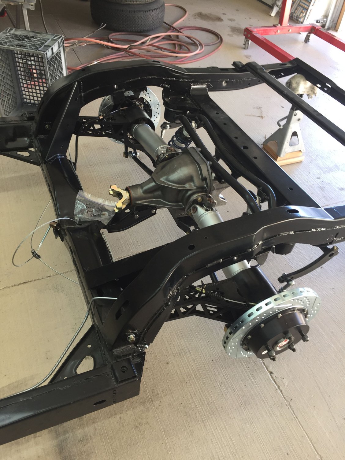

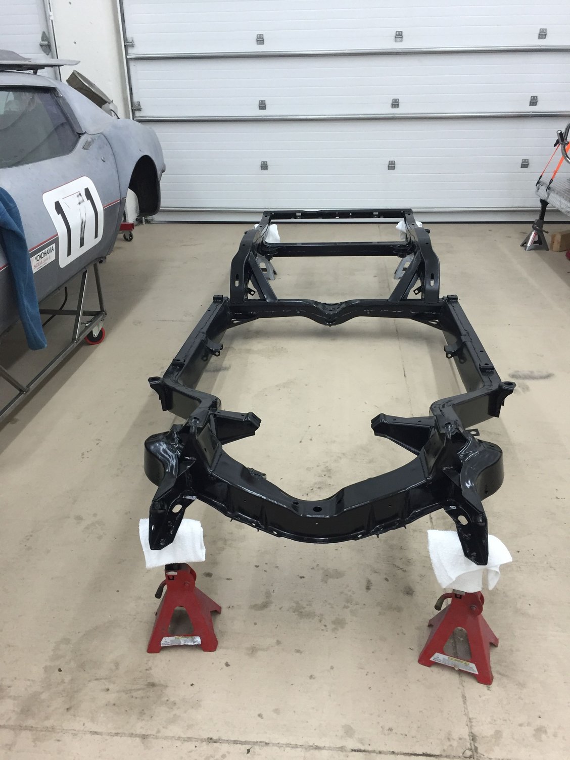

After getting to the root of the matter, started the rebuild with a fresh powder coat.

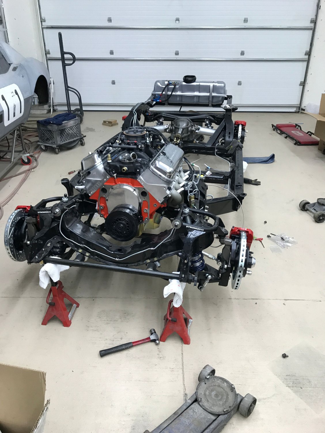

Some new brake lines...

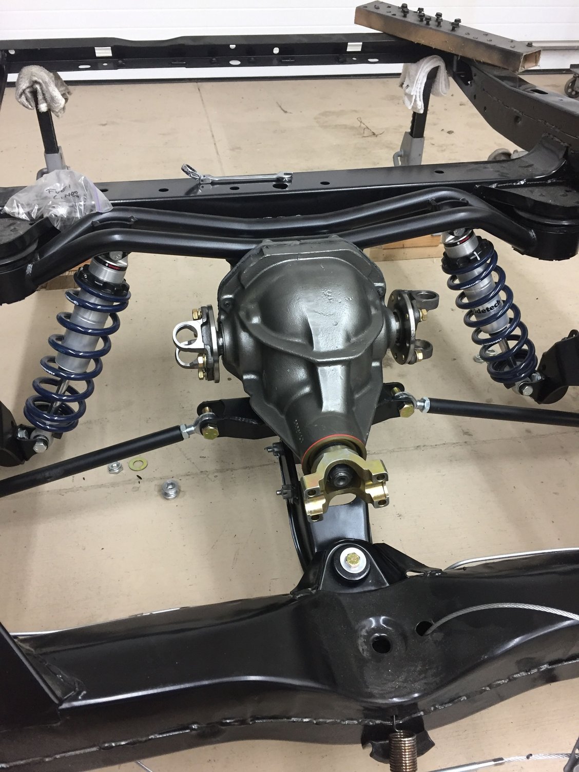

Some pretty suspension bits from Ridetech as well as something to stop it from Baer

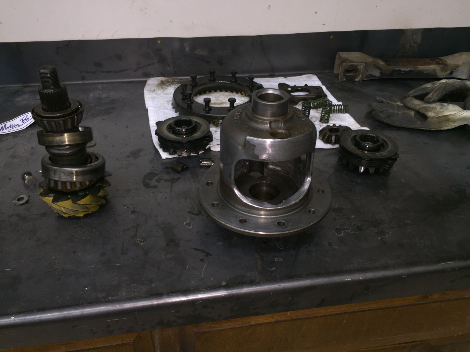

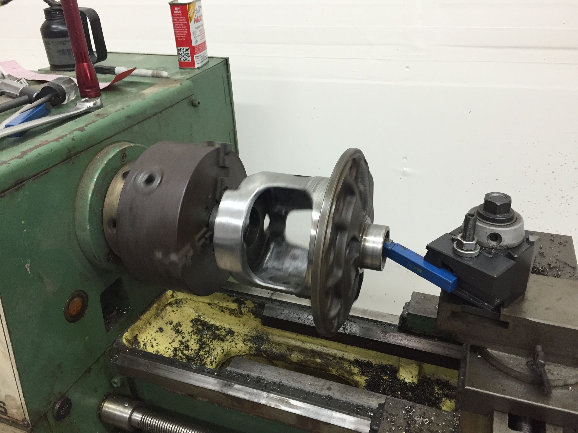

Then needed something for the rear wheels, so time to rebuild the rear diff with a tuned posi and some new gears, etc.

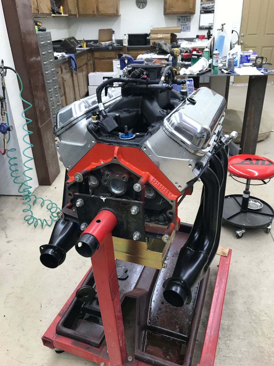

On to the engine....

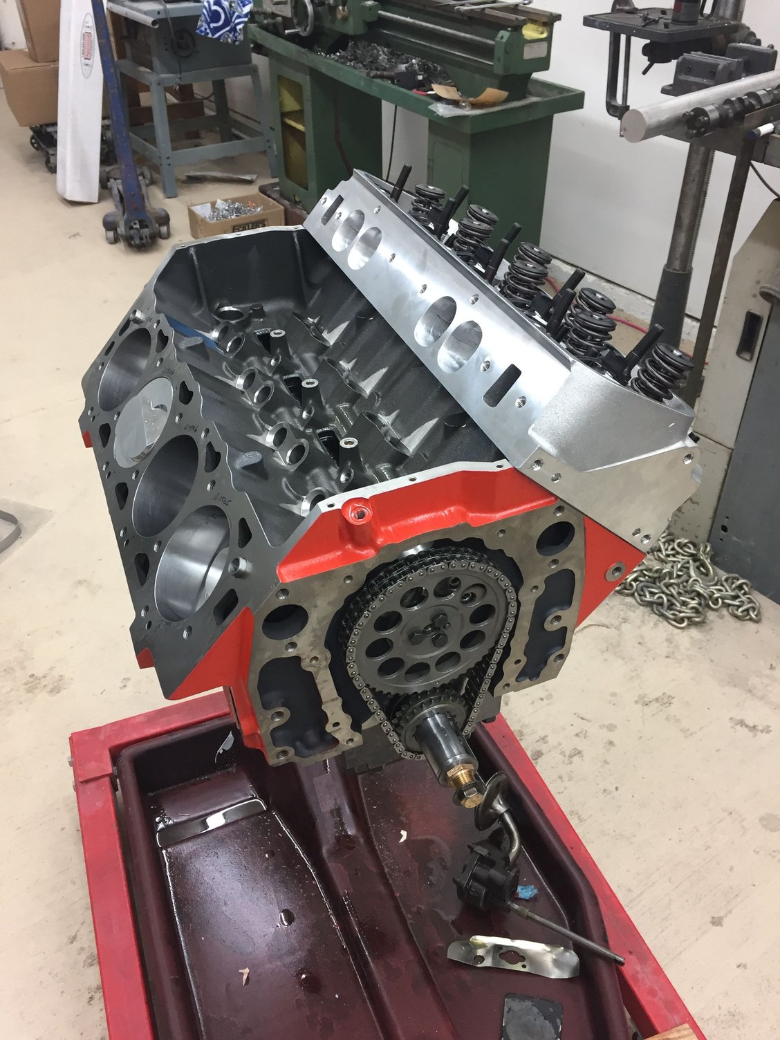

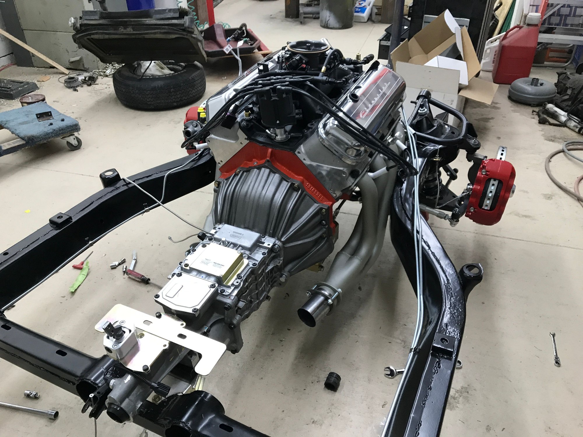

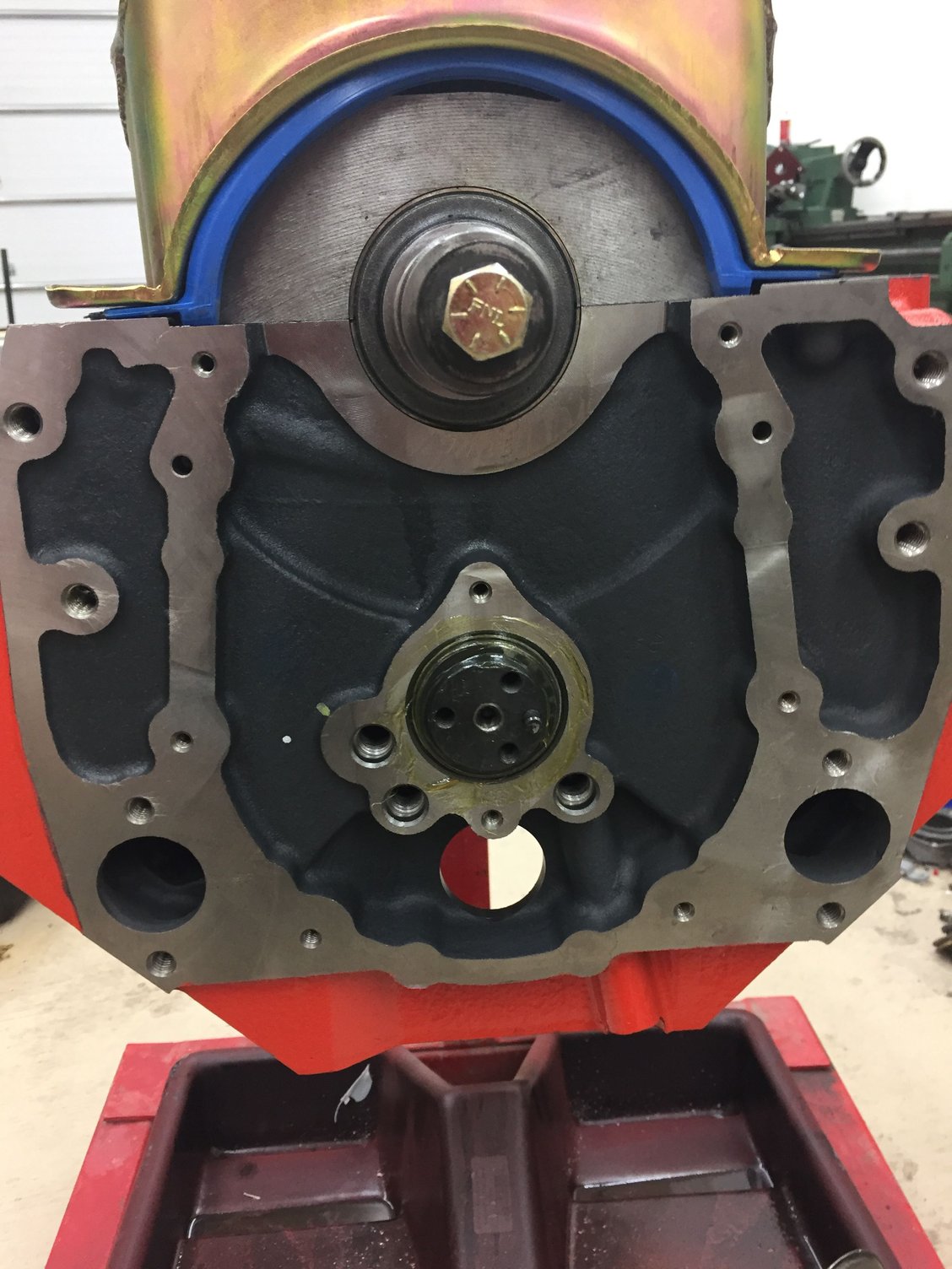

After some inspection, magnaflux, etc. Found the block to be cracked in 3 separate cylinders. This is getting spendy now.
Decided after much debate to go with a new GM block and a Scat balanced stroker rotating assembly for a healthy 488 build. Zero'd the deck and put on some Brodix Heads, Straub roller cam, roller lifters, etc, etc. Around 10.5:1 compression should get it down the road ok.

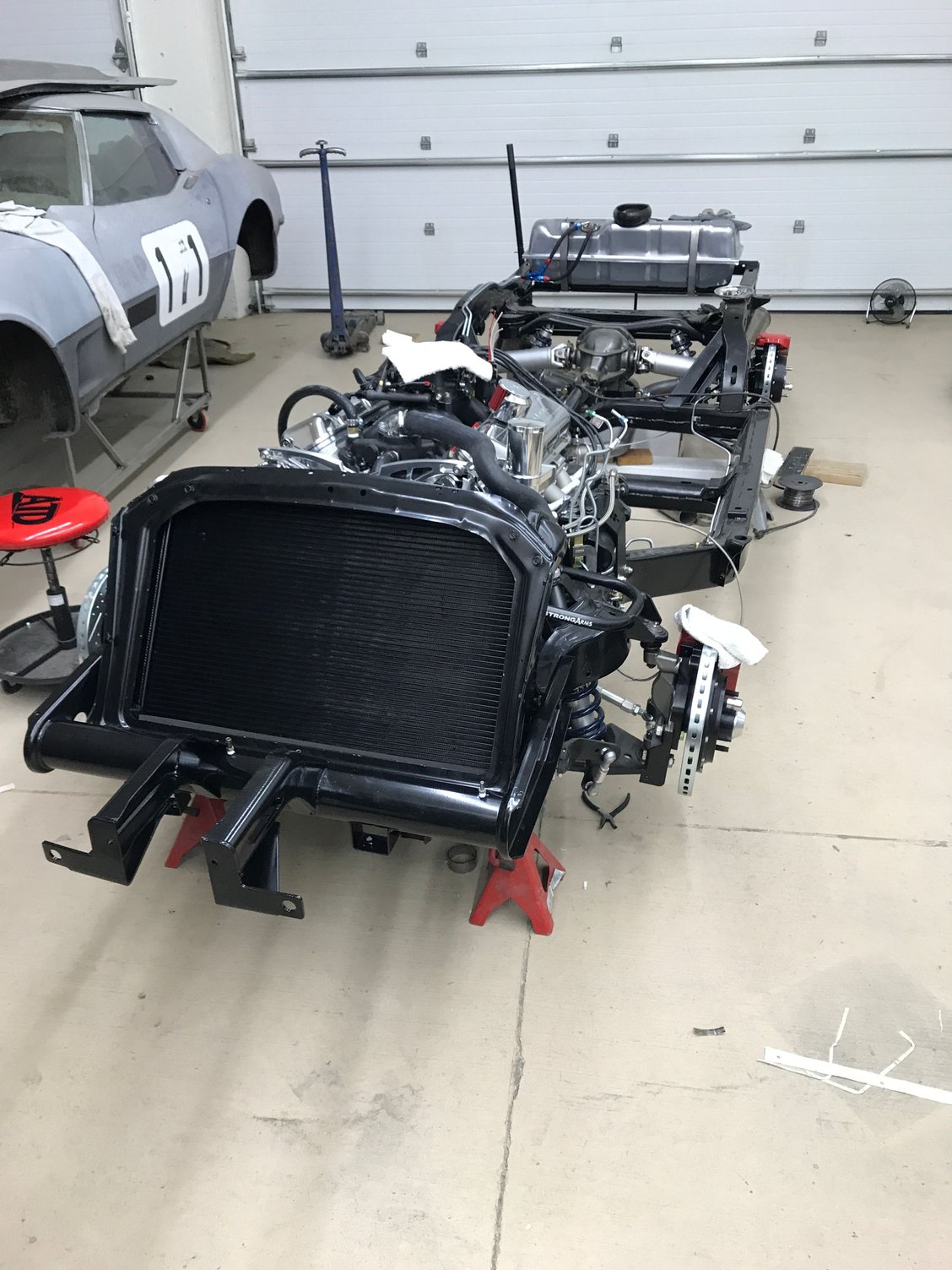

ceramic coated headers
Engine back in the frame
Old Dec 14, 2017 | 11:19 AM
73racevette's Avatar
73racevette
Joined: Jan 2016
Posts: 502
Likes: 103
From: Reno Nevada

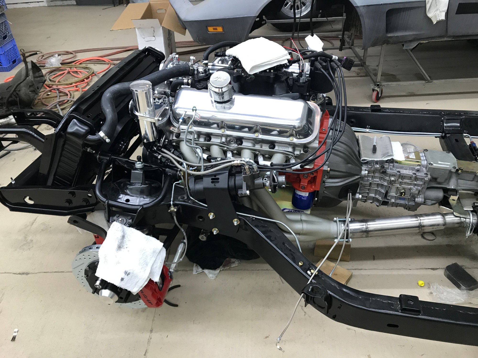

Originally had a TH400 tranny, but decided to go with a TKO600 tranny.

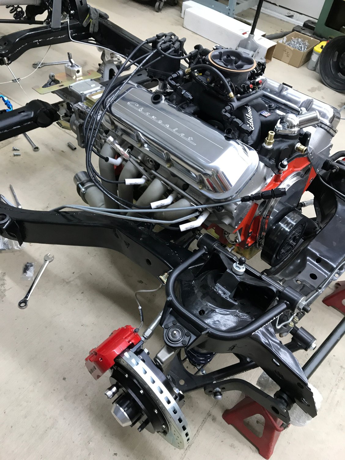

Front of the engine mostly put together with a March pulley system, Dewitts radiator, remote PS reservoir and a borgenson steering box.
