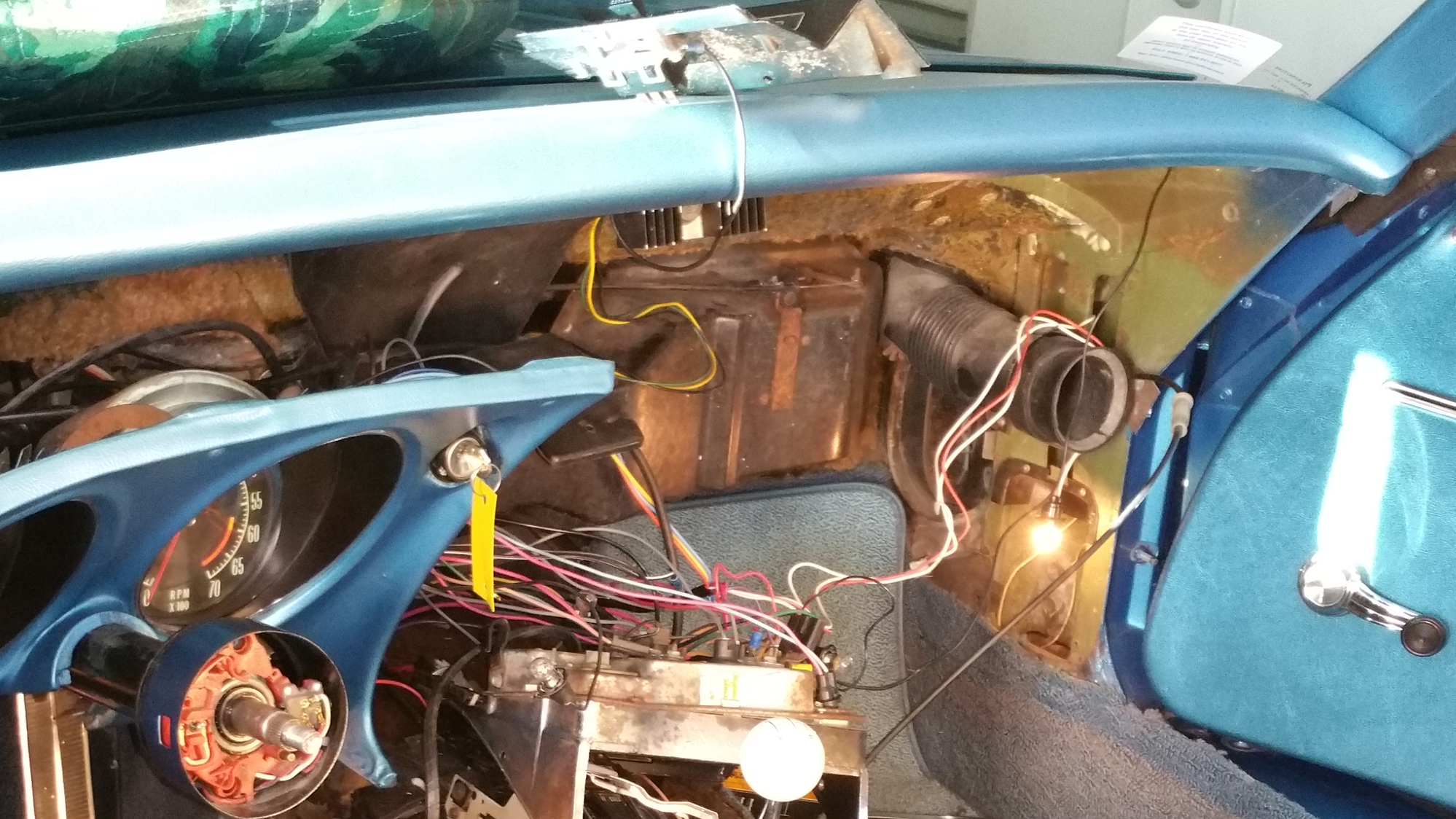

I am installing a Vintage Air air conditioning into my 1968 C3 convertable. The Evaporator unit is huge and will not fit with the under-dash support bracing in place (see photo). Can I safely remove these two braces? Does someone know a work-around for this if these braces are needed?
Braces are in yellow

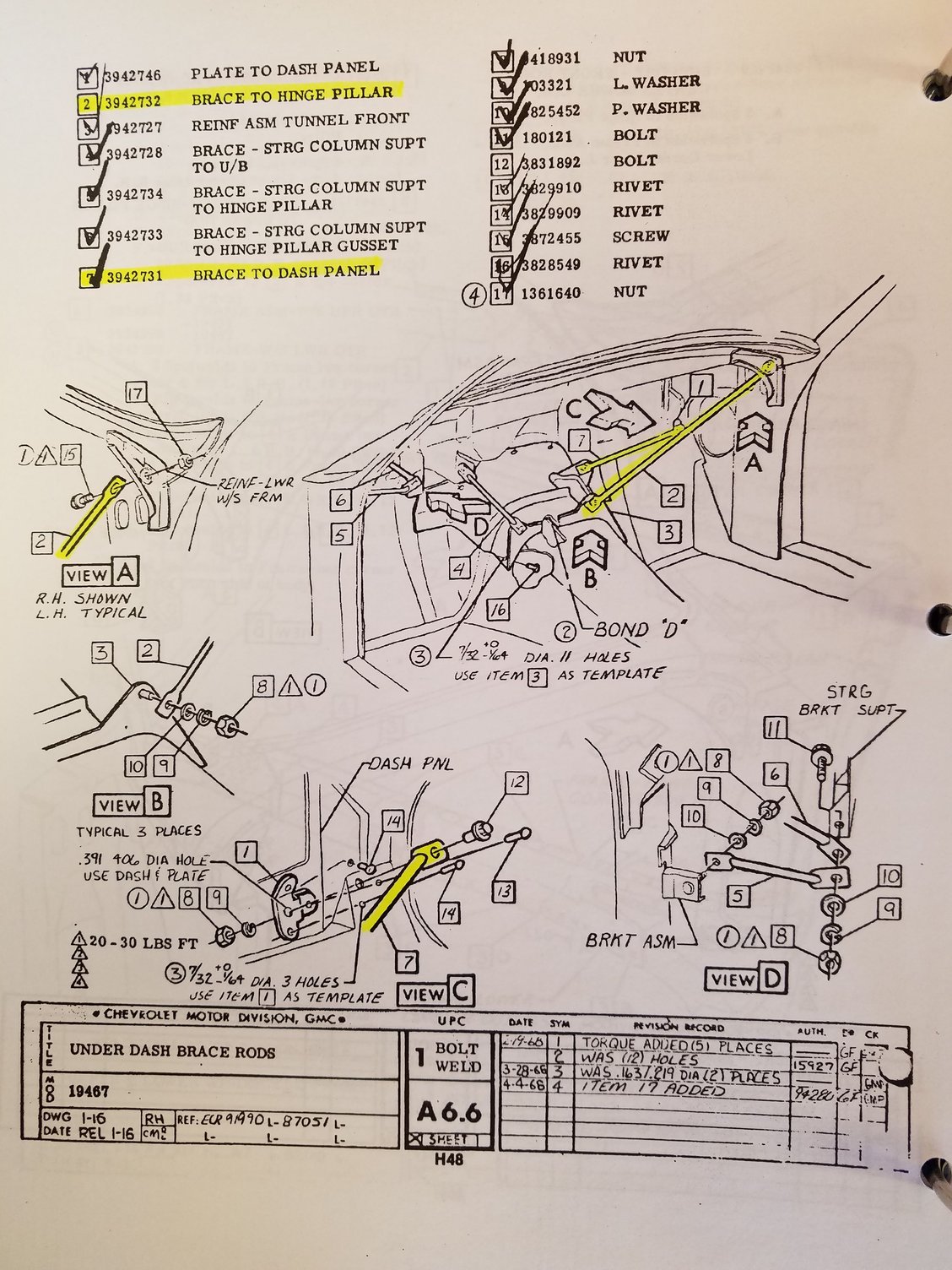

Look at the AIM for an AC car. IIRC, those braces are not used in an AC car.

The information I'm looking at indicates that convertibles that had the a/c option still had the cowl brace rods.
I don't know if the aftermarket systems allow for them or not.
The braces were added to reduce 'cowl shake'.
You can remove them but expect more 'creaks and groans'.

You could fabricate braces that would fit "around" the vintage air box. The previous owner removed the braces on my project/the car had those squeeks/groans Alan described..........
The good news is....after I rebuilt the original suspension and installed new tires ALL the squeeks/groans went away.

VA instructions say to remove those braces which will be in the way.
I want to remember I only had to remove one brace to get the VA unit to fit. Also had to cut one of the tabs off or bend it over. Never noticed any driving difference before and after. Or you could do what DG suggested and fab up something, but I really do not think you need it.
Hope this helps and good luck with the install.

You all have been a tremendous help! I have removed the braces and have installed the box. Now, I will see what I can fabricate to replace the braces. I cannot thank you enough!
