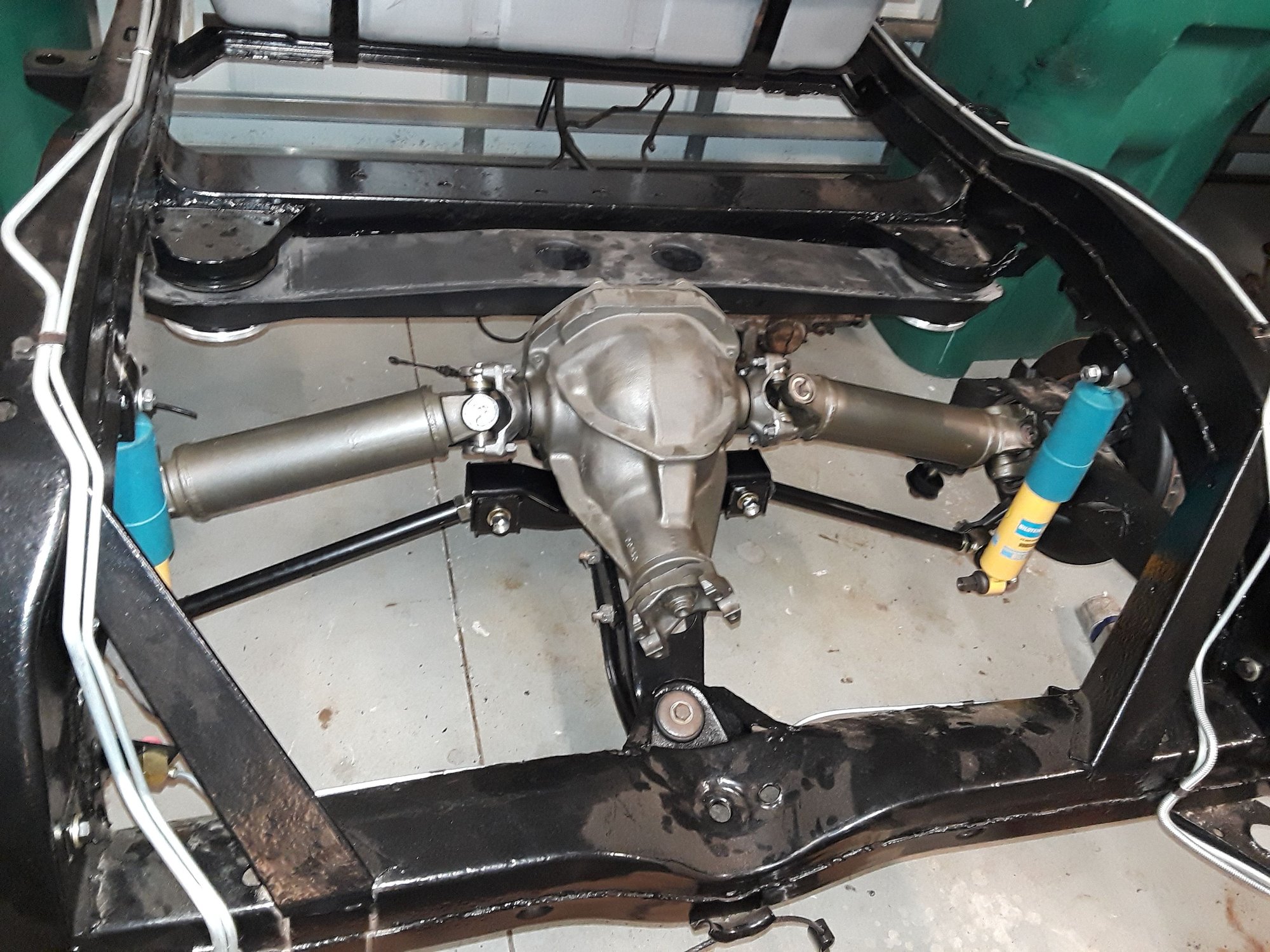

Rear end install

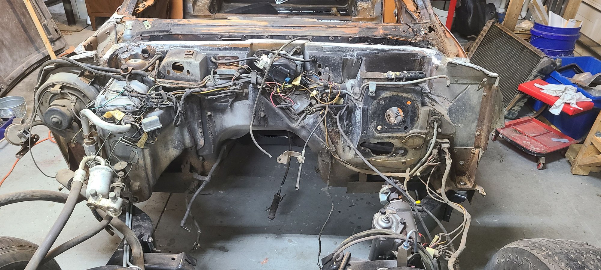

New front end showed up​​​​​​​​​​​​​​​

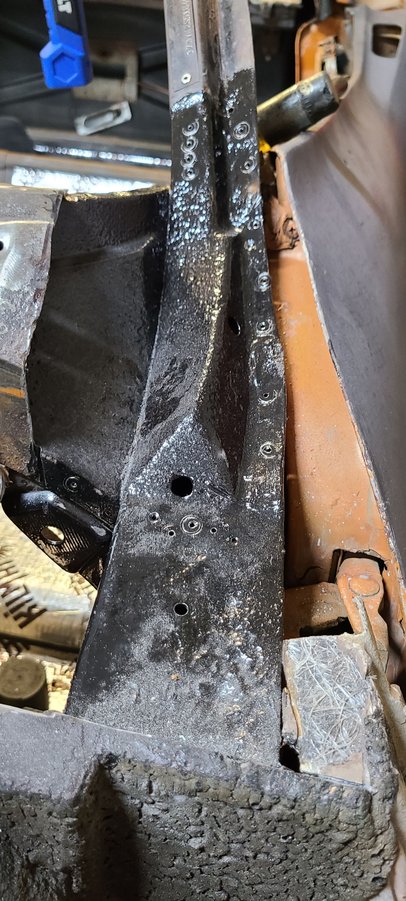

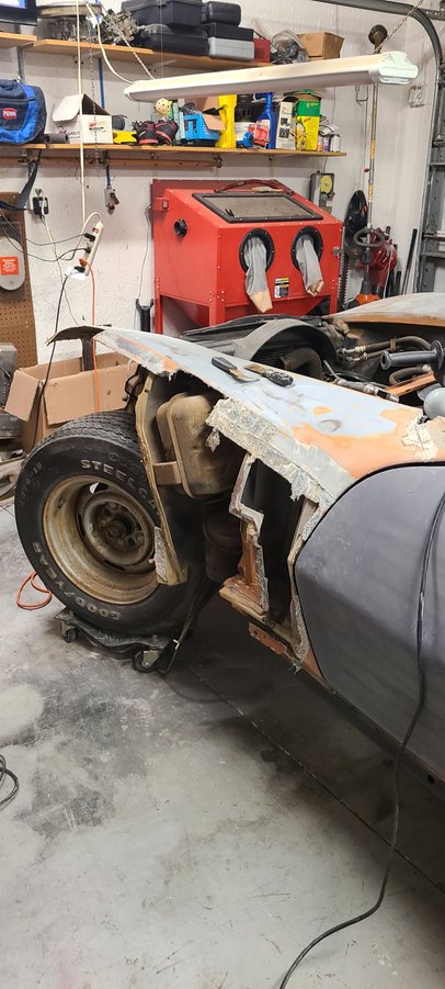

Found some rust, PO did a wiper door delete and bondo'd the crap out of the fenders to try and match the lines of a long hood, and basically blocked any drainage resulting in this.

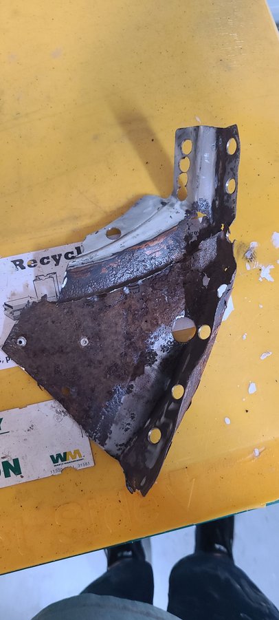

Cut out and repair

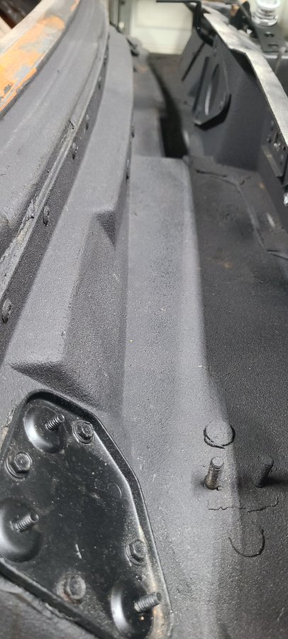

Firewall before and after

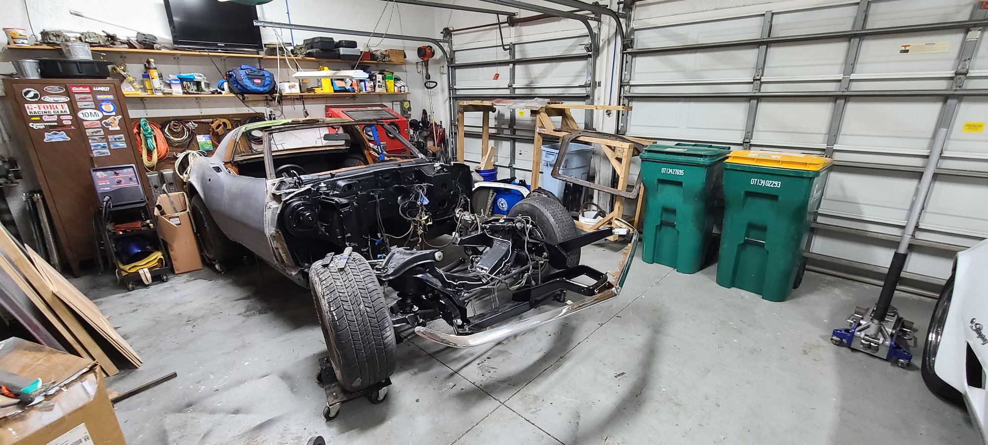

Bumper fit check!

Bumper fit check!

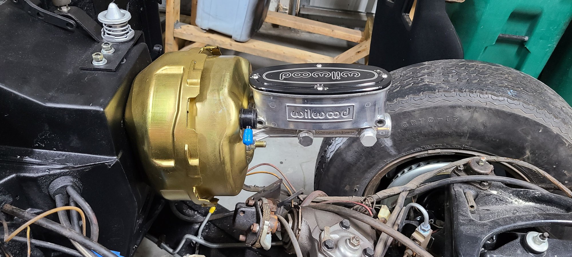

Got the hydraulic clutch, Tuff Stuff vacuum booster, and Wilwood master cylinder installed today.

Nice booster!

Nice booster!
Thanks! It was almost a direct fit, the clevis was just short, so it took just a little modification to make it longer.
