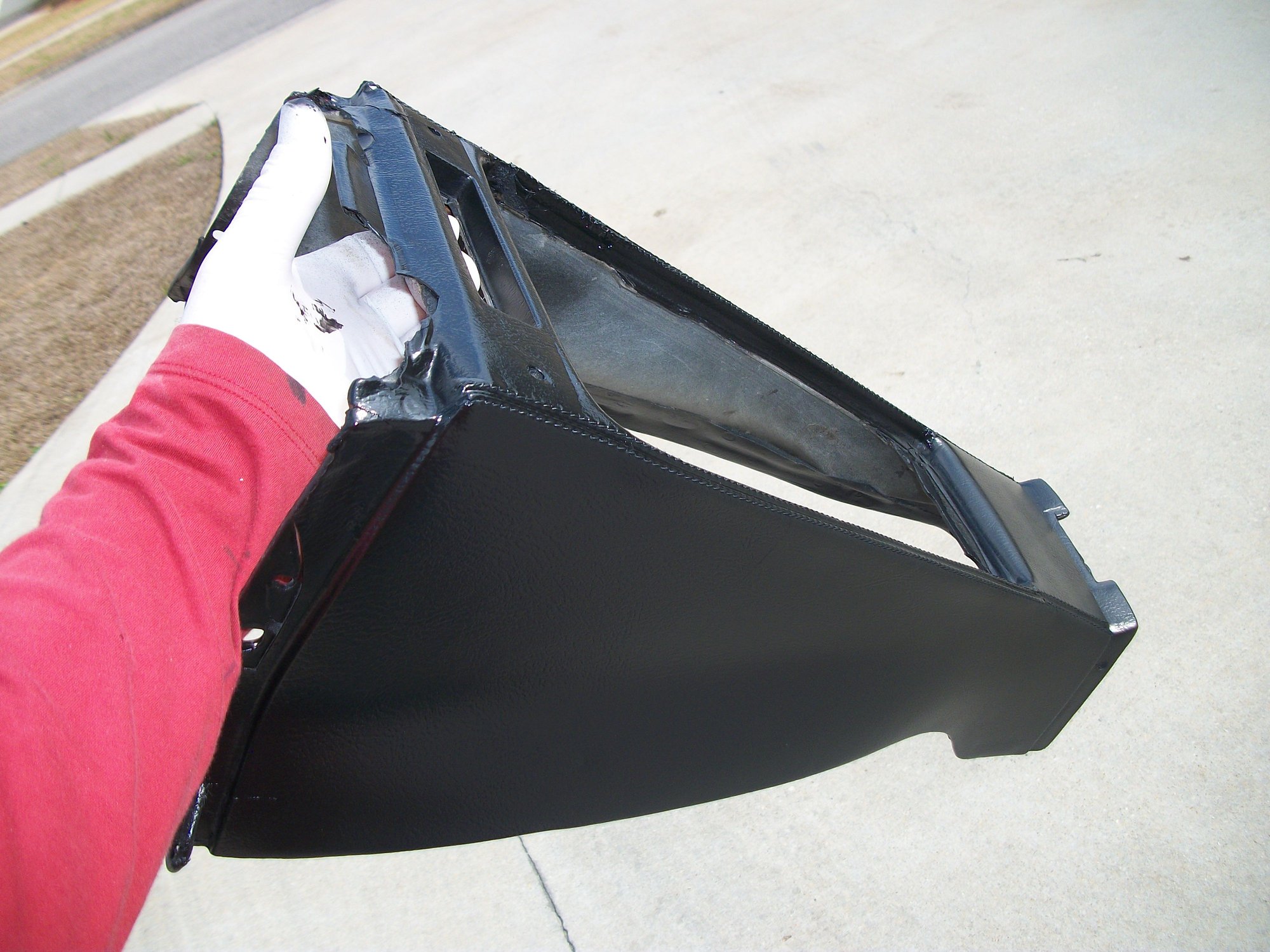

How would you un-warp a new console?
Thanks much.
Steve

Soak in a tub of very hot water, twist it back to straight while submerged. Then right away dunk in to a tub of cold water while holding the twist while its cooling. Works for any plastic.

Wow, what vendor sold that? If it's plastic i would use a heat gun and go slow. Personally, I would send it back.
Yes, I would guess the adhesive used in the vinyl-to-plastic bond should remain unaffected with just hot water, but I just don't know for sure. I understand and like the concept CVO.
Thanks.
Steve
Tewski,
This afternoon by email, I did try to get an answer on a fix from Knoch directly, but perhaps they never got a chance to answer it.
And to their defense, I bought it last summer, just getting to the installation today. And the problem with that: In the front, one side of the console is longer than the other, so it twists when sitting on an even surface. Add 5-6 months and Summer temperatures, this is what happens. Now, I never checked for a warped condition when it arrived, but why should I, since I never installed one before and ignorant of any possible flaws. Plus it was drop shipped from Knoch; fresh as could be and looked great.
Yeah, I got a heat gun. But .....

BUT your problem isn't the same. I would use some form of heat as the members advised, and I would "bend" the plastic frame slightly more than needed so that over a week's time the frame would gradually settle to a "level" position.

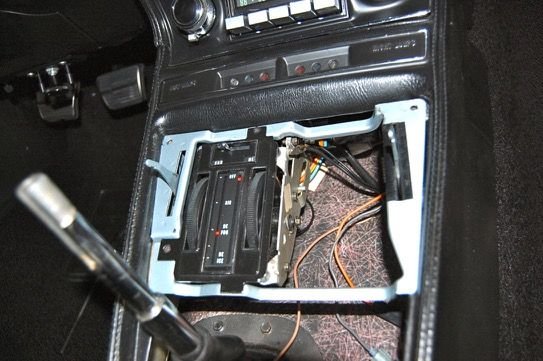

Hi Steve,
How firmly is it 'locked' into that shape?
If you install the plate that the heater control mounts to and the shift plate does that do anything to help 'guide' the console into the proper shape across it's top?
Regards,

Originally Posted by Alan 71
Hi Steve,
Regards,
Alan
Hi Alan,
It's stiff! Not 16-ply truck tire stiff, but it takes considerable force to straighten, and on release it returns immediately to it's warped position. The under-plate support frame doesn't fit well in it's place, and the top plate doesn't even come close to fitting in place. She's warped outta place bad. I believe if the console IS straightened out, both will fit and all will be well.
Thanks for the photos Alan.

I've never seen on twisted like that but I think you can install it. You'd have to use a long awe to guide to the front mounting hole and that should get in the correct position. I'm not sure, but that will probably allow the heater plate to sit in there correctly.
When you install it, wrap a 2x4 with a cloth, place it on the back of the console and use the parking brake gear as leverage for a pry bar. We do this with all the shift consoles in the shop and you'll usually need a good push forward to get it in place. Once it's been in there a while it'll just fall back in after you take it out. For you, you may need to get a friend to help you so someone can push the rear and you can use the awe to guide it to the hole.

I just got it to straighten out.
I wasn't sure how to go about it, so I took the least invasive and easiest approach first. I set it out in the sun upside down. Was just under 80 here today, so in the sun it was warmer. After a few hours of that I picked it up, twisted it back to it's proper shape by hand in the shade, and noticed it helped some. Not a lot, but some.
So I figured Tewski was right on; I took a heat gun to the underside corners where the sides meet the top surfaces, and corrected the warp even more by heating (not much), bending, and then cooling while holding it bent. Came out well. Picture to follow.

The plate fits now!
