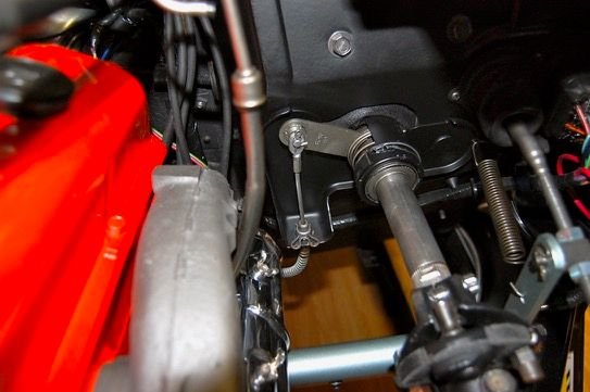

Hi l,
Typically the cable should move easily within the protective sheath.
Sometimes the cable begins to develop a slight 'kink' at either end where the cable enters the sheath. This can make it more difficult to slide.
So perhaps check for that condition too.
Also, there's a small bracket on the transmission that helps align the cable.... is that there?
Regards,
Alan
Cable is quite straight where it enters the sheath.

Yes, the clamp is in position, the car has not been messed with(BUBBA delite). I'll take the cable loose where it attaches the transmission, then see how it feels. I did have the motor and transmission out while I detailed the engine bay and under carriage, maybe, I did not get the attachment of the cable correct, but it felt that way before it was taken out. I just did not remember to check that problem while doing everything else. Tanks to Alan for responding, you are a great help of this forum!!!! This is on a 76 by the way.
