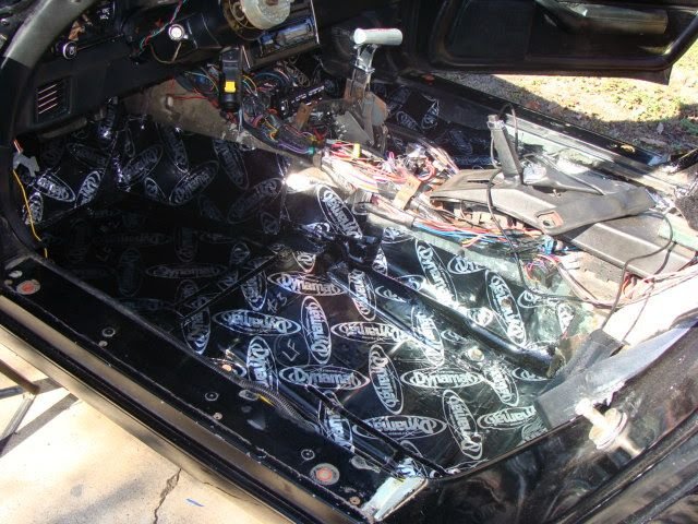

Take that old stuff out.
Clean and paint the floorboard if needed. Put in the Dynamat. I also put in the Dynapad to help insulate. The results are awesome. I have a black on black '81 in Central Texas. 100 degree days are the norm here in summer. It keeps the inside of the car very cool and noise levels are reduced. It allows me to turn my brain to mush with a loud stereo system. Lol.
Summit Racing has three pre-cut Dynamat kits for C3s. Doors, front, and back.

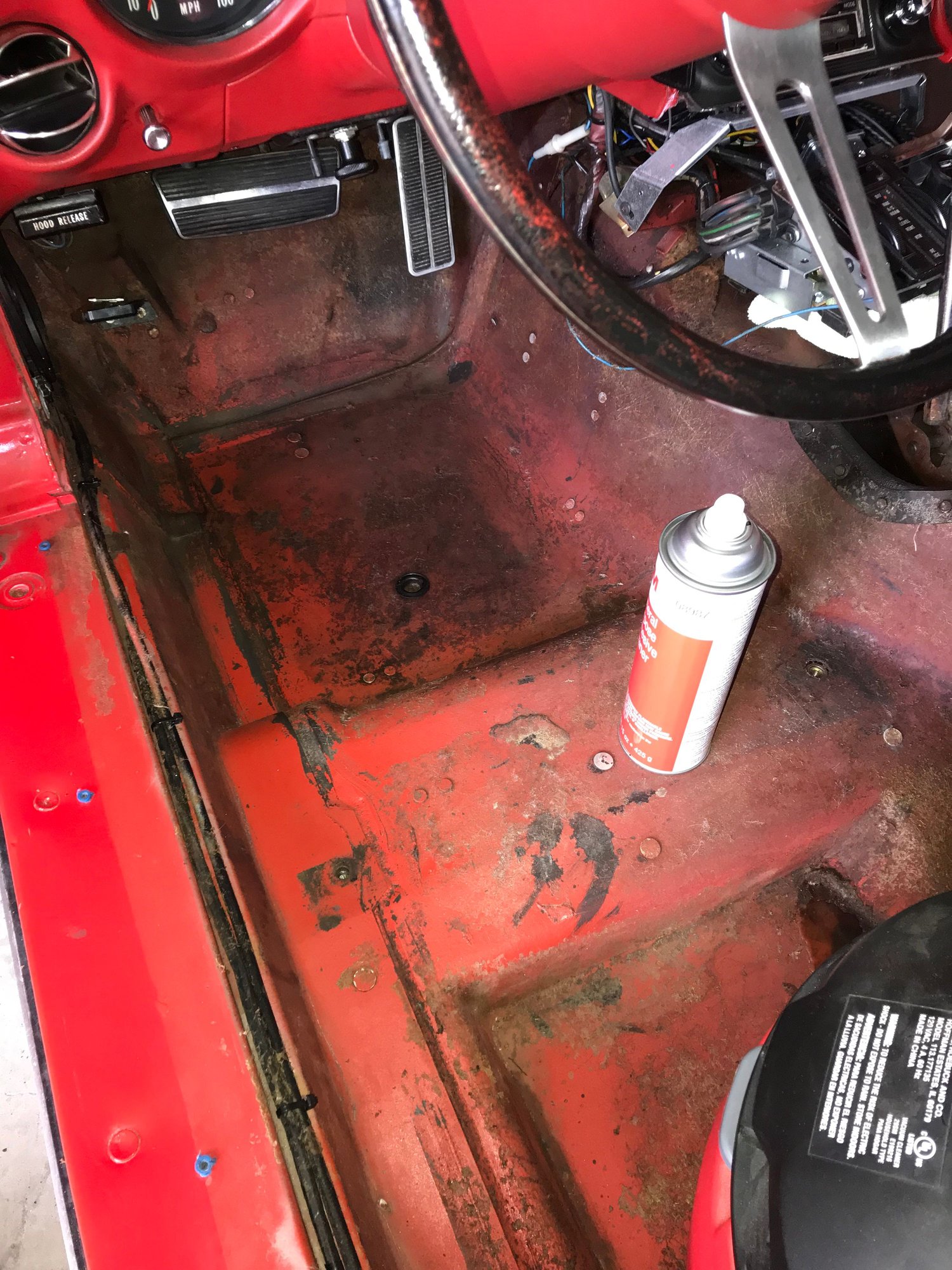

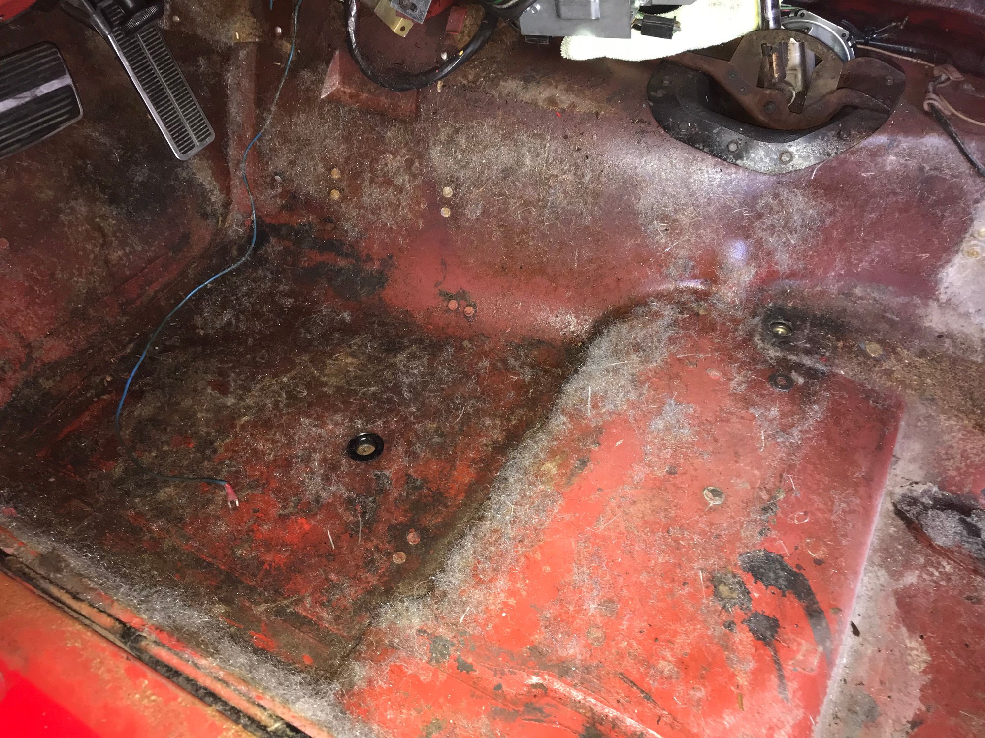

Double dangit...you guys know how to put the pressure on. I decided to try to carve through the layers of adhesive in order to prepare the foot wells for dynamat. I still have some cleanup to go but here is a before and after photo of the driver's footwell. I need to continue to clean it up a bit. Do you think the dynamat is going to stick to the foot well surface? Also, I assume you then glue the felt to the dynamat.
So far, I have about 15 hours of labor scrapping adhesive off the interior...hope to finish today.
Before:
After...pending more clean-up:

Tom. It's good enough.
As for sticking, once you roll it down, just try taking it off.
