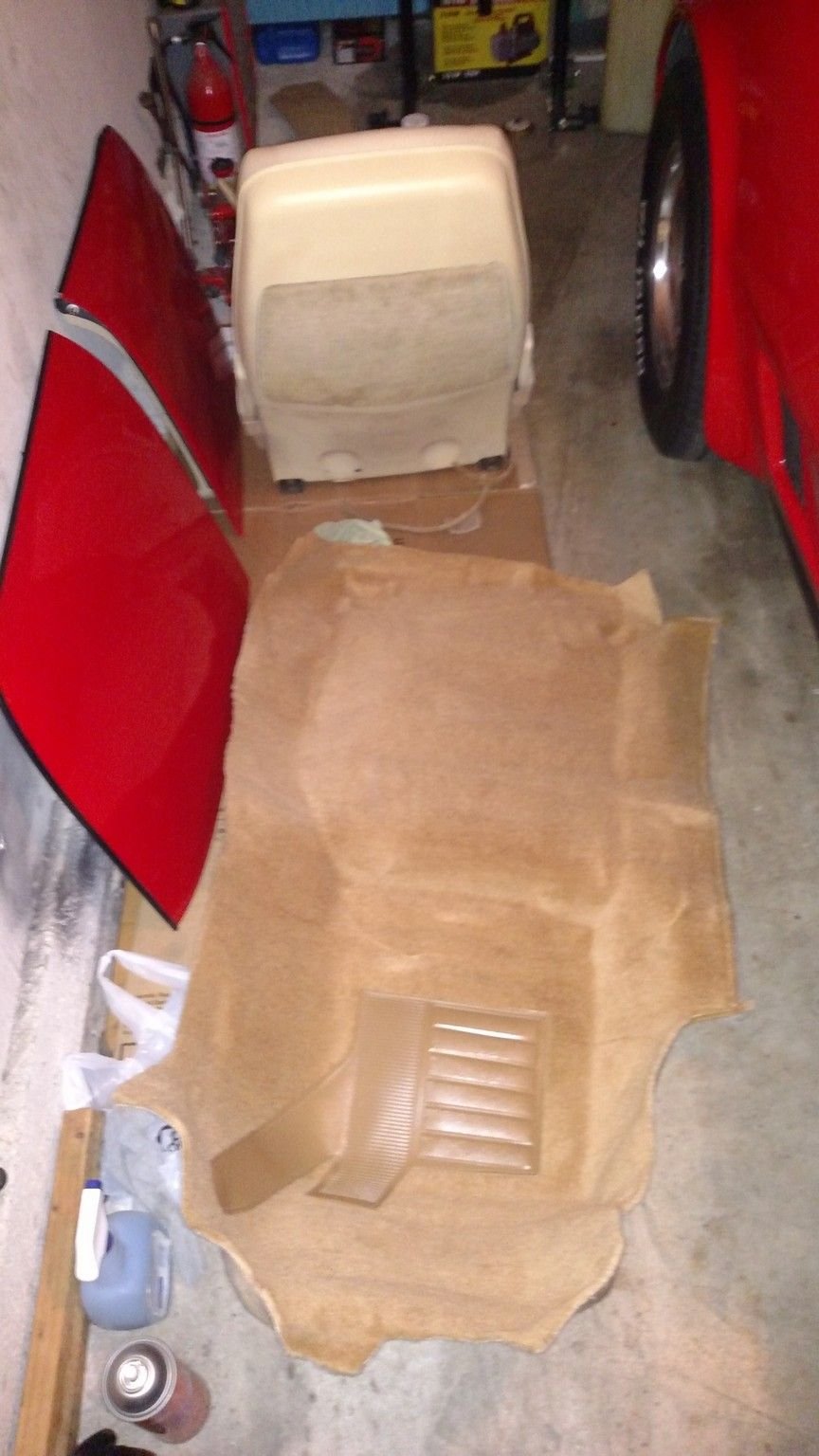

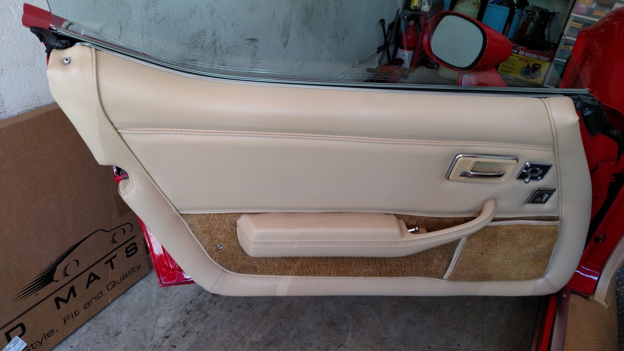

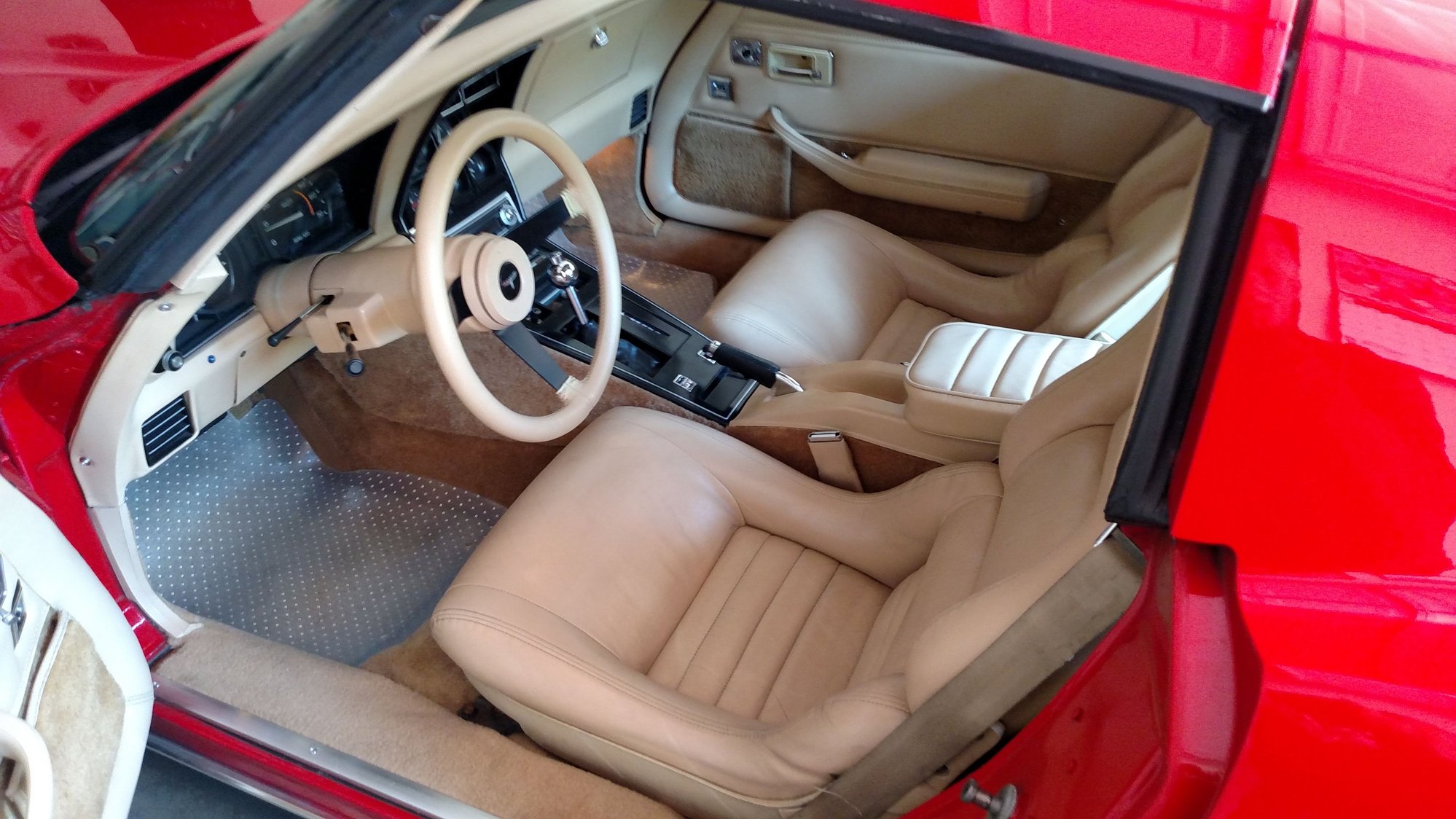

My carpet was a wet, moldy mess that was in pieces. I basically needed a complete interior but I wanted to drive it so I cleaned and dyed what I could and wasn't about to spend good money on carpet to use now and have it worn when I was ready to buy the rest of the interior (will purchase everything as a package) so I made my own carpet set, front and back and did exactly as NONN37 suggested by making templates and transferring it to the carpet. The pic attached shows how it looks. To stop the edges from fraying I purchased stick on carpet edging available at most hardware stores. I have since added carpet to the door panels. It still looks good after a year of service. Cost? Under $100, front and back.

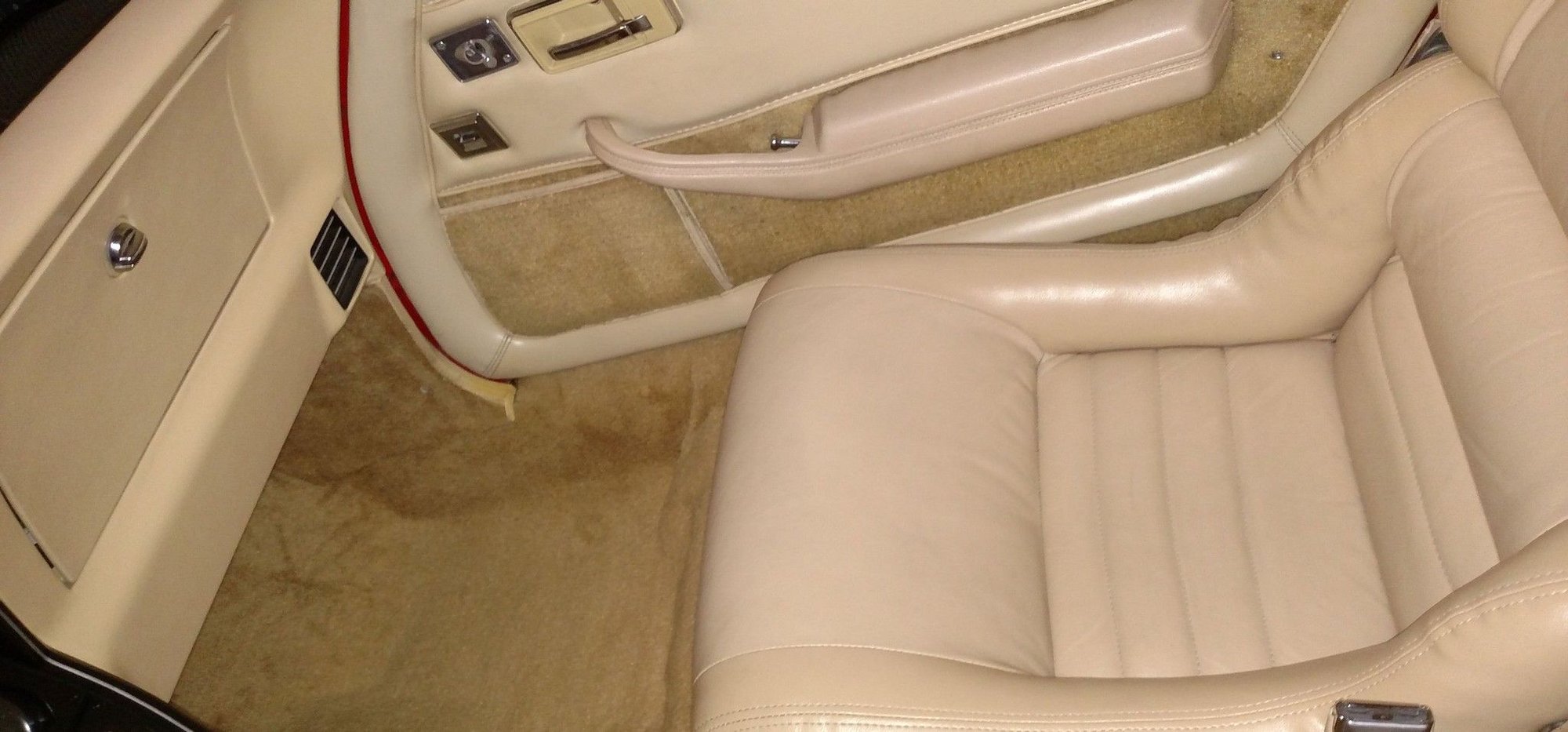

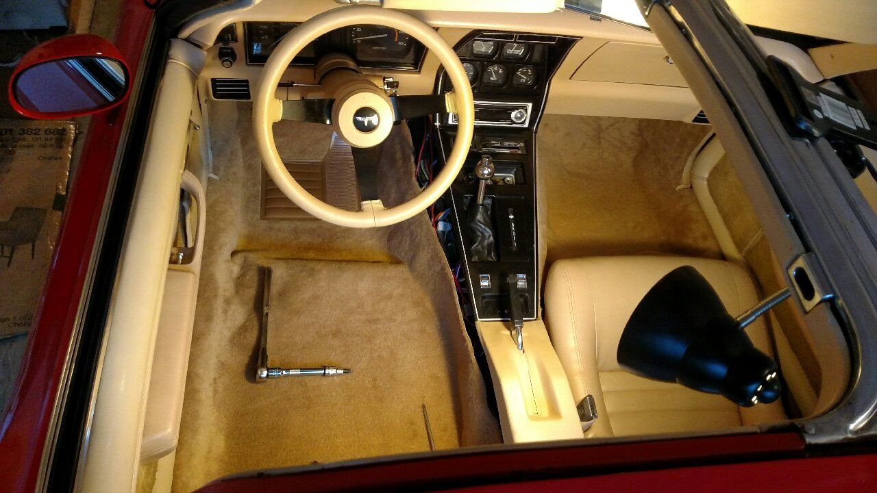

I just did mine over the weekend. Start from the Door Sill and work your way in. Take Your Time
I also re-dyed the Door panels , Center console emergency brake cover & Steering wheel.

Thanks for the photos Douglas.
That install is very nice and clean.

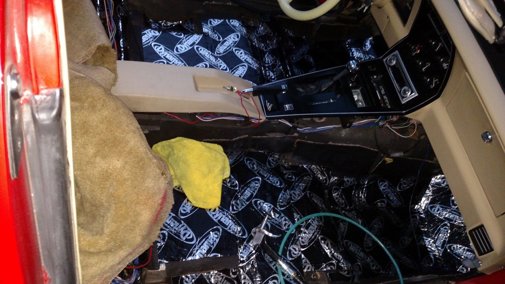

I redid my 76 including pulling the dash, fixing the duct work, replacing the heater core, evap core, vacuum hoses to heater control, heater control, bulbs, taping the duct work so air won't leak from it,replaced all interior panels, including the rear, put in removable rear window, all carpet with be cool insulation, painting the console top, repairing the ash tray slides. Had fun doing it, would consider doing it for hire if someone in my area needed it done.

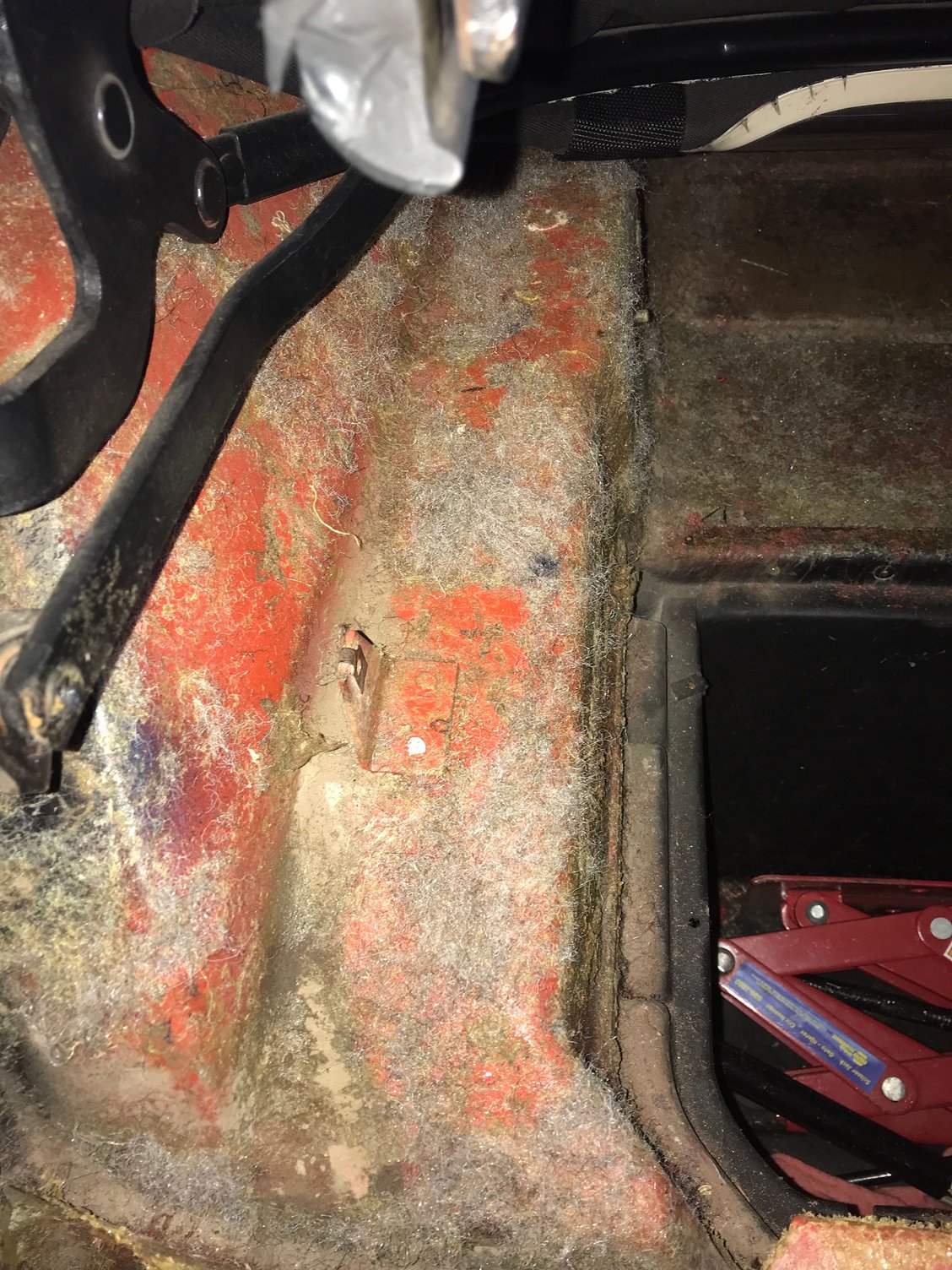

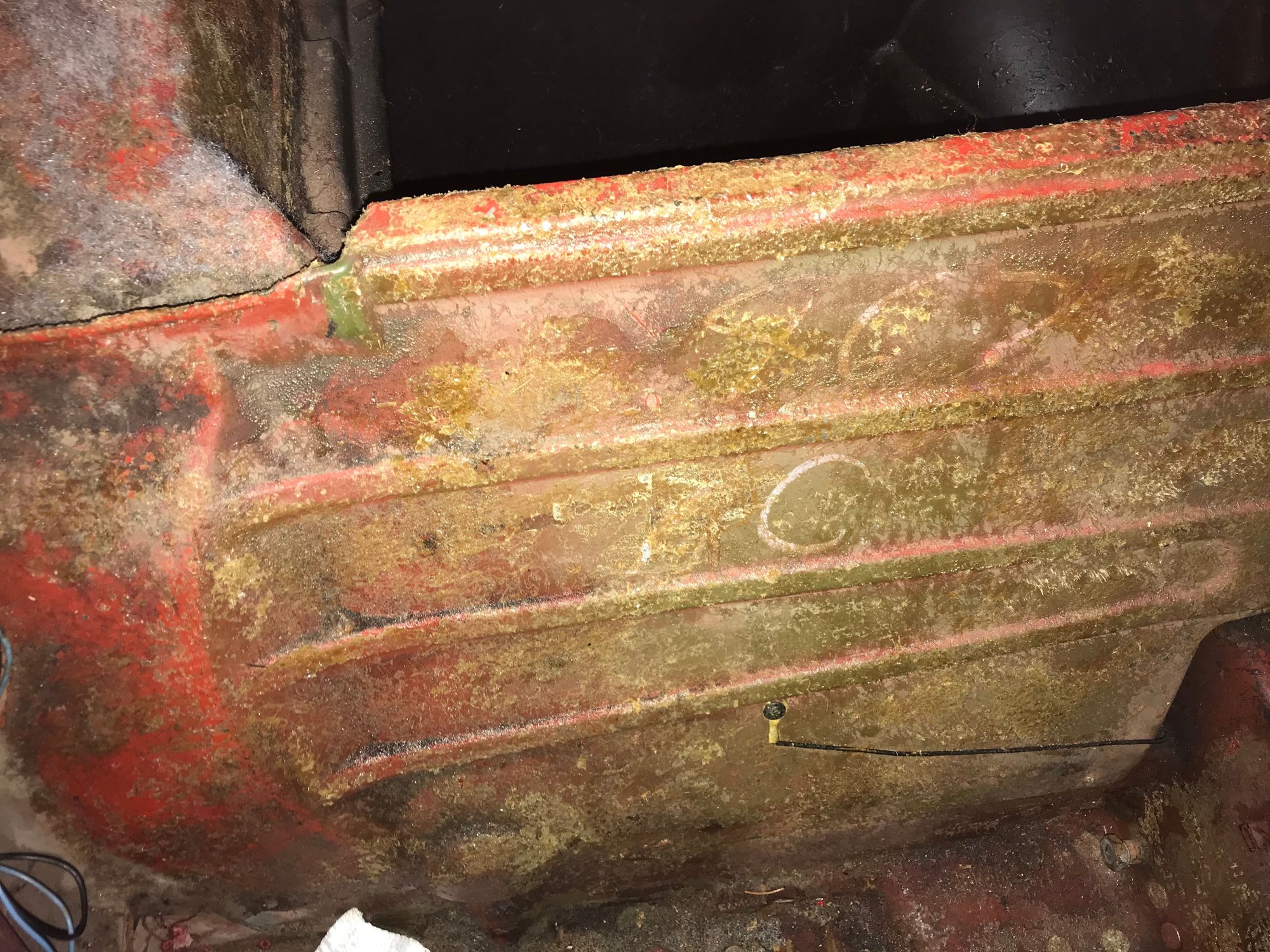

Pulled the carpet and felt...looks like I have my work cut out for me. My best guess is that whoever did the last carpet job used way too much adhesive and didn't do a good job in surface prep...probably glued over most of the old glue.
I tried mineral spirits and krud cutter with poor results. Any suggestions for chemical cleaners (Goo Off is not recommended for fiberglass surfaces).
