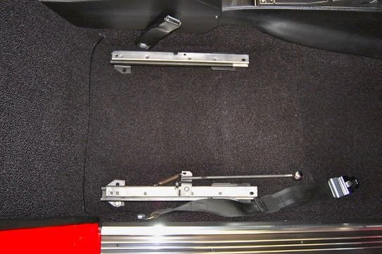

From a 72 and the seatbelt retract covers are not likely on yours but you can see where the bolts are for the tracks.
On the back there are holes on both sides of the track, maybe your looking on the wrong side?
You can see the back bolt on the outside of the outside track, right at the bottom of that pic

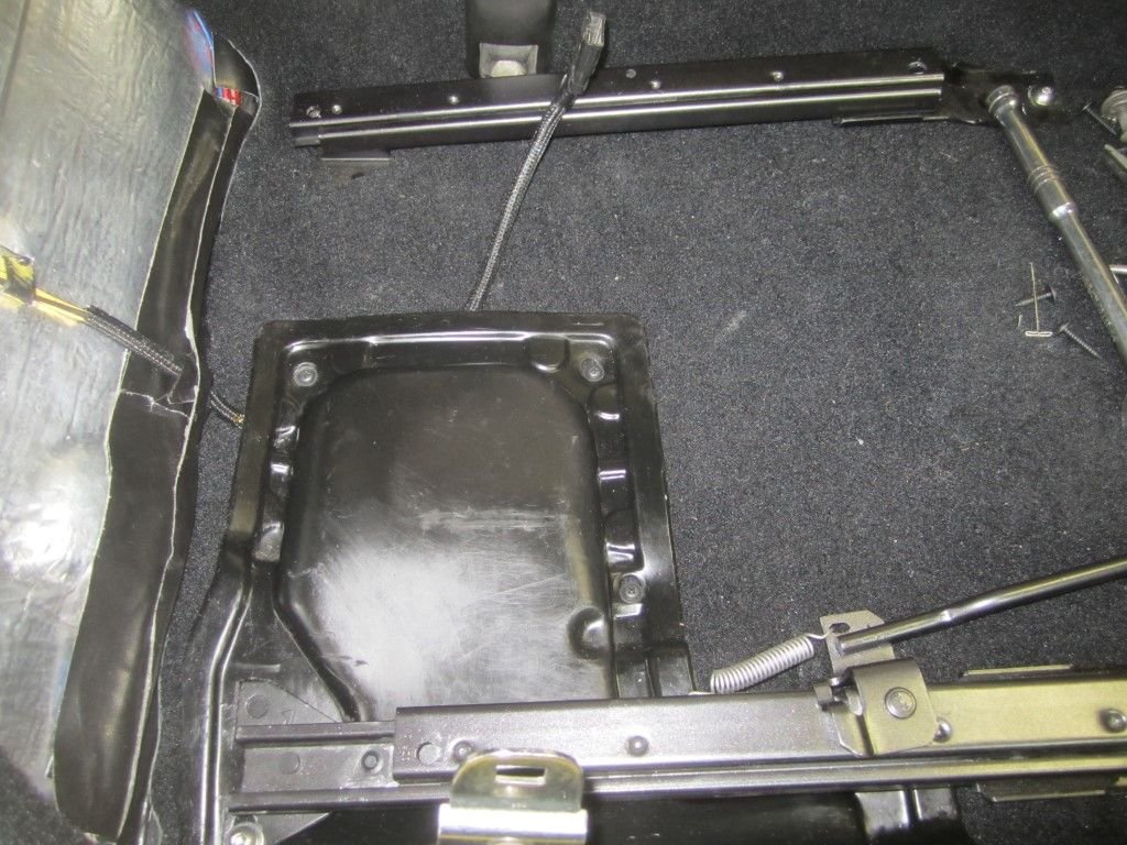

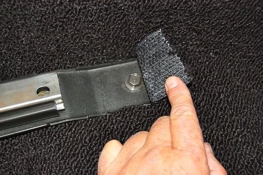

Hi MF,
Here's the typical location for the rear mounting bolt on the seat track.
Regards,
Alan
Rear bolt on each track. The bolt remains visible.
Front bolt on each track. Bolt and track are covered by carpet flap.
The rear track bolts mount in these threaded plates.
This happens to be the plate for the track near the transmission tunnel.

thanks for the pictures - that helps a lot. I can now see the rear bolts...and even get a finger tip on them. But how in the H do you get them out? There is no way I can fit a socket or a wrench down in there. You guys both showed pictures of the rails without seats, would I be best off to try and remove the seat from the rail and then be able to get the rails out easier?
Old Feb 17, 2018 | 10:13 PM
Mooser's Avatar
Mooser
Joined: Apr 2011
Posts: 11,183
Likes: 3,335
You'll never get the seats off the rails in the car, I don't believe it's possible.
I was using just the tracks to work out the carpet and seatbelt cover locations as well as some other items, much easier than working around the entire seat.
Alan... well Alan has pictures of virtually everything in every conceivable state of assembly/disassembly whether it happened or not. Puts Bubbas like me to shame
Sounds like the seat isn't going all the way forward, you may have to shoot some penetrant into the tracks and move them back and forth a bunch to get them to go far enough ahead (and even then it's just enough to get at the bolts)

Again, 72 but your's should be the same minus that plastic cover
M
Holy Crap!!! This. Is. What. I. Needed. My seat doesn't go anywhere near that far. Thanks a bunch. I have some work to do.

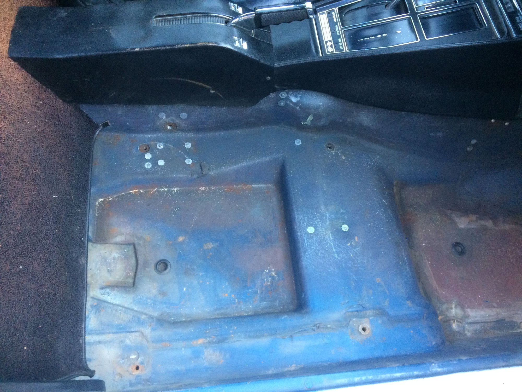

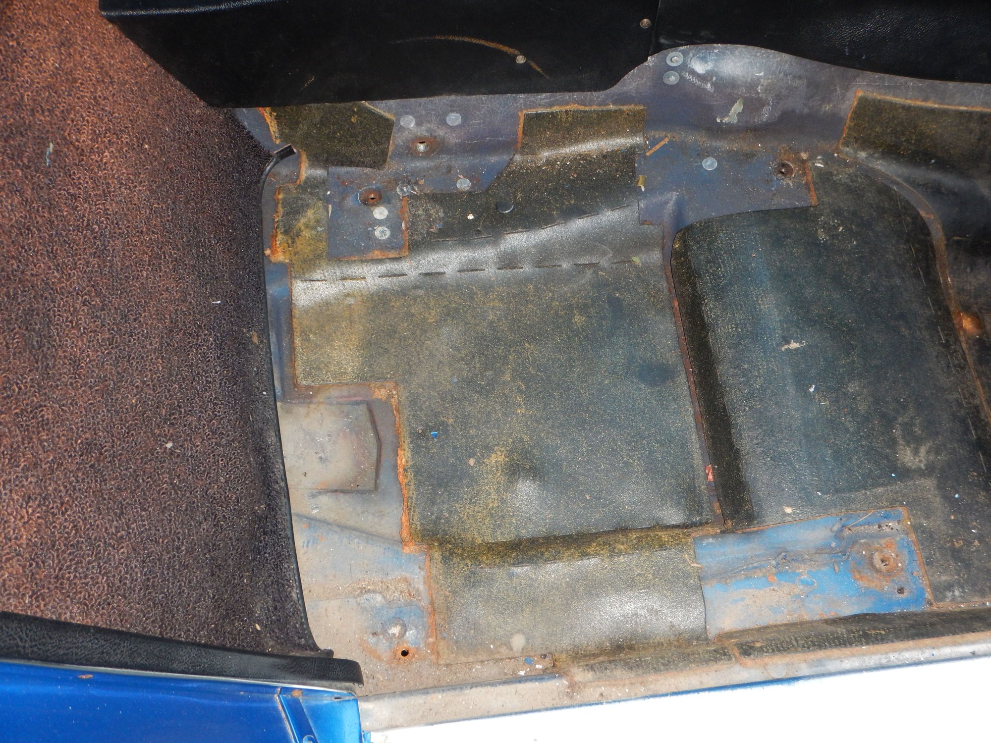

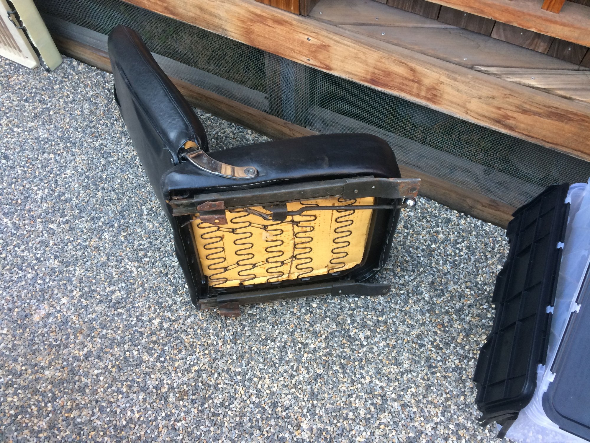

couple of 1970 seat bolt locations: Removal is east just don't overdo anything.
