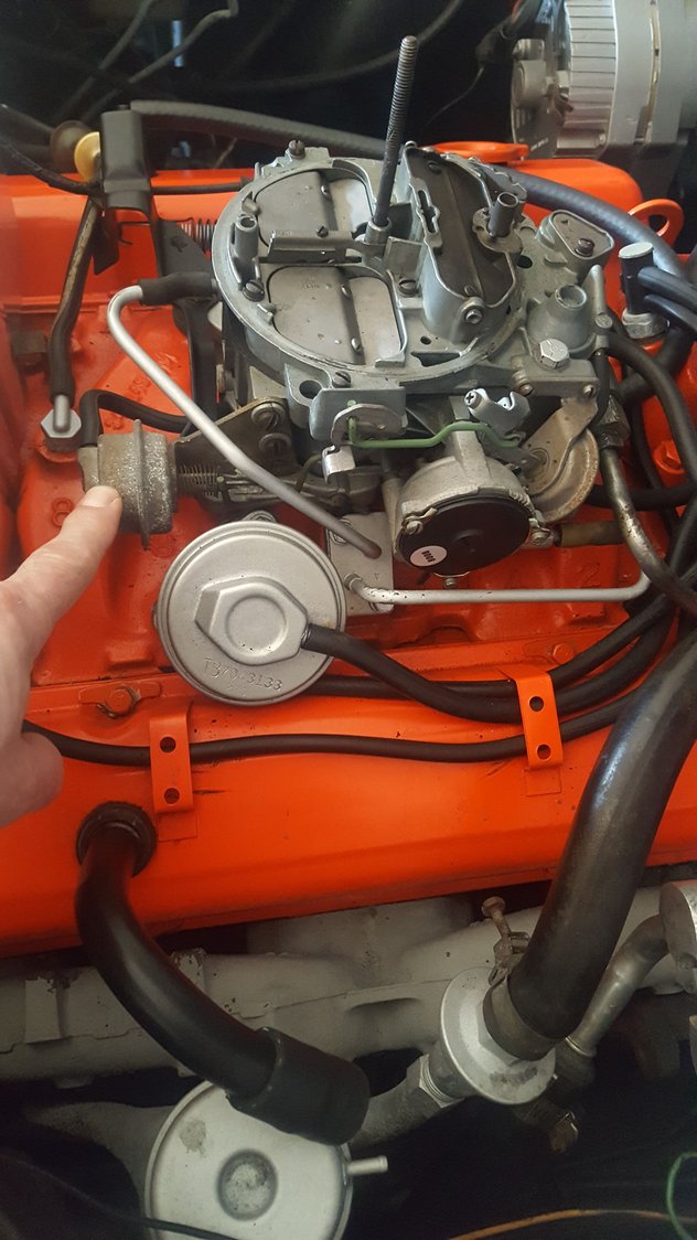

Is the hot air housing what I am pointing to? If so I should unscrew from carb?
NO, the round black plastic piece with the little white round sticker on it. 3 screws.
