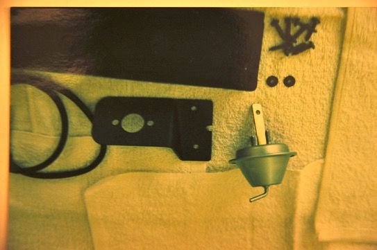

Hi H,
Normally rotating the right side temperature wheel on the heater/defroster controller to 'C' sends a vacuum signal to the small 'pod' which closes the Astro 'flappers' at the rear deck.
The pod is mounted to a small bracket that's part of the Astro frame with 2 nuts on studs that are part of the pod.
Removing the 2 nuts allows the pod to be removed and then a small piece of tape will be able to hold the flappers in the closed position.
You might check the condition of the foam rubber seals while you're there, but just taping the flapper closed should give you the seal you're looking for.
Regards,
Alan
Here you can see the little pod, bracket, and nuts, that you can remove if you wish to.
The longer screws mount the flapper frame to the plenums.
