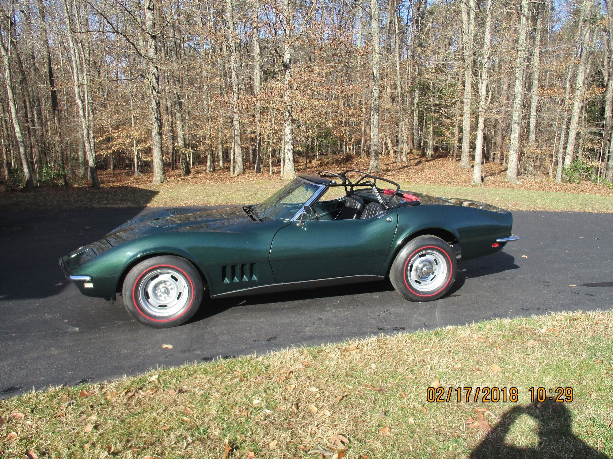

I am finally finishing up the restoration of my 68 convertible. Had the top frame refurbished and have it mounted on the car. New roof rail and front bow weatherstrip installed and door glass and top frame aligned so that everything fits like it should. I have new pads, straps, and tension cables but they are not installed. They guy that I was planning to do the top installation wants me to remove the frame. He says that he will install the top on the frame without it being on the car, and then reinstall the frame. This installer has a lot of upholstery/top experience and does very nice work, including interior work for me on another car. I've questioned him some about how he would get the top on the frame properly without it being fitted to the car, but have not really tried to pin him down. Is it reasonable to expect that the top can the top be installed on the frame with the frame off the car and then reinstalled on the car and have everything fit and lineup as it should.
