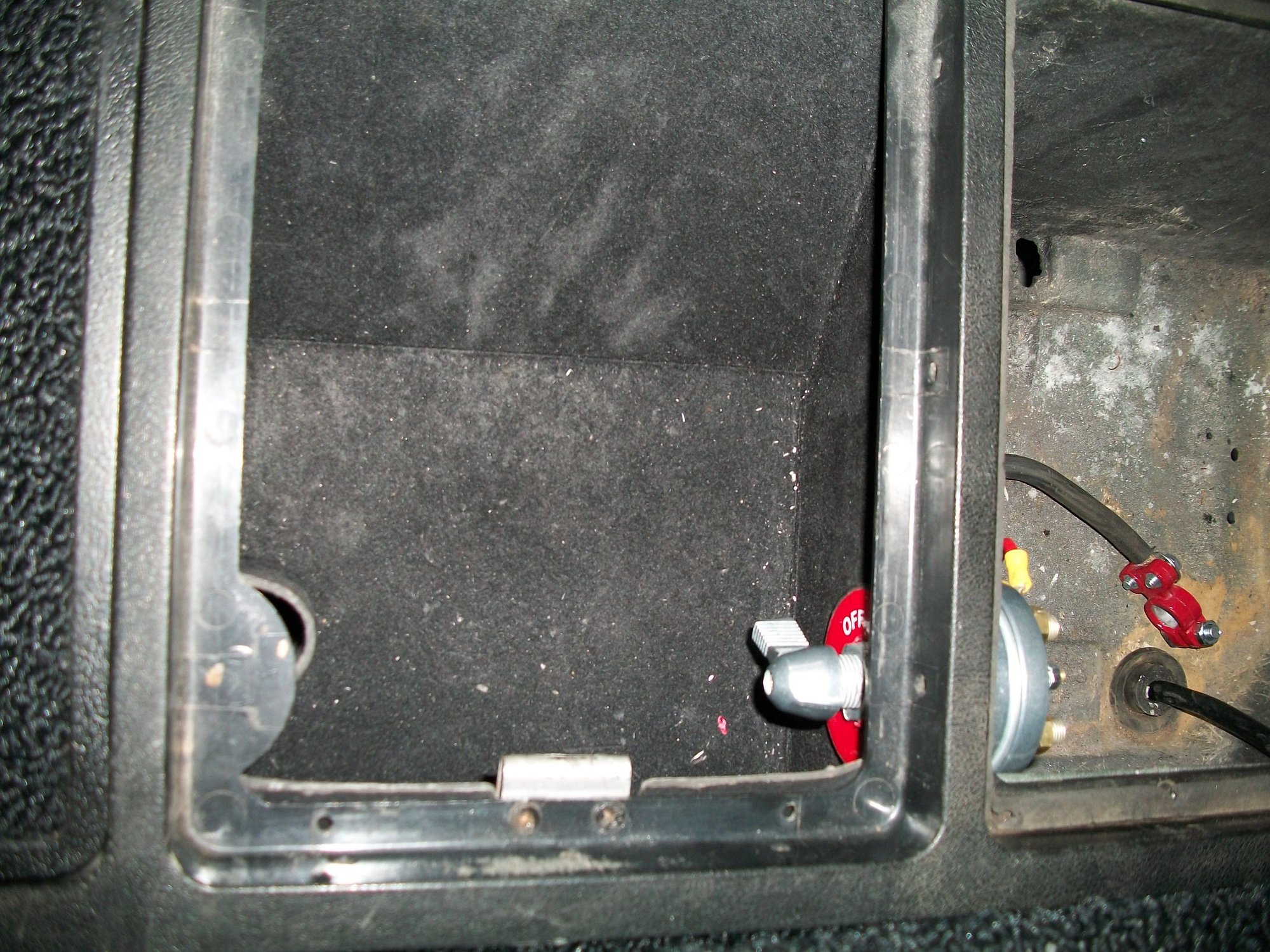

I installed a battery switch, (more to keep from draining the battery while it sits, than for theft). I put it in the battery compartment, with the switch handle in the glovebox.
