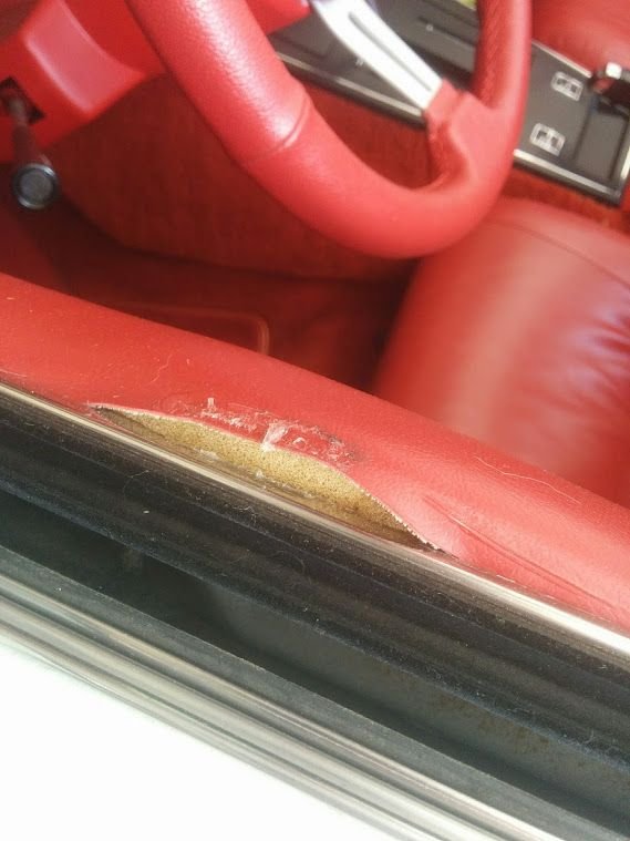

My dad had the interior redone in Tue 90s to red with Corvette America door panels, I believe. They are defiantly not OEM. Anyway, on the driver side top the vinyl has popped out of the trim strip as you can see from the pics. I have tried several different adhesives and used painters tape to hold the vinyl in place while they cured, but it continues to pull out. What is the best way to fix this other than buying a new panel?
Thanks!

I was finally able to get these uploaded direct to the forum.

i would think you will need a new panel, maybe you can take it to a shop and they can fix it
agreed maybe two to keep a match

Hi MP,
If you decide to replace the panel the one that's there is going to have to come off.
SO, I'd give repairing the damaged panel a try first.
When the panel is off the door you'll be able to remove the 'inner seal' (the whisker strip).
When that's off you may have better success in pulling the vinyl back in place and getting it secured UNDER the strip....when you replace the strip.
I think the the chance of success depends on if the vinyl has in fact 'slipped', or if it has actually ripped.
Maybe?

Originally Posted by Alan 71
...I think the the chance of success depends on if the vinyl has in fact 'slipped', or if it has actually ripped...
I agree. It could be a rip.

It looks like the foam underneath swelled-expanded and split the vinyl. Maybe separate seam from top of panel and sand-file-scrape the foam down and see it it'll reattach. But obviously not until you are ready to pull the trigger on a replacement.

You can not glue to that soft open cell foam....will not work. You could remove skin and add a scrap piece of vinyl to lengthen ( hiding the sew line under the window trim ) then glue the scrap to the hard board. That would be the cheapest.

I would remove the door panel and take it to an automotive upholstery shop. They will, most likely, steam a good portion of the vinyl upper panel and reattach it to the panel with contact cement and staples. If need be, they can trim the padding. I had this done on my 68 and it lasted for about 20 years. Jerry

Looks like a tear. In the upper left you can just make out that the vinyl has split with part of the vinyl still remaining attached to the chrome. If true the only hope is to disassemble it and try to add a reinforcing piece below. But being in a high stress area, I doubt the repair would last. If time is on your side (more than money), if it were me, I would try to repair it and see what happens. Ike

Thanks all! I like the idea or disassembly and adding another piece of vinyl and try to attach it back some how. Like mentioned, replacing one door would probably mean replacing both unfortunately so I'm going to try anything to get this back in.

It looks like it pulled out from under the trim/weatherstrip. Take the panel off and see if you can remove the trim and pull the material back under it. Try it before you get a panel.

My eyes see a tear , I honestly don't think you can fix it .
I have gotten door panels "fixed" by getting an upholsterer to add a whole new full length top section down to either a trim line /or ending with a stitched edge . Yes its not original but with both doors done its still cheaper (than buying matching new ones ) and better looking than it is now .

I agree that it is a tear. Probably caused by the sun making the top edge of the vinyl brittle. Lou.
