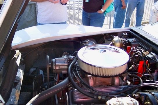

This is a 300 mile 1972 ZR-1.
It appears it has the standard BR-270 coil and doesn't have the T.I. harness running forward to a pulse amplifier.
I'm still thinking no T.I. was available for 72 production.

concerning the radio delete, if you look at the pictures, there is no radio shielding over the distributor or running down the sides, I'm assuming it wasnt removed.
