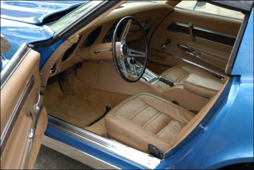

I'm hoping to "upgrade" my interior a bit with a wood rimmed steering wheel, matching shift ****, wood kit for the center dash and console(s) and the addition of the wood door inserts. Several of the usual suspects offer the trim panels alone or as a part of the new door panel package, all say that they're as original to what was available from GM. I've never seen a C3 with these door inserts myself and was wondering if the "teak" was real wood, plastic composite, thick vinyl "contact paper" or worse?
I love what I've seen in the on-line adverts and catalogs, just wondering what I'm getting into. Any help here would be appreciated.

The "replacement" inserts I received were basically melamine (like counter-top or the stuff they glue onto particle board shelves etc. About 1/32~1/16" thick and didn't fit the original chrome inserts worth a damn.
Maybe if you bought the chrome piece with the wood grain already installed they'd match properly.
Here's a link to my journey
https://www.corvetteforum.com/forums...-for-once.html
Like others, ended up making my own wood inserts, used walnut though

70-72 (+?) cars with "Custom Interior" have a walnut wood veneer insert on the console shifter plate and also each door panel.

Thanks VERY much guys, looks like a home made option is the way to go for sure ! I have some nice burl wood veneer and a selection of other interesting woods left over from my Father's estate. I'm not much with saws and such, but I can do it if I'm careful enough I suspect. I saw a "kit" for re-doing al of the dash center, console tops, and such with burl wood that looked nice, but was expensive, could be worth it as the stock "wood grain" console top insert looks like trash, although it would make a terrific pattern for a burl wood veneer insert, wouldn't it? "Easy Mike," when I wrote that I'd never seen a C3 with these inserts, I added "myself." Meaning that I've never seen them in real life, only in pictures like the one that you posted. This was the whole meaning for my posting, as I'd never come across them/saw them in person I wanted to know what was really going on with them. Photographs can makes things look anyway that the advertiser wants them to look, as "Moser's" wonderful thread demonstrated SO very well.
