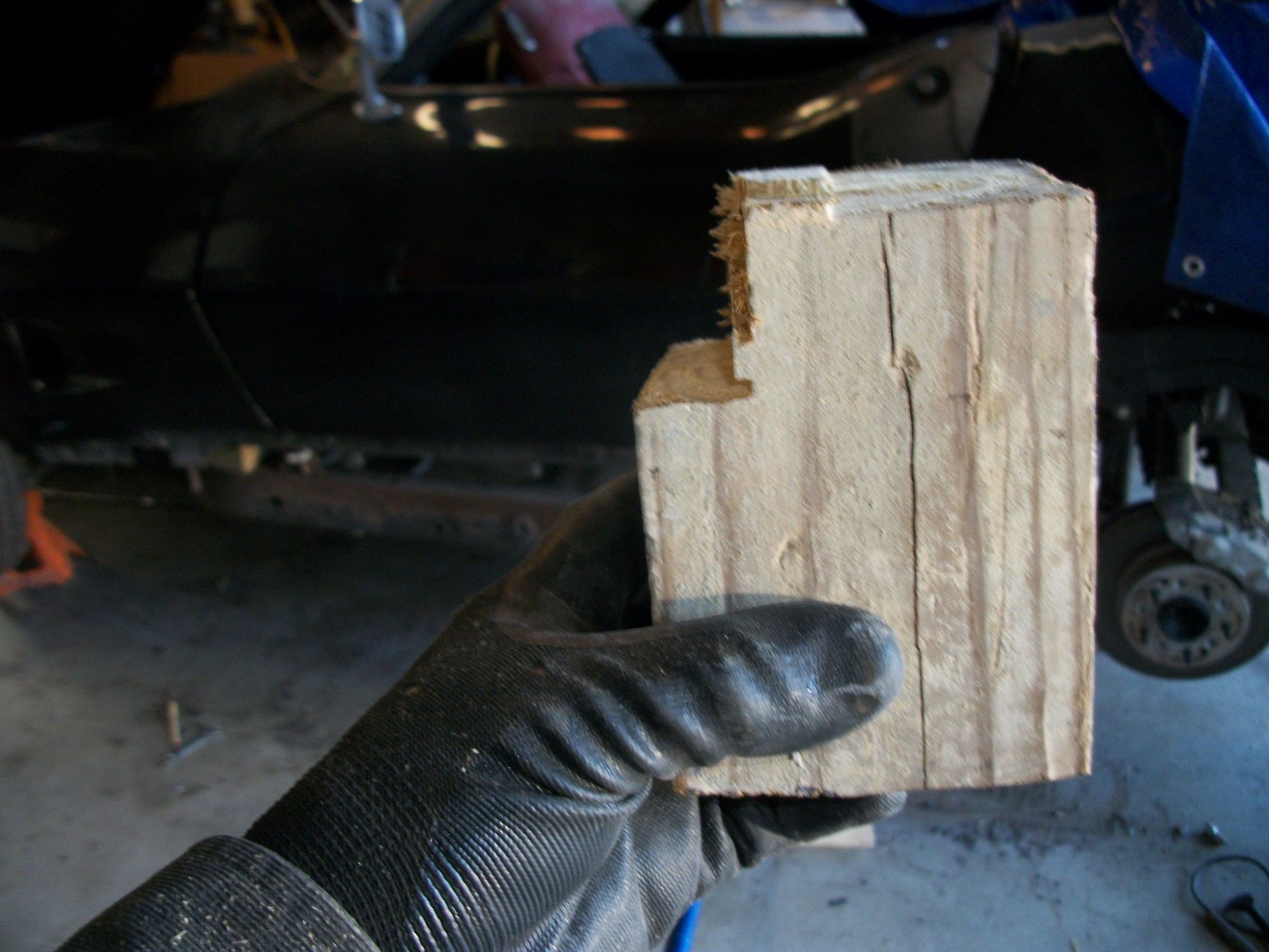

Rookie here: You only need to raise the body 6" or more to replace body mounts. I cut wooden blocks to fit into the body "slot" where it normally would rest on the frame......and supported the nose and tail while lifting in 1" increments to prevent stress cracks. You can go higher if you wish.
