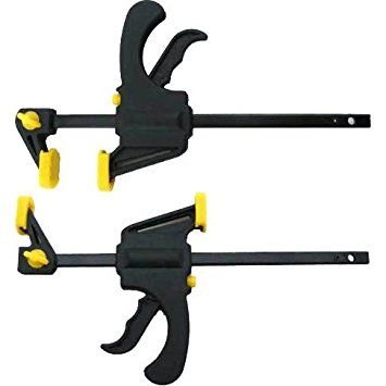

On my old system (before changing to band clamps) I had to use a pair of "push" clamp between the muffler and the tip to get it off without pounding the crap out of it.
Vaguely like these where you can flip the end around and use it to push stuff apart rather than together
or put a piece of wood against the rear of the tip and tap tap tap with a hammer, one side then the other, lather rinse repeat....
