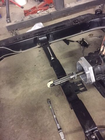

Bob, I have a LS3 crate motor 525 HP version

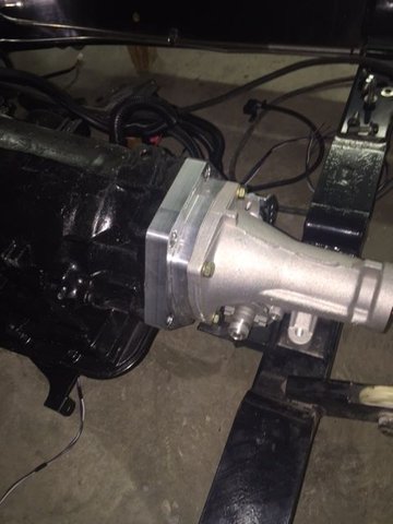

I’m thinking you would have got the trans extension housing of shiftworks did you get their 4 speed shifter as well?
Yes I did get the tailshaft from shiftworks.. no on a 4 speed lol

Room around trans is minimal

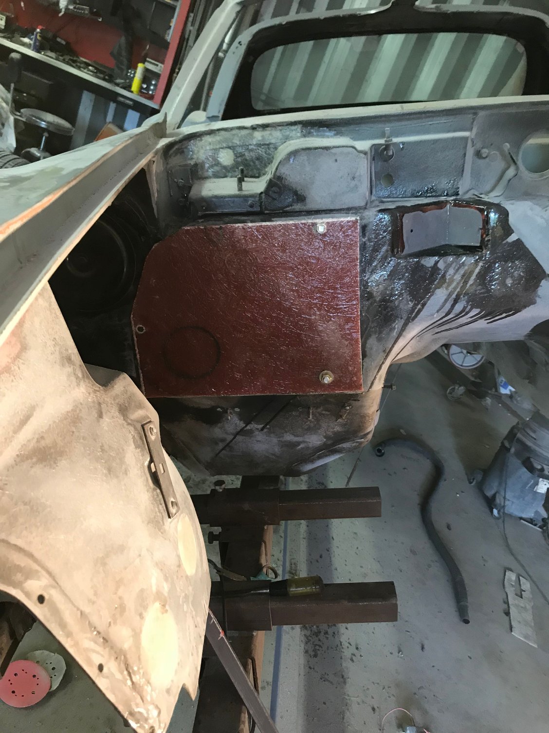

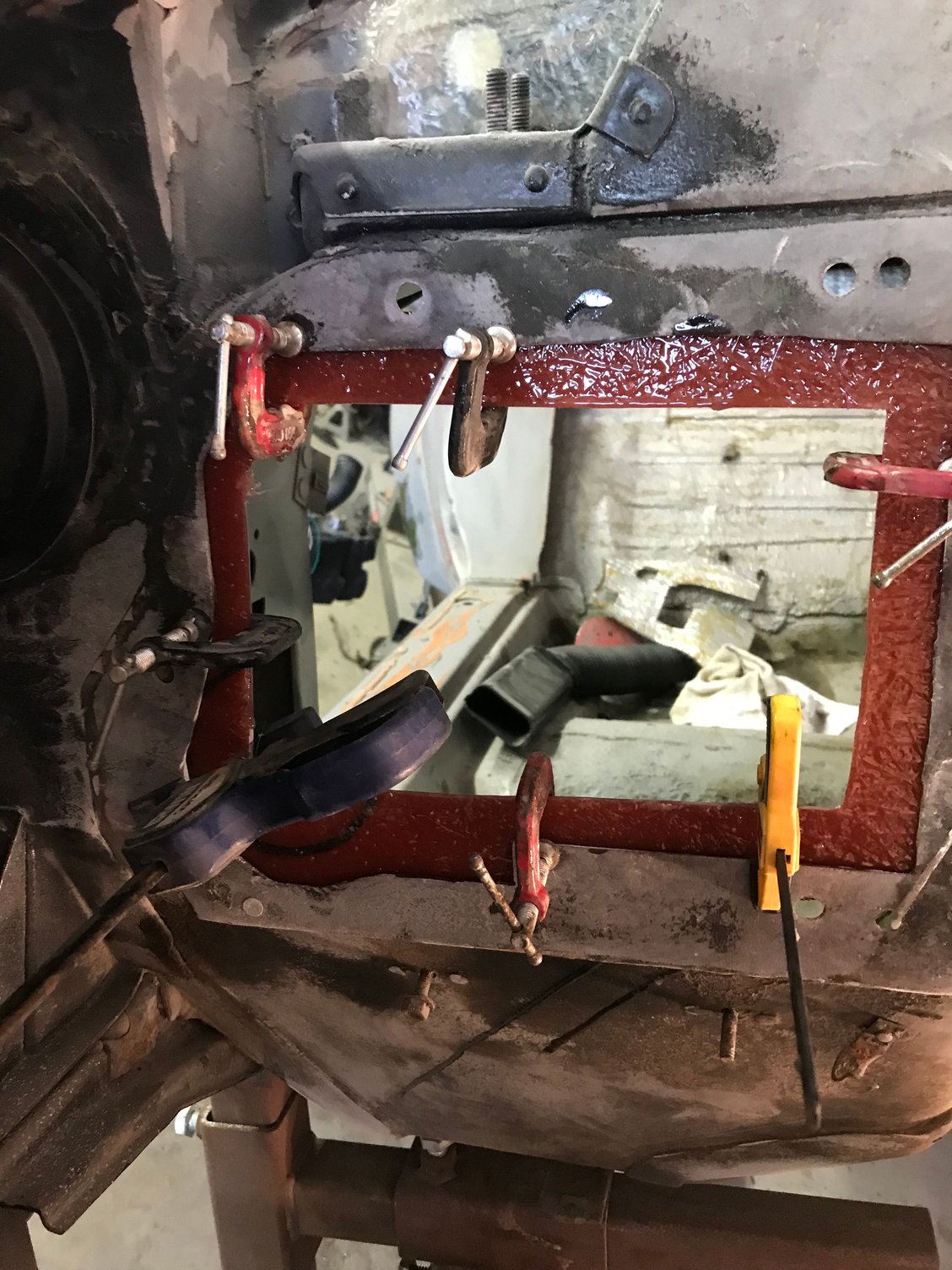

I like the looks of fiberglassing the hole closed. I made a bonding strip and the fill peice. I have bonded the bonding strip once dried I will bond the fill fiberglass. When I started this project I purchased some flat fiberglass.

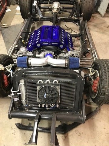

Here ya go. Best routing pics I could find with the pics I already have uploaded. If you need something specific just let me know. Dipstick was a little tricky. I ended up buying a 36" lokar and took apart to shorten it.
I tried to keep the hoses away from the headers so they route with my harness under the ac hoses to the fender area and then along the fender to my cooler up front. You can see it along the right side with the harness and coming out from my fusebox mounting plate on the left.
It's in the background between the air compr. and cai box.
Drilled a few holes and passes through the top of the inner fender the into the front area.

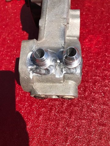

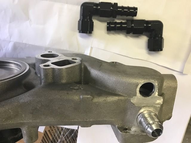

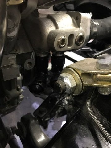

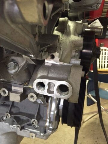

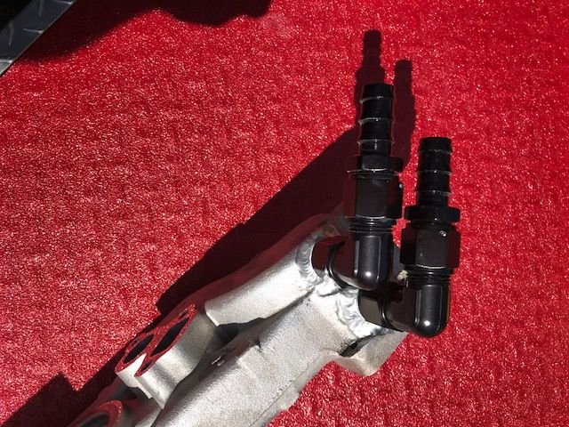

Thought I would share on how I dealt with the heater connections on the water pump. I have see them a few different ways. As most do I removed, tapped and plunged the org connections. I then drilled to match the aluminium bungs and welded them in.. As the material is thin on the water pump This gives you a strong and leak proof connection. It also puts the water coming in and out at the same place as the original.

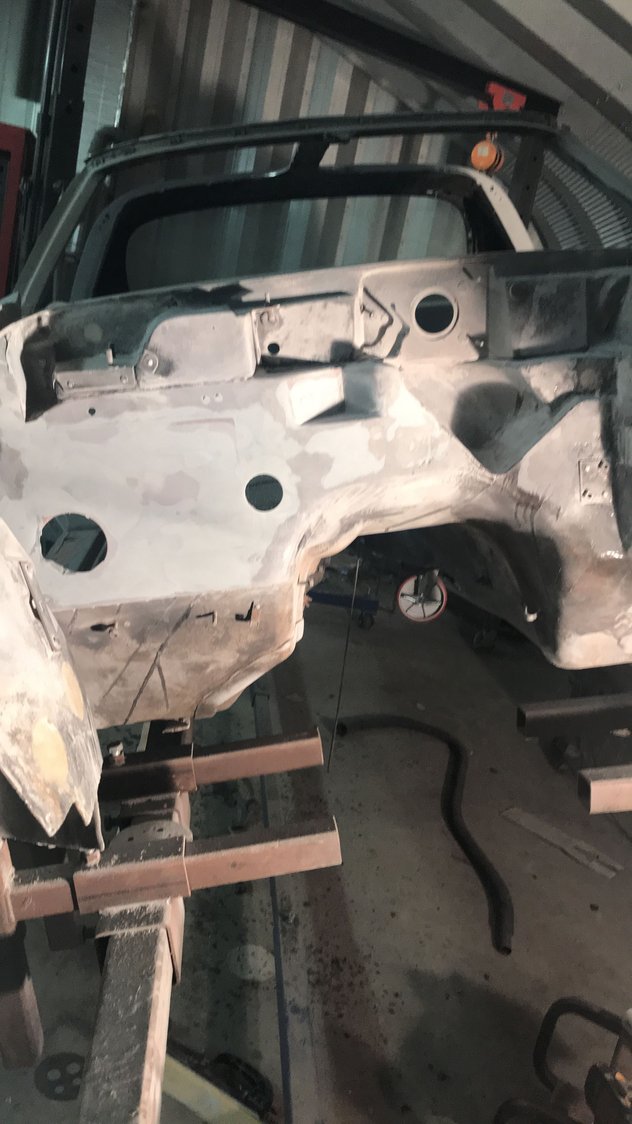

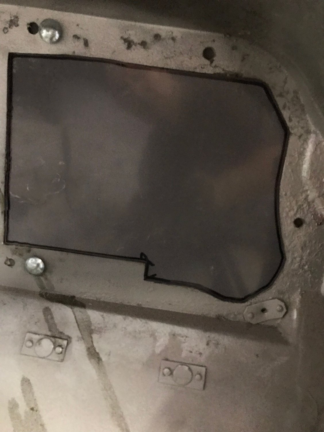

Out working on engine bay, got it fiberglassed, got the ac unit testfited, cut hole for electronics to mount inside.
