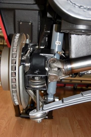

Hi,
Here's another photo showing the angle of the shock mount that M describes and also the angle of the shock itself.
Regards,
Alan
