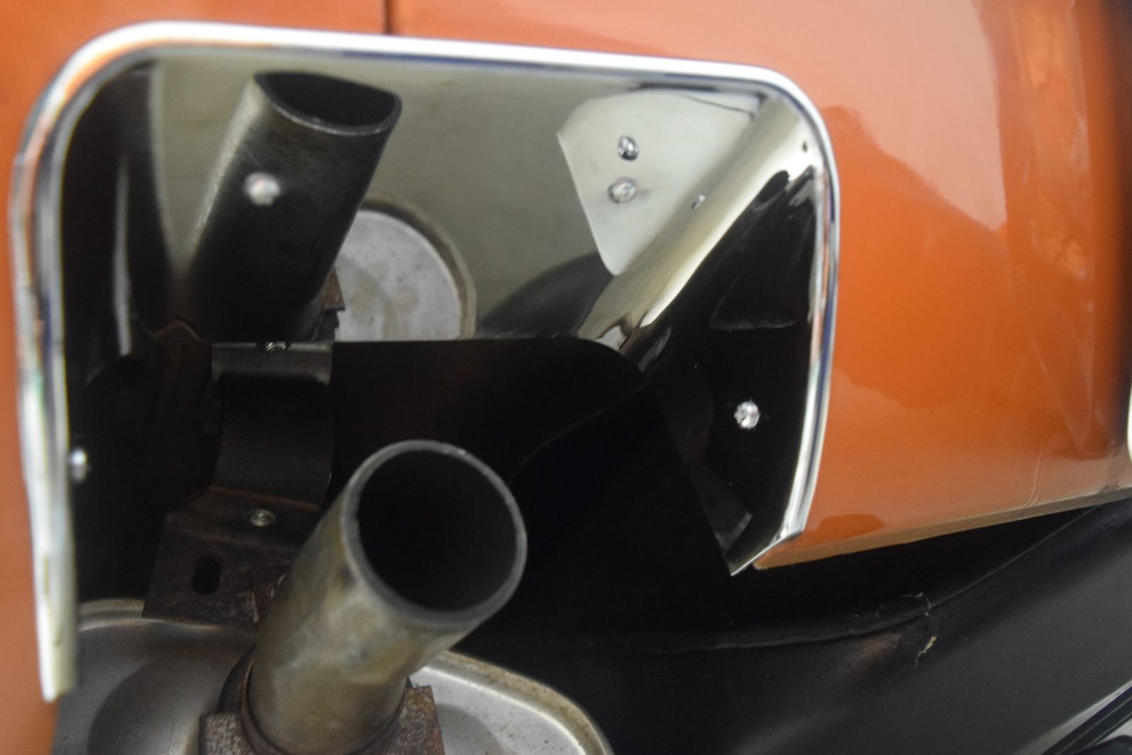

If you really wanted to use those mufflers, you could use the setup the previous Owner setup on mine. Simple bracket mounted to the original mounting holes that come down in the form of a hook that engages a c clamp around the tail pipe of the muffler. Set up works fine. But not original. Let me know if you need a pic of it. Ike.

Here you go, sorry not at the Vette right now so I had to go with what I had pic wise.
So the hanger has a bracket that screws into the frame, the original hanger position, that supports a rubber mount and then come down to a "hook", blocked by the tail pipe int the pic. That "hook" engages the c clamp that is bolted to the tail pipe.
All very neat and well supported. Not the original setup but very difficult to tell unless you really know what to look for and get down onto the ground to see. I think it works fine. Ike

Actually it's not too bad. Thank you for the picture.

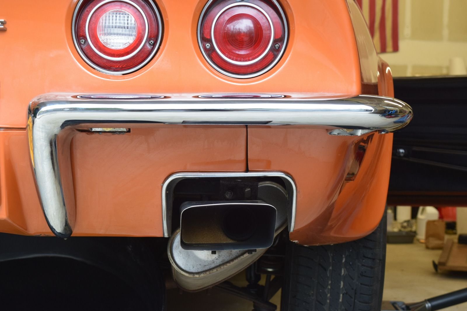

This is how I mounted my Dynomax Super Turbos.
