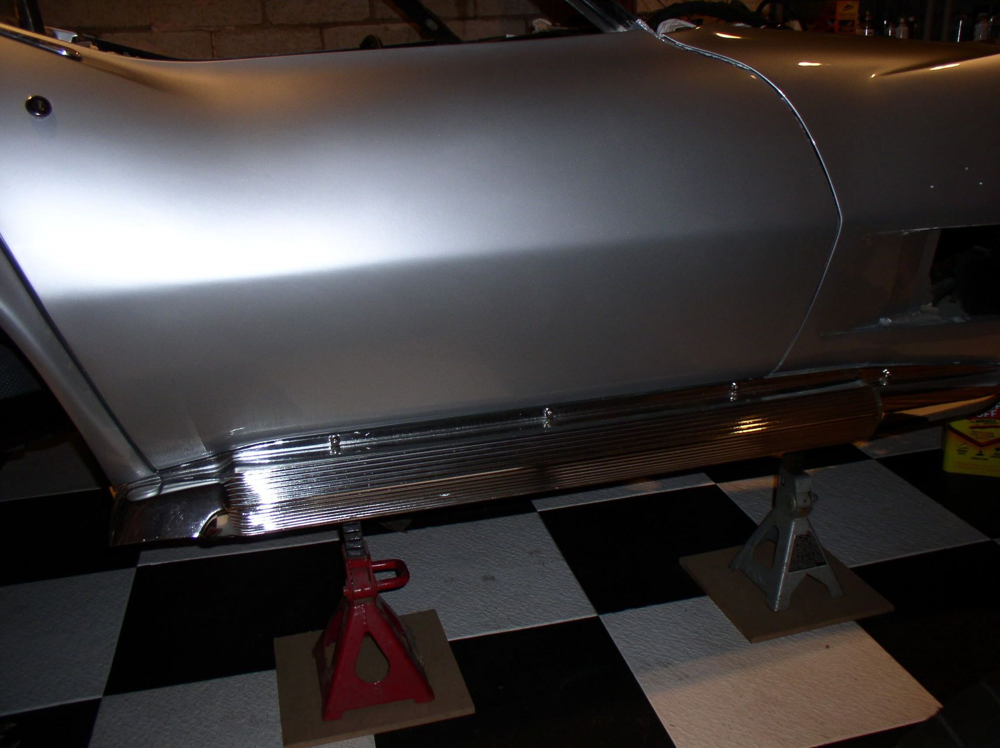

I bought a fiberglass set for $500 off a fellow forum member that had them chromed. I think he had spent $400+ JUST having them chromed and was unhappy with what he had spent for what they looked like....Chrome looks pretty good.
Mounting?

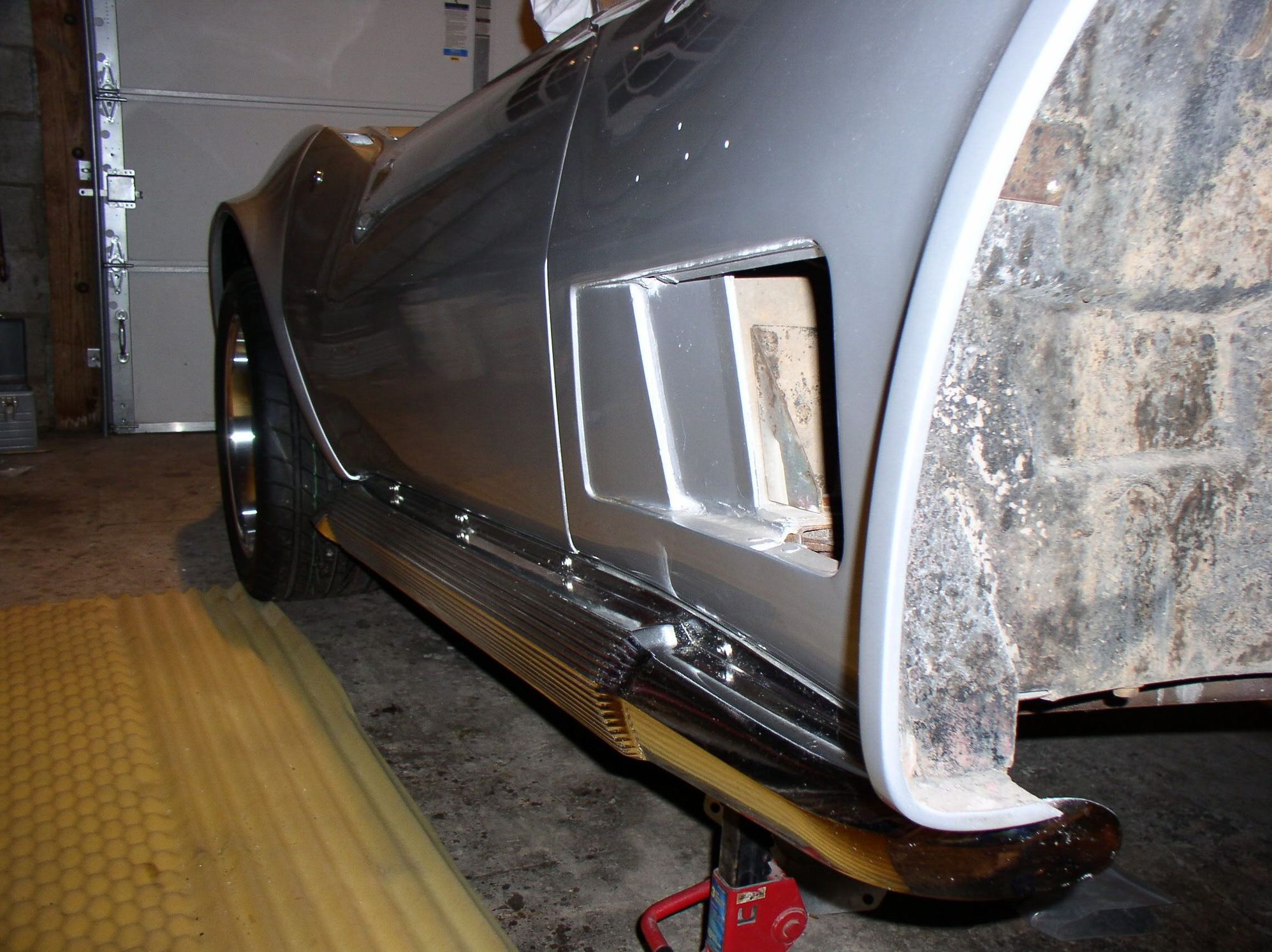

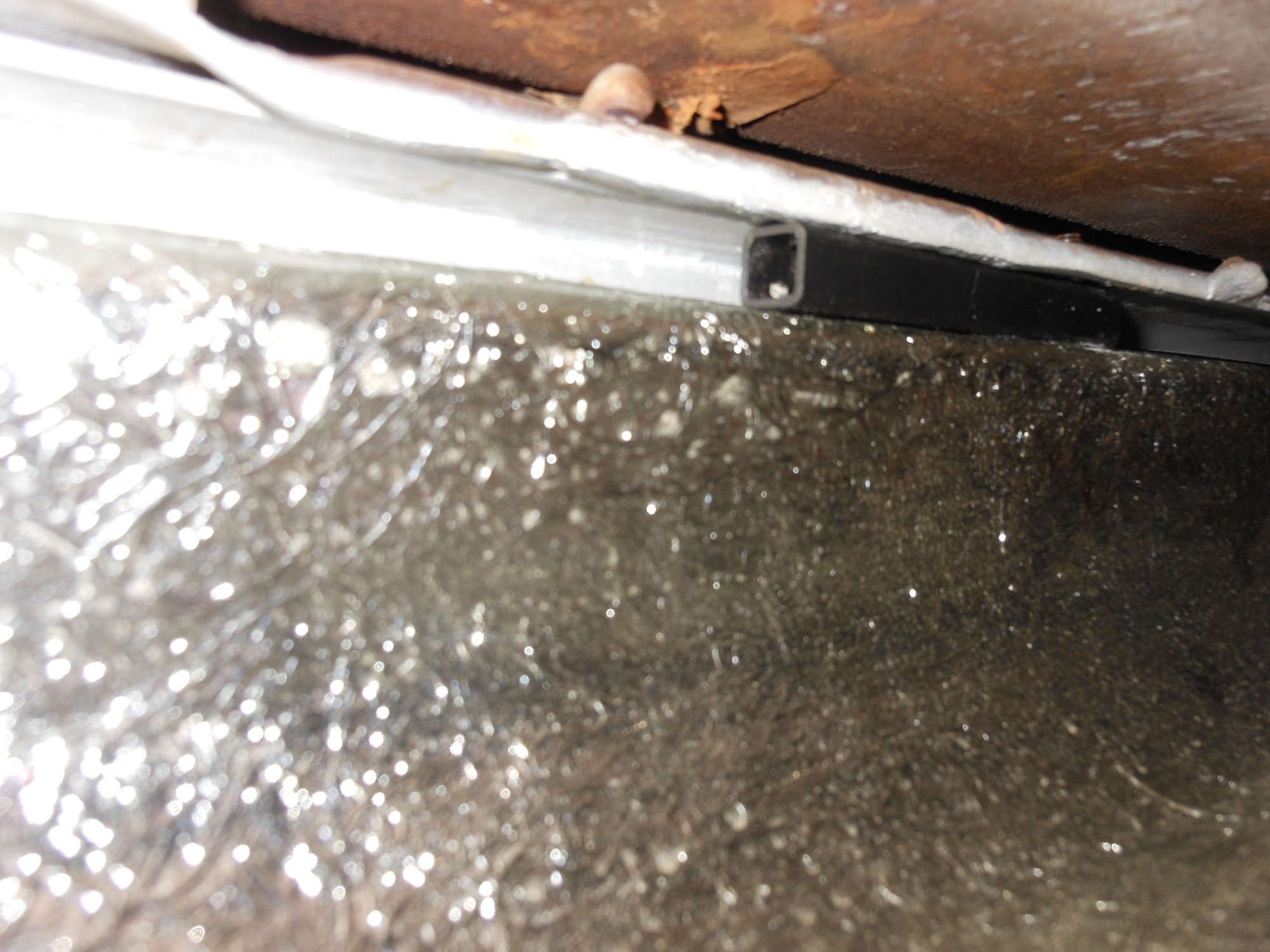

A couple holes didn't line up- but no big deal as I used 1/2 square tube to space the covers out to fit 4" SS pipes underneath.
1/2 spacing-
Fit on the car with no real issues

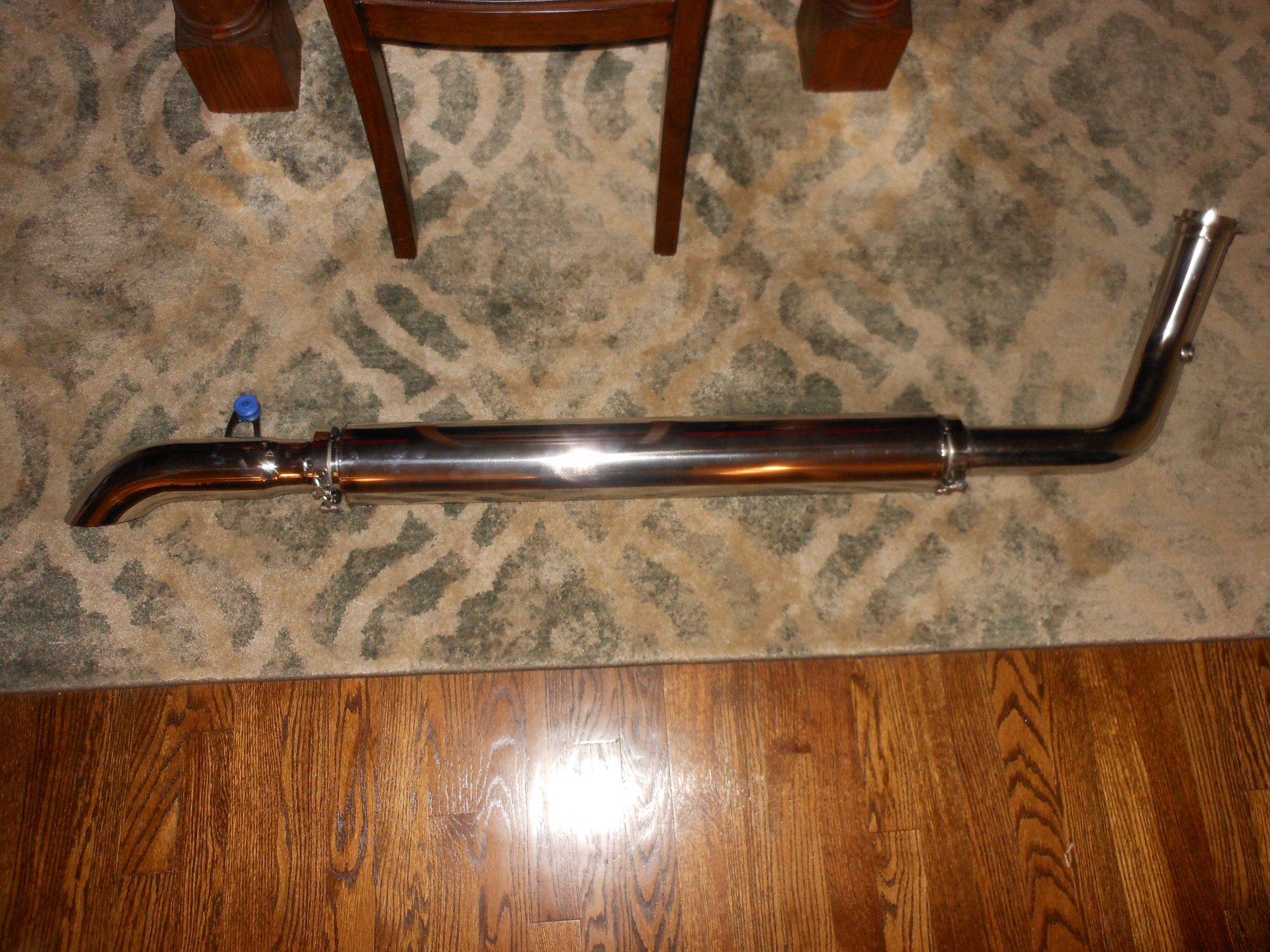

Here's my custom sidepipes- if you haven't priced SS lately- I think going with gold would have just been a little more... Come apart with the v-bands. I have straight pipes with electric cut-outs to run them through an internal glaspac muffler
Here's more on my muffler design-

I got a SS tab w/ mounting bushings off ebay- worked great

It's 2 1/2" with a 3" outlet and a foot long.
Really nice quality for only $25. I welded a V-band to if for easy removal.
