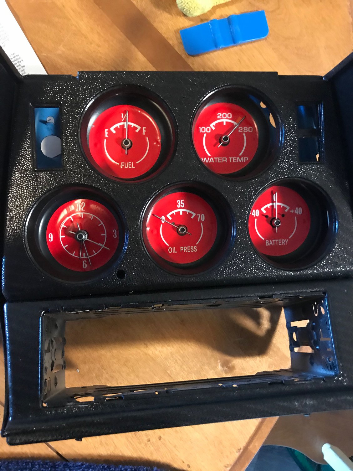

The etire console was chromed, so it was just a case of masking off the trim.
steve

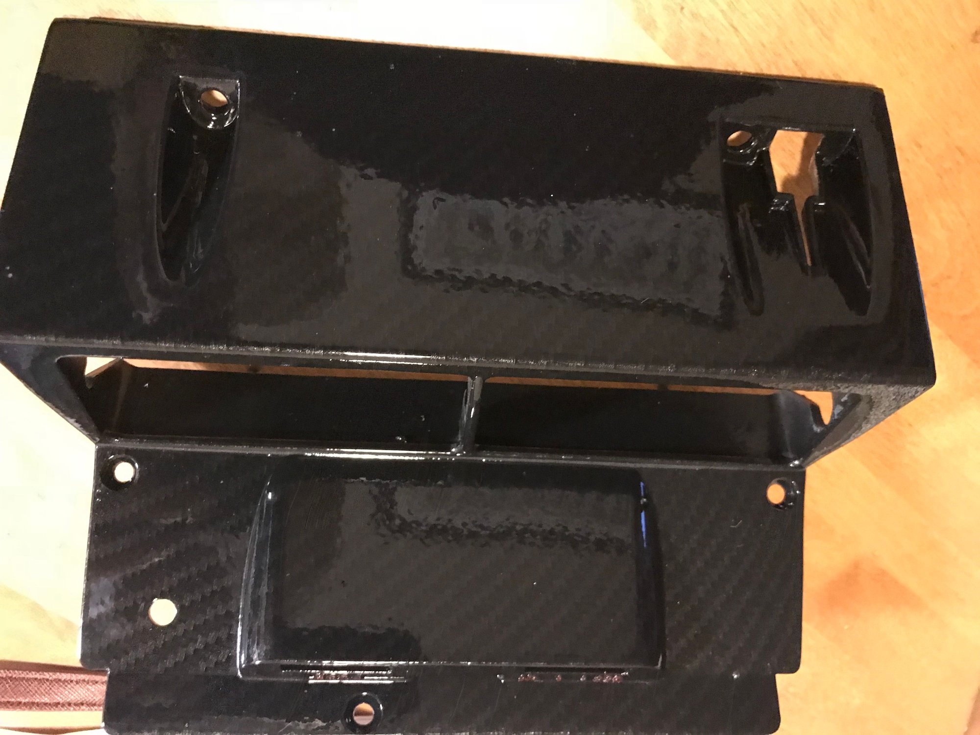

I hydro Dipped mine in carbon fiber. Small customization. Not too expensive.

I have done a couple of these, this is my process..
Chemical strip it.
Spray the entire bezel black.
Spay entire bezel with a matte clear.
Take a knife and scrap the paint from edges that are suppose to be chrome.
If I ever need to touch it up, a black sharpie works well.
On my 73' the exposed chrome on the stock bezel is different from the original poster bezel.
