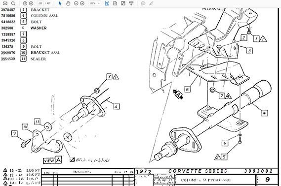

If it's anything like my 72...
Those bolts you're looking at are attached to a bracket and that bracket is attached to anther bracket with 4 bolts that is attached to the firewall/dash
The joint between the two brackets angled and is slotted in both side to side (the lower bracket) and fore/aft (upper bracket)
When you move the lower bracket fore/aft it raises and lowers it somewhat and that in tern raises and lowers the column (left/right doesn't change the height)
Then those two bolts you show are slotted on the column to allow for the fact that the bracket they screw into moved fore/aft
In your AIM is a section on setting it up, here's a screen cap off mine
bracket on firewall (fixed)
lower bracket (movable)
HIH
M

The four bolts (two on each side) that hold the two brackets together are carriage bolts so just loosen the nuts shown and loosen the two bolts for the steering column you showed and in theory you should be able to slide the lower bracket back (away from the firewall) and it should lower the column...
M

The steering column can be adjusted. Also loosening the two nuts in 'VIEW A" in the illustration may be required to take tension off the firewall mounting surface.
try not to get to crazy with it and only adjust it as much as you need...due to you still want to make sure the main steering column shaft is in line with the rag joint ( coupling) .
