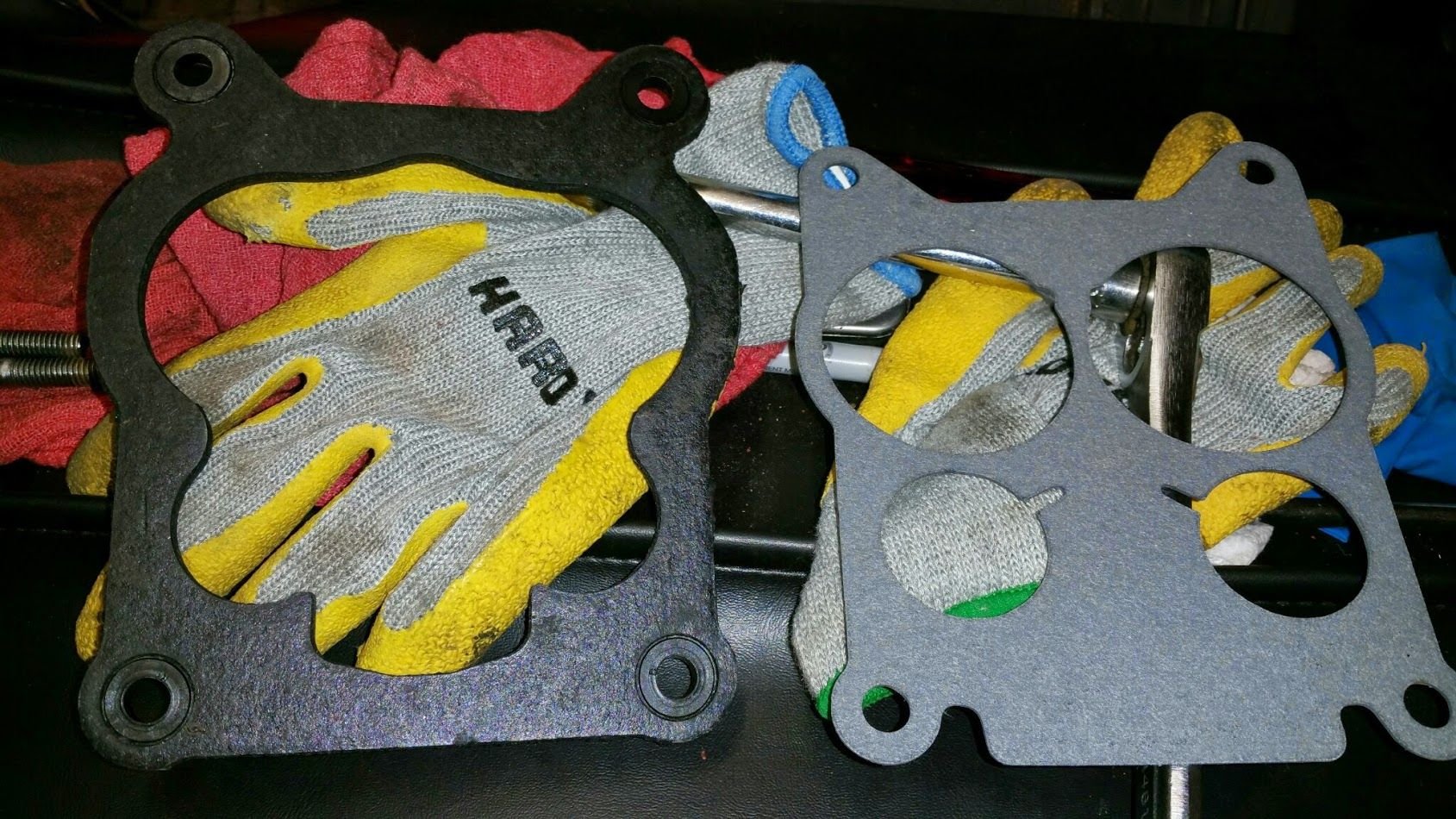

Hello fellow vettors... I've had my '76 in storage for a few years and I'm just now getting back to working on it. I had the carburetor rebuilt several years ago but never installed it. Now I'm at that point but I don't know which gasket to use. These came with the rebuild kit I guess (I didn't rebuilt it, Lars did) but I'm not sure which I'm supposed to use. Any thoughts? Thanks again!

My 76 had the one on the left, when I took my carb. off. I used the new one when I put mine back on.

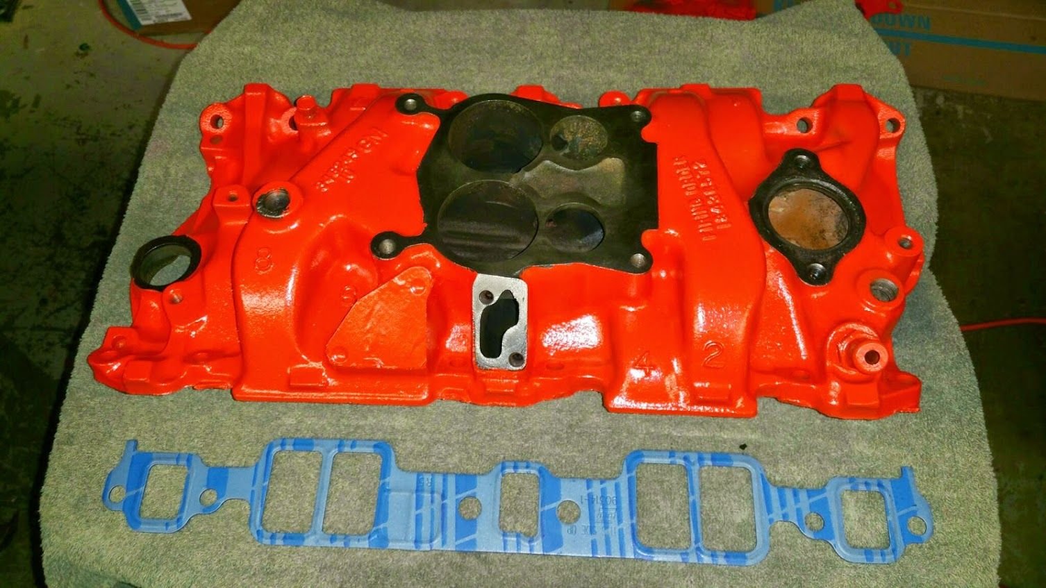

I guess that's my problem. I don't know. I'm guessing on mine it's the one on the right. This is a pic of my intake.

you use the 4 hole gasket for the 4 hole intake

Yup, doing more research I found that the 4 hole is what I need for my intake. Thanks all for the help.

No - don't used the thin 4-hole on a '76. Use the thick, open-plenum gasket for your '76. The gasket on the left in your photo is correct for your application.
Lars
Hi Lars: What effect would running the 4 hole have? Thanks.

It's long been known that a dual plane intake benefits from having some crossover between the two planes - this is the reason for the cut-down divider on performance dual plane manifolds, and the cut-down of the divider on the later-model factory dual plane manifolds. Prior to cutting down the divider, the factory did the same thing by simply installing a 1/4" thick open-plenum gasket under the carb to get the crossover effect. This increases power and torque across the rpm range - compare it to an "H" pipe or "X" pipe in the exhaust. The effect of running the 4-hole gasket to eliminate the crossover is simply a loss of power across the rpm range. If you want to limit power a little, the 4-hole is the way to go...
