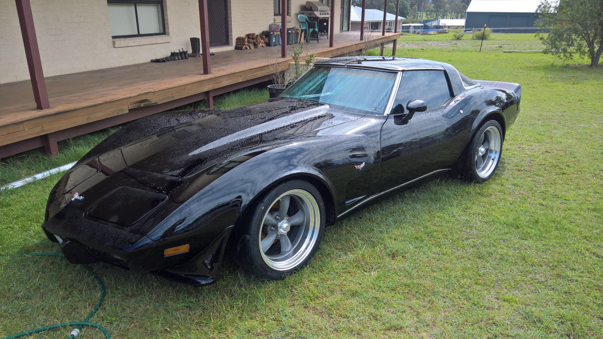

Couldn't agree more, and as I said, totally unbiased.... Love my '79!
