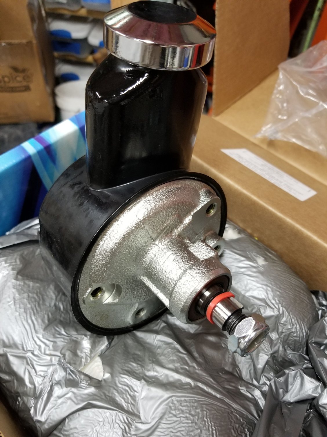

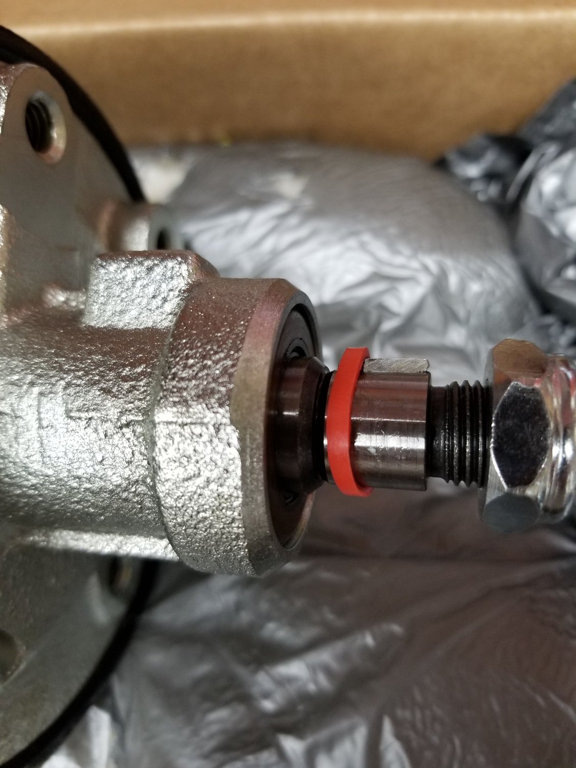

The Tuff Stuff $170 dollar pump from summit
proper vertical low pressure intake
keyed straight shaft
looks sweet
To Power Steering Pump different for BB vs. SB?
looks sweet
Very Nice Piece!

I'm hoping to get it in tomorrow and have a review for you guys this weekend

I put the pulley on and it just slide right on. Its installed awaiting lines. If they dont show by lunch tomorrow it will be installed with the old lines and a new filter. The old lines werent removed and they are only 2 years old. No big deal
