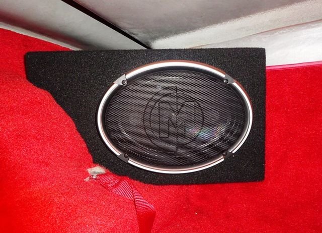

I have them in my '77. Can't comment on the install particulars, I supplied them to a pro shop and they did the install.

These take up no room. Plenty of space for t-tops stacked in a case.
